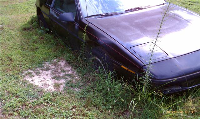

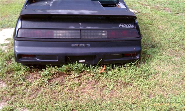

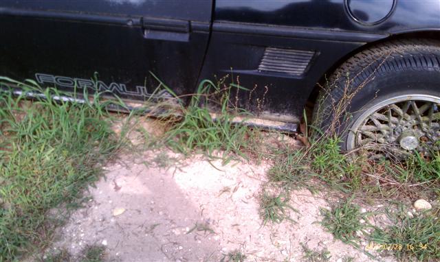

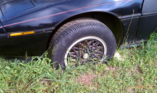

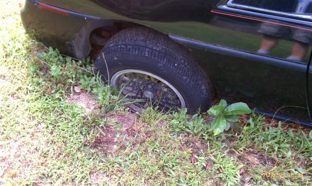

Here are a couple pics. I will inquire with the local Fire Dept and the County Heavy Rescue to see if they are interested in doing it as a training exercise, that's a good idea.
