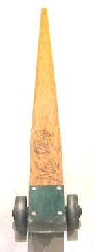

A Johnson Bar is very handy:

Interesting, never heard of a "Johnson Bar" with larger tires acting as a taller fulcrum it's be a lot easier than a typical jack just for raising stuff and moving it a tiny bit. I'm going to assume that was named after an actual person, and not because someone has a dirty mind. ;-)
