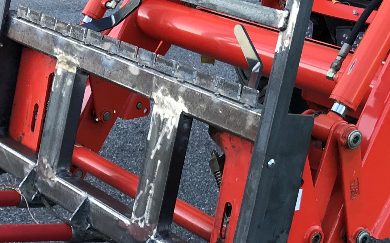

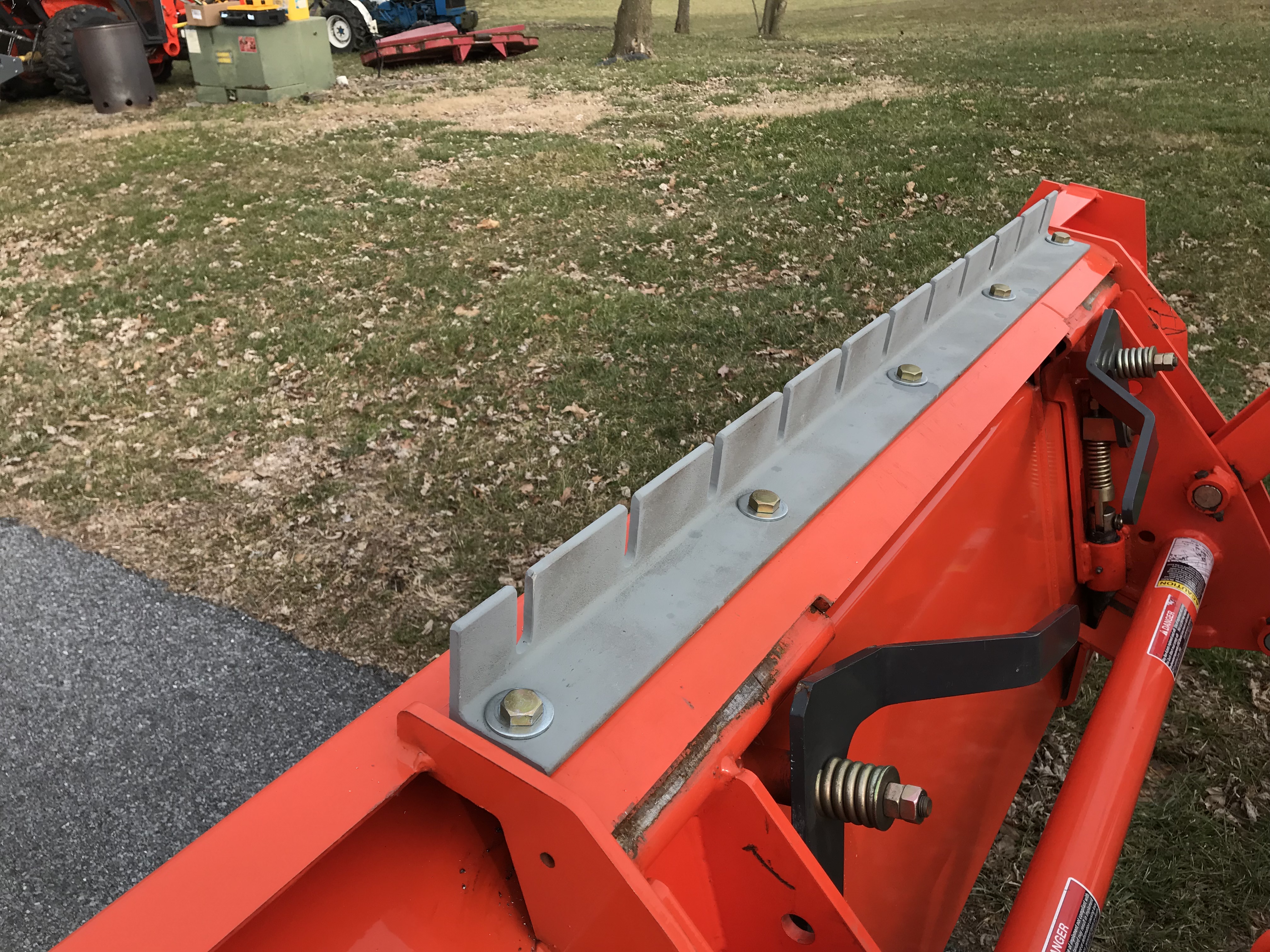

To just raise something enough to slip a cart under, maybe a few wood blocks and a digging iron. At work we have all manner of rigging stuff, but at home there are limitations. I have a boom pole that I built for the Ford 1210 many years ago. It put the load so far away from the tractor that it couldn't pick anything very heavy. Been using slotted angle on the FEL since the B7500 days back in '02 with success. Post 52 in the link below shows a few things it's been used for on the L3200:
https://www.tractorbynet.com/forums/customization/338783-advice-bucket-hooks-6.html
Pics below show the angle on the L4240 bucket and on the brush forks I recently built. With the slotted angle on the bucket I can either rig above center on the finish mower deck or connect it sort of cantilevered out front and set it into or onto something where overhead clearance is limited. It's good to have a bunch of chains, chokers and slings on hand.
