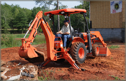

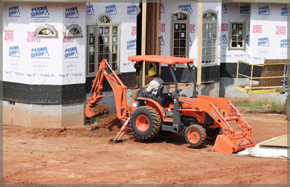

I recall reading a discussion recently regarding the use of the FEL and stabilizers to lift the tractor while using the BH. I noticed the attached pictures on the Kubota site both with the tractor raised off the ground.
I'm not trying to support either point of view. I just thought the pictures showed what one might think was the image Kubota wanted to create of a typical use.

Both of these images are of the B26 which is sold as a compact commercial grade TLB. Like its bigger brothers (L39 and L48) it comes with a heavy duty sub-frame and 4 post ROPS which completes the cube. The FEL is not (easily) removable. IMO Kubota wants commercial operators to see the B26 as small tough tractor that can be used just like the big boys -- all wheels hanging.
But Kubota's images of CUTs and SCUTs with OPTIONAL back-hoes are not so consistent. Some appear to show the tractor fully suspended and others just "stabilized" with the tires touching or (nearly touching) the ground. Some show the FEL bucket on edge and others tipped so both bucket edges are flat on the ground.
When the tractor is suspended, it is hanging from and/or resting on the sub-frame which connects the back-hoe assembly to the FEL towers and tublar cross member. AFAIK the key issue is the strength/rigidity of this sub-frame on optional back-hoes and perhaps the FEL towers themselves. FWIW I do not know the answer.

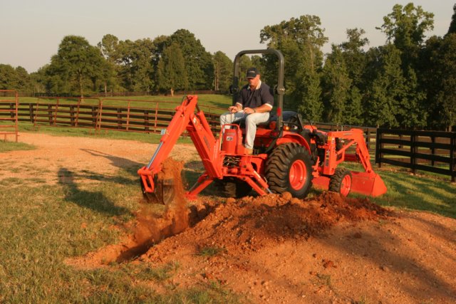

There's a potential for those pics to stir up a bit more controversy because they're of the B26 TLB... some could argue that's different from a non-TLB tractor with FEL and BH attachments. So, in an effort to remove some ambiguity here are some pics of a BX24 and a L2800 off of Kubota's website ... I brightened them up a tad so that it is clear that the tires are off the ground. The point is all of these components are designed to handle the loads... If they weren't, then the manuals would be very clear about it and like everything other potential safety hazard, there would probably be 17 warning stickers plastered to the tractor, FEL, and BH.

Yes. Compare the first photo in the B2630/3030 image gallery on the Kubota site to the pics you posted.
The question is whether the B26's beefier subframe is _required_ or is it just insurance for likely abuse in a commercial setting.
FWIW I agree w/ DiezNuts that the manual(s) would have clear warnings if the equipment was not up to the task of suspending the tractor (e.g. blah-blah voids the warranty, etc).
