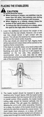

Here is what my new BH90's manual has to say about the use of stabilizers and loader bucket (the attachment is a scan of this section of the BH90 manual).
"Placing the Stabilizers...
1. Lower the stabilizers and remove the weight of the backhoe from the rear wheels. However, one or both rear tires should remain in light contact with the ground. This will give the backhoe the widest possible stance and the lowest center of gravity.
If the rear wheels are raised too high, digging depth will be reduced and undue stress will be exerted on the backhoe frame components.
If the slope is unusually steep,...
2. The loader bucket should be lowered to give the backhoe unit a "tri-pod" stance. With the loader bucket in ground contact, front tire bounce will not be a factor in overall control. When possible, the loader bucket cutting edge should be lowered vertically into the ground surface. This will assist the stabilizers, not allowing the unit to shift, while excavating. However on a slope, the bottom of the bucket should be used, and only the side that contacts uneven terrain. Too much loader down pressure, on a slope, will restrict the unit from being correctly leveled and will place an undue twist though the loader bucket and lift arms."
