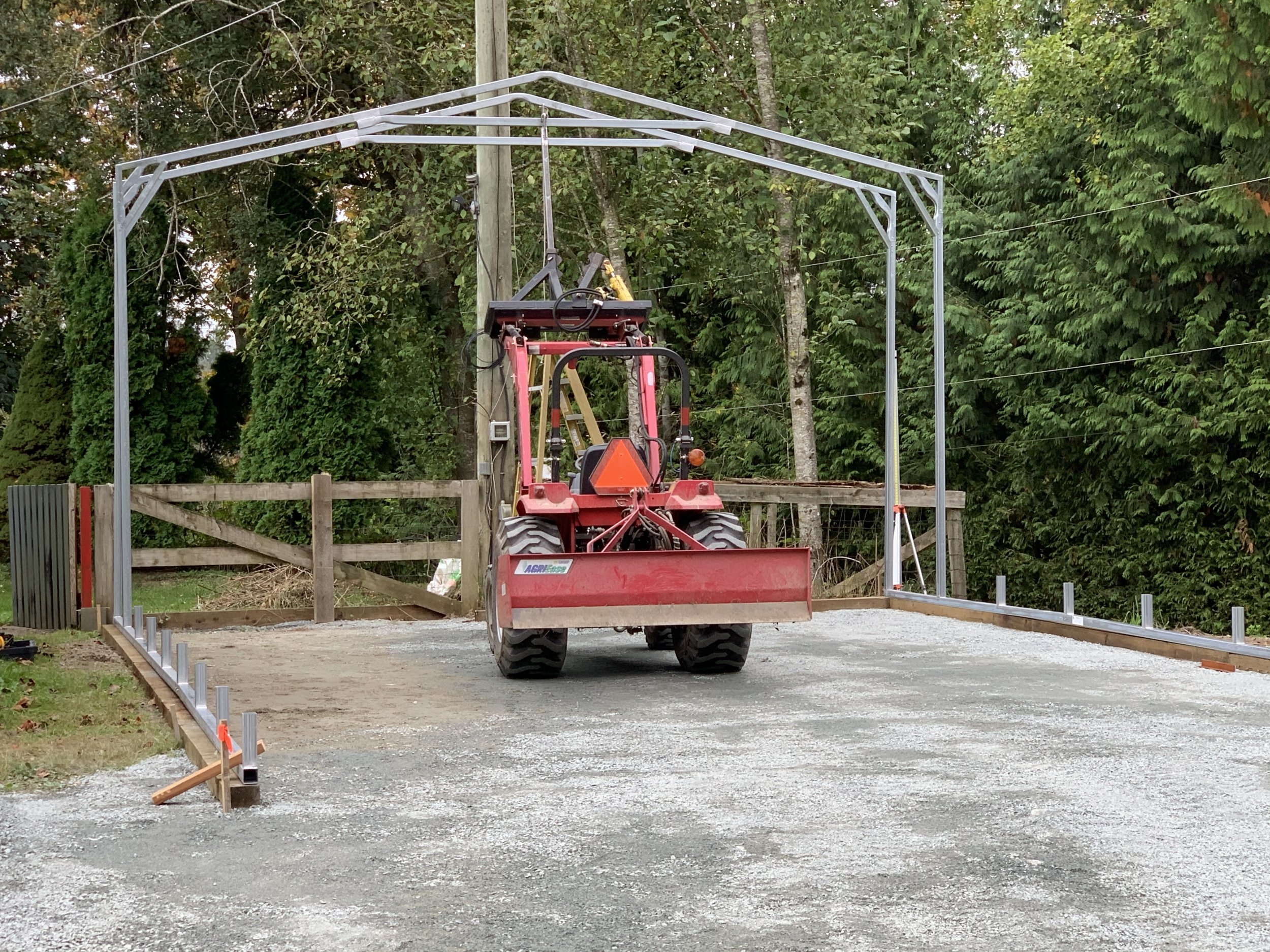

I have a stump puller that has a 2” receiver that I added a piece of 2x2 tube to for lifting. I made a longer tube (5’) to lift the frames in the picture.

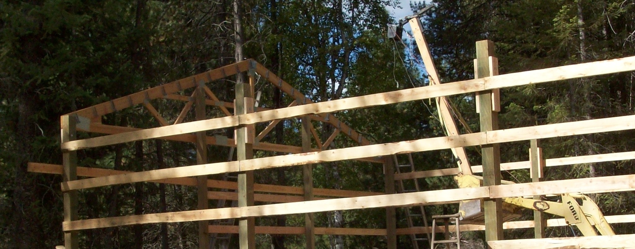

That was my other thought. I have a winch on the tractor and could easily put a pulley on top of the vertical pole. Right down the road they sell old telephone poles that could possibly work well.
I was also recalculating - I only need it 10' long instead of 14 since the FEL can lift to almost 8'. Perhaps 2 boards screwed together at 10' long would get me there. I think I have a 50#bag of feed - maybe I'll put that on the end just to test.
That is how we did it on my shop, mounted a HF winch at the top of a couple 14' ? 2x6's screwed and bolted together.
Stabilized it (triangulated) with tie downs to the sides of the bucket. Walls are 14', trusses were 30 feet long.
4/12 pitch (Similar to Farmer 495) I did make top and bottom brackets to attach the 2 by's to the Ford's bucket. It actually worked pretty well.

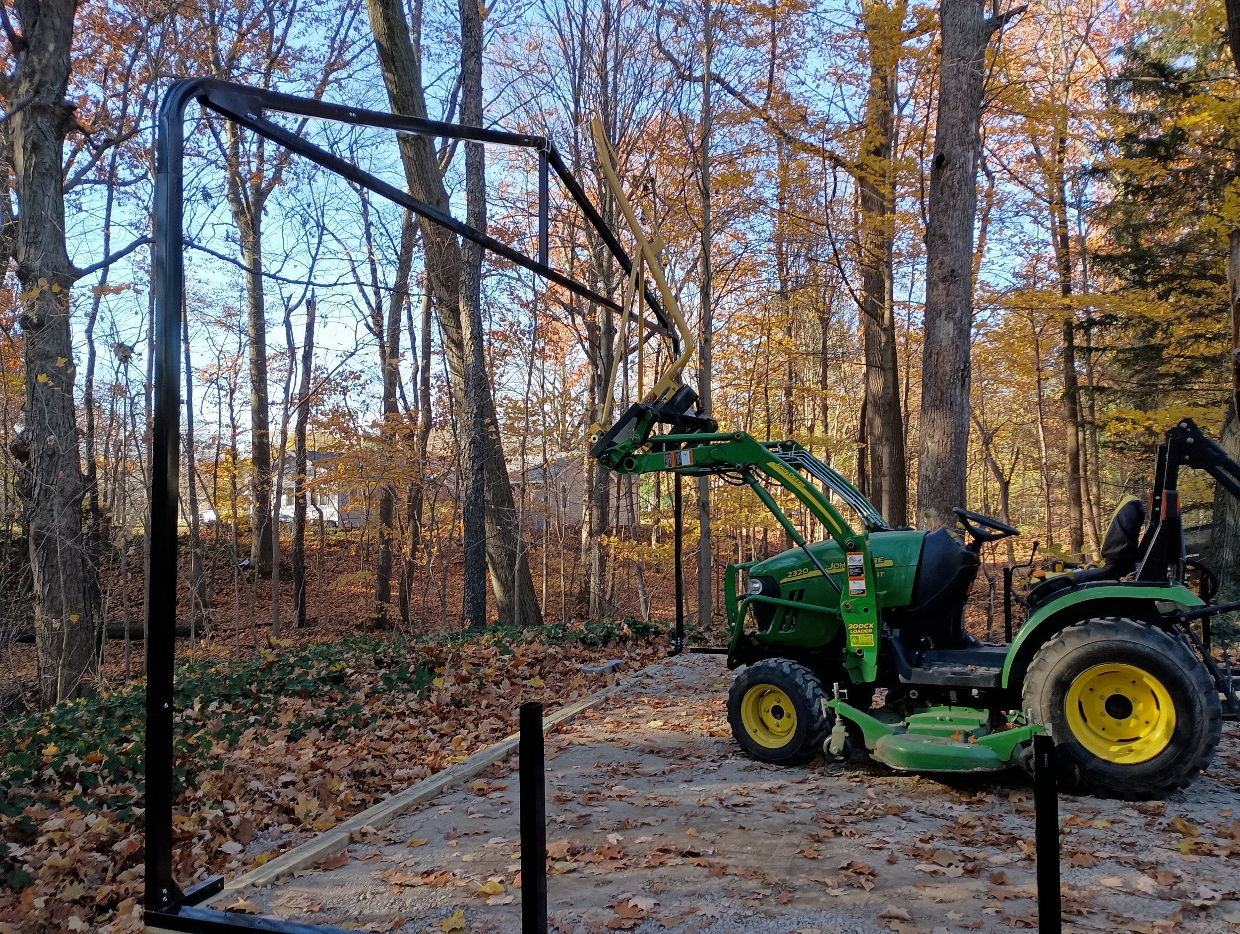

Should be a piece of cake. I set my ShelterLogic trusses this way with the vertical posts attached so they were heavier than yours and I have about a 1000 lb lift capacity. I have a 3 point attachment on my loader so I can use my boom pole.

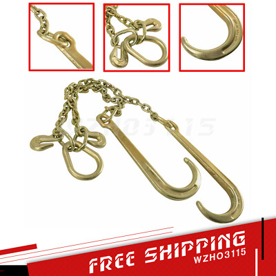

For these smaller operations, without a bunch of people walking the roof, how do you unhook the truss from the boom you have up in the air with the tractor in use? Like in the picture directly above?
   / Lifting truss with FEL #38
Pretty neat process you all have come up with.
I used a tow truck "J Hook", kinda like this:
You need to spread the lifting points as wide as possible, so maybe with longer chains if it's a real wide truss. Didn't have to climb up to un-hook anything.
