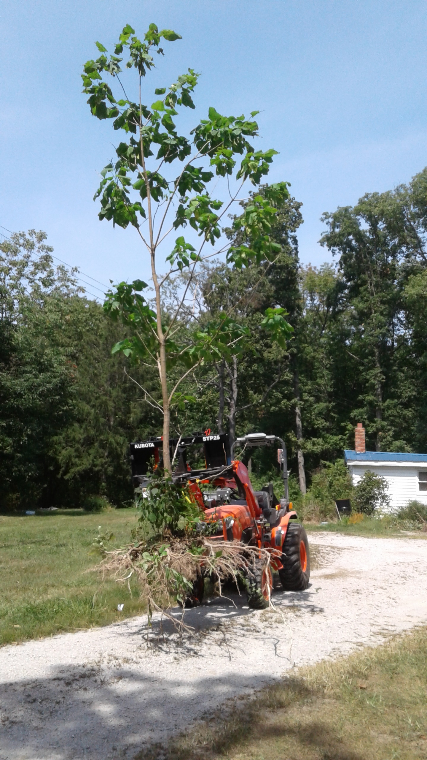

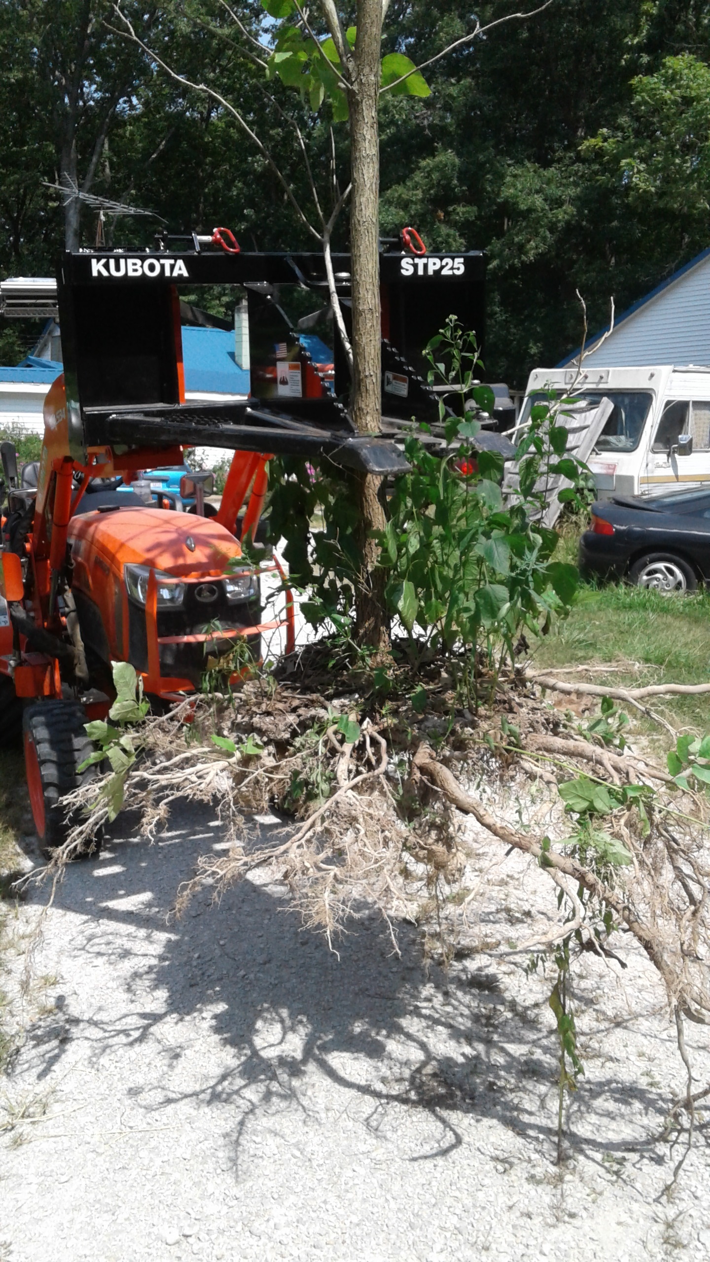

Too late for existing stumps

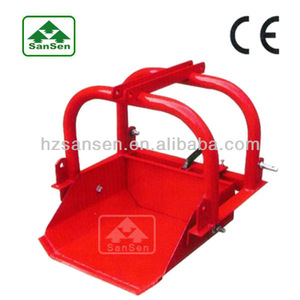

Here's a picture of the 3pt dirt scoop we are calling a "poor man's FEL". The lifting capacity of the dirt scoop on the 3pt of the 33 hp JD Ag tractor is about a ton. You can also scoop in fwd or rev. Dumping is manual.

MechanicalGuy: You recommended using the Piranha Bar on the FEL bucket? Does this really work using the Piranha Bar to "pop out" stumps? Can you give short detailed description of the procedure or process.
The reason I ask, is that i usually grind all stumps 3" and bigger to below ground level. They are no longer an issue. But this leaves me with lots of small stumps 2" or smaller remaining above ground, which is a major threat to mower blades.
All I do for small stumps 3" or less, mostly I've done a bunch of 2" stumps, just put the corner of the pirahna bar right at the base of the stump at a sharp angle, under the ground about 2" or so, and drive the tractor forward, curl the bucket upward or lift straight up. "Pop" out comes the root ball. Done it dozens of times on privet, pine, and other root balls. Works way better than my grapple.
The bar is sharp and the v-sections funnel the root into them and the sharp bar won't let go of the root.

Thanks so much for that short but detailed summary on small stump removal. I also found some videos on Utube which documents exactly your procedure.
I have an estimated 45 stumps, about 3" or less that need removal. I just flag them with a pole to avoid mower damage and really need to remove them. I just found the "wicked bar" online from Everything Attachments, and will order one for my bucket.
