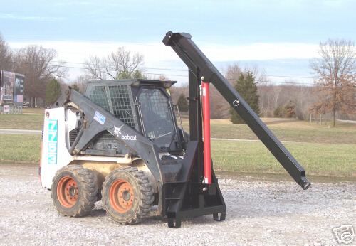

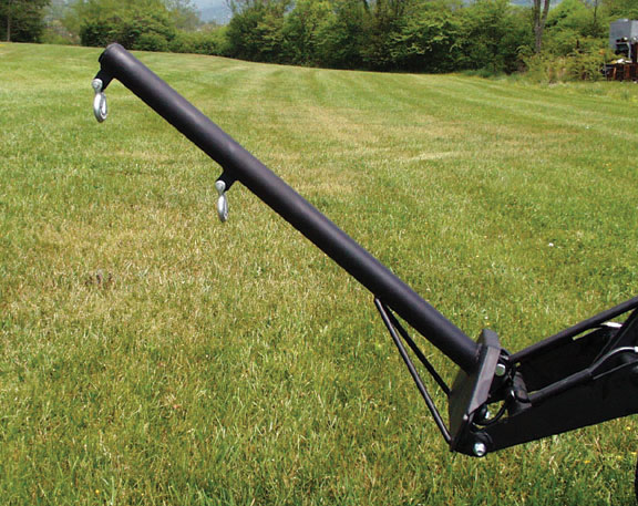

How about something like this.
If you went with a hyd motor, the winch to hyd motor adapters are readily available.

What I have is essentially the tree boom you posted in the second photo. I may just give up and get the HF winch you mentioned earlier as it is by far the cheapest solution. I could then use it and when the motor corrodes or craps out then figure out how to adapt a small (very small) hydraulic motor. My efforts to find anything on surplus supply have come up with no joy but it still might be a fun project down the road.
