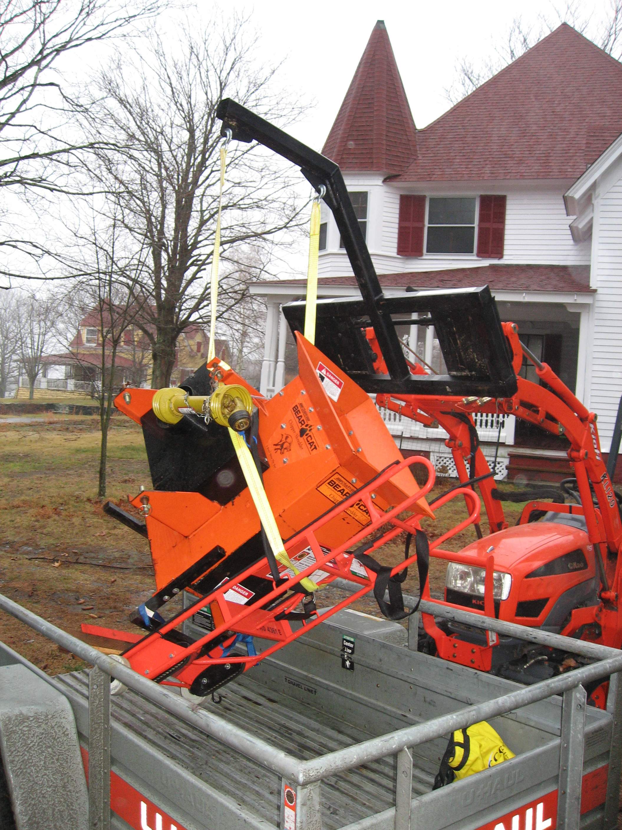

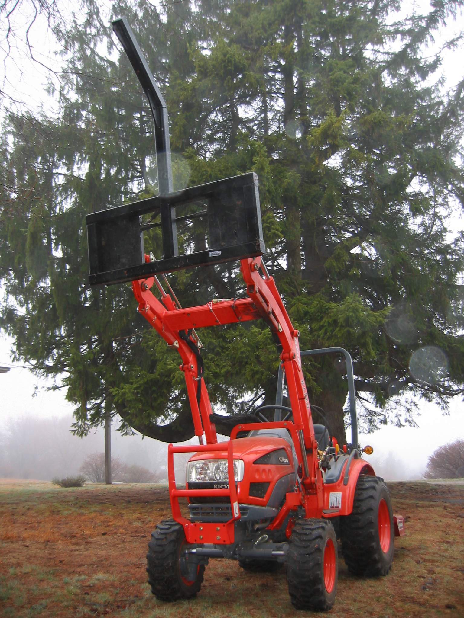

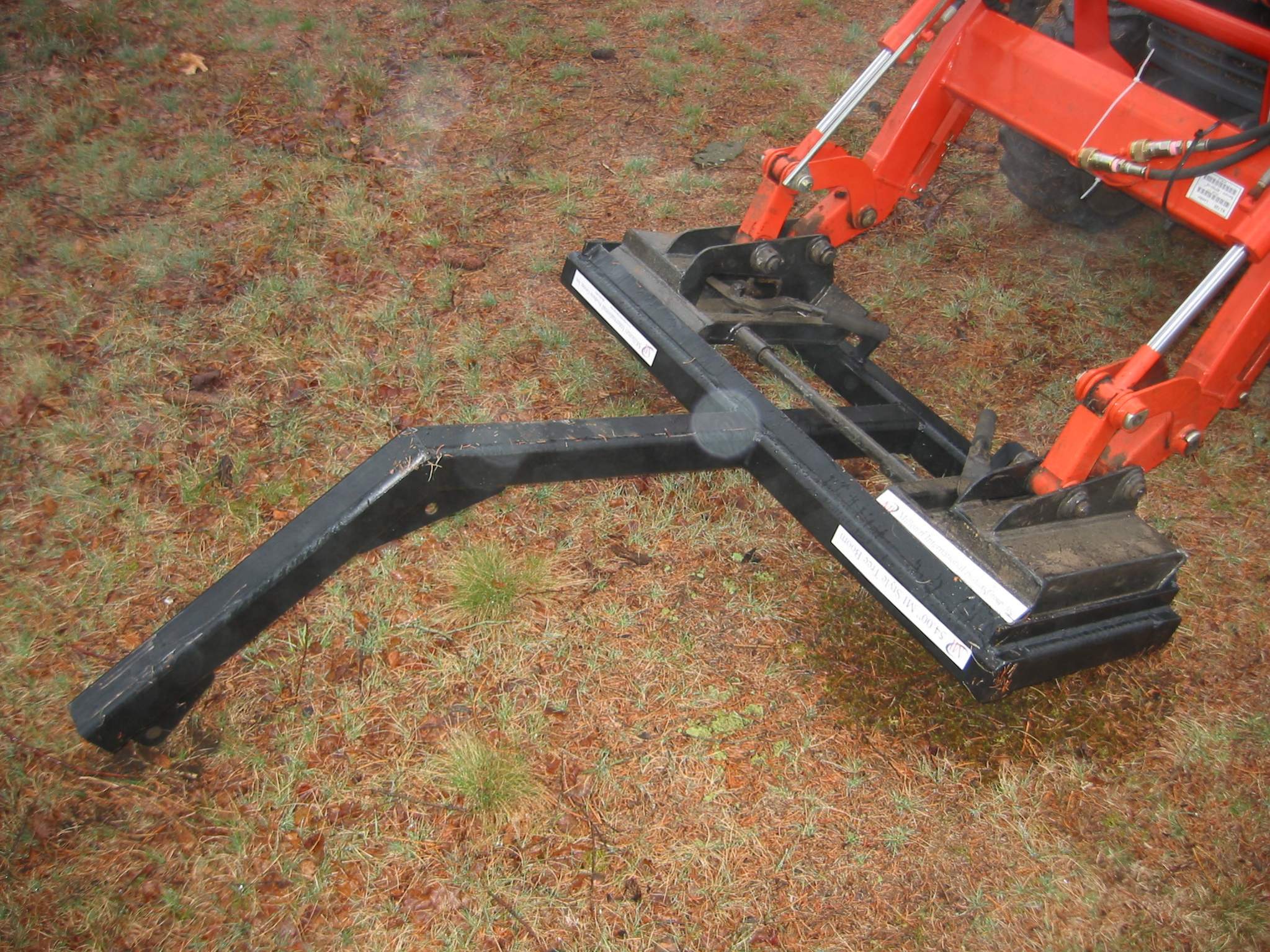

I'd say it was designed more to lift burlap bagged trees off the ground rather than pull them out. It is made of 2x2 square tube and is pretty tough. I use a grapple to get trees/bushes out of the ground though and just use the "tree boom" as a mini crane type of implement.

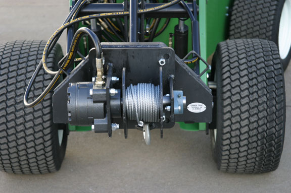

This is Power-Trac's hyd winch, but it ain't cheap. $950.

That is the idea but I don't need anything nearly that heavy duty (or expensive). What I would like is a small hydraulic motor which can be had for less than $150 plus about $50 in winch parts.
Given the availability of relatively inexpensive 12 and 110 v hydraulic powerpacks these days (as well as all the CUTs running around) I am a little surprised that there are not more "light duty" hydraulic implements/tools/devices available. Of course most of that market is simply taken by the electrical or even battery powered tools but there are instances where hydraulic power would be preferred.
