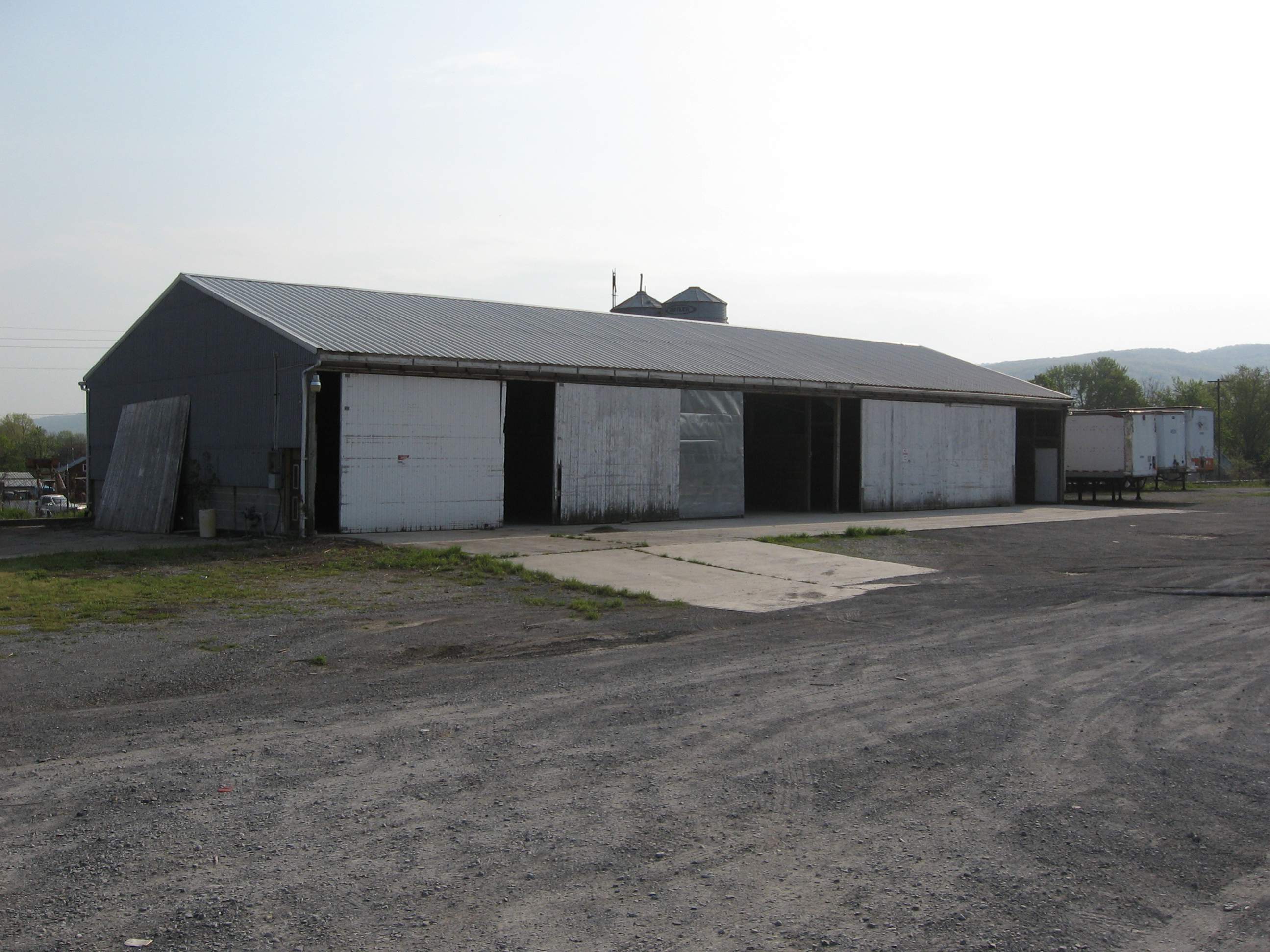

I'll have to rent a lift to do it. this barn has 7, ~15' wide bays. Each bay has a wall between it 8' high, T&G 2x6 boards, and there are internal poles in these walls. Floor is all concrete with a nice large concrete apron in the front. Very sturdy barn, but needs some TLC to get it cleaned up and looking attractive behind our church building. I want to reskin the outside with new metal. It has a 400Amp electric service, with two working outlets, nothing else.

Pic of one of the bays with the 8' wall between bays, the interior posts. trusses run front to back. There are 2x6's running side to side to the interior posts, under the trusses. ceiling panels will stop at each of these and continue on the other side. We have been cleaning out the bays and pressure washing the walls.
also added a pic of the barn when we bought it. Those front sliding doors are really heavy, 4 have blown off, and are being replaced with garage doors.
I should start my own thread I guess, but our upgrade / repair will be gradual as we get the funds.

Looks like an interesting project. Do you intend to run the ceiling perpendicular to the trusses or parallel. It looks like you could add a 2x6 stringer between the ones that are there and then run the ceiling in the shorter dimension direction. Any reason not to have the metal under the 2x6's to minimize the edges and panel cuts? If the bays are about 15', 5 panels will just about fill it. The bays will look better if the panels run front to back from the door. just my thought on it.

I like the panels running front to back from the door as well, but it looks like he'd have to notch the panels for all of the vertical posts, which would slow things down a lot. I wasn't quite sure from the picture if running on the trusses would avoid that since I'm not sure how the 8' walls attach.
