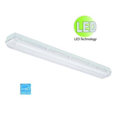

Does anyone have this one? HomeSelects Grey LED Vapor Tight Light-6218 - The Home Depot
HomeSelects Model # 6218 Internet # 204630030
Thinking about putting it in the tack room.
   / Lighting for the pole barn #57
I considered that model (liked that it was 48" long), but decided it was worth spending the extra $50 for the one I linked above because it puts out over four times as many lumens (11,200 vs 2500).
