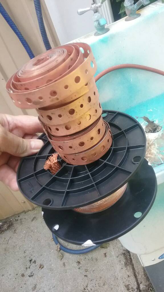

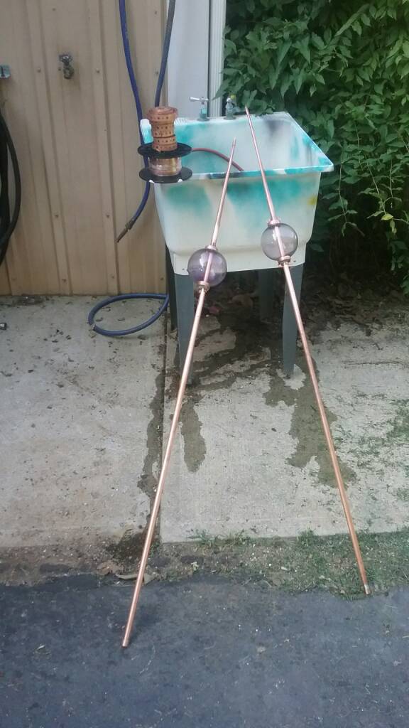

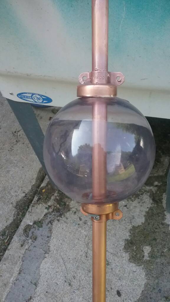

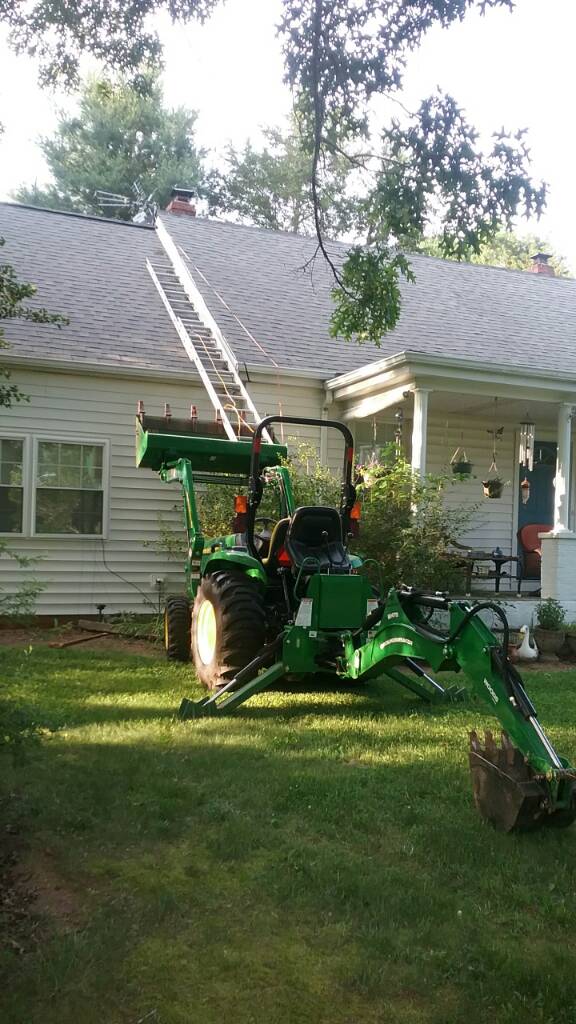

Oh...this is how I got on roof today. In 90s so I couldn't do much. I did manage to run braided copper wire chimney to chimney then down to ground rod. I tucked flat cable under roof cap shingles as I went along.
Near ground rod I have a big fake rock to cover a Malibu light transformer. Yes there was a big 'ol black snake under there. 20180618_191313.jpeg
/ Lightning rod? #33
I hope you went down each side. I believe that's important to form as much of a cage as possible.
