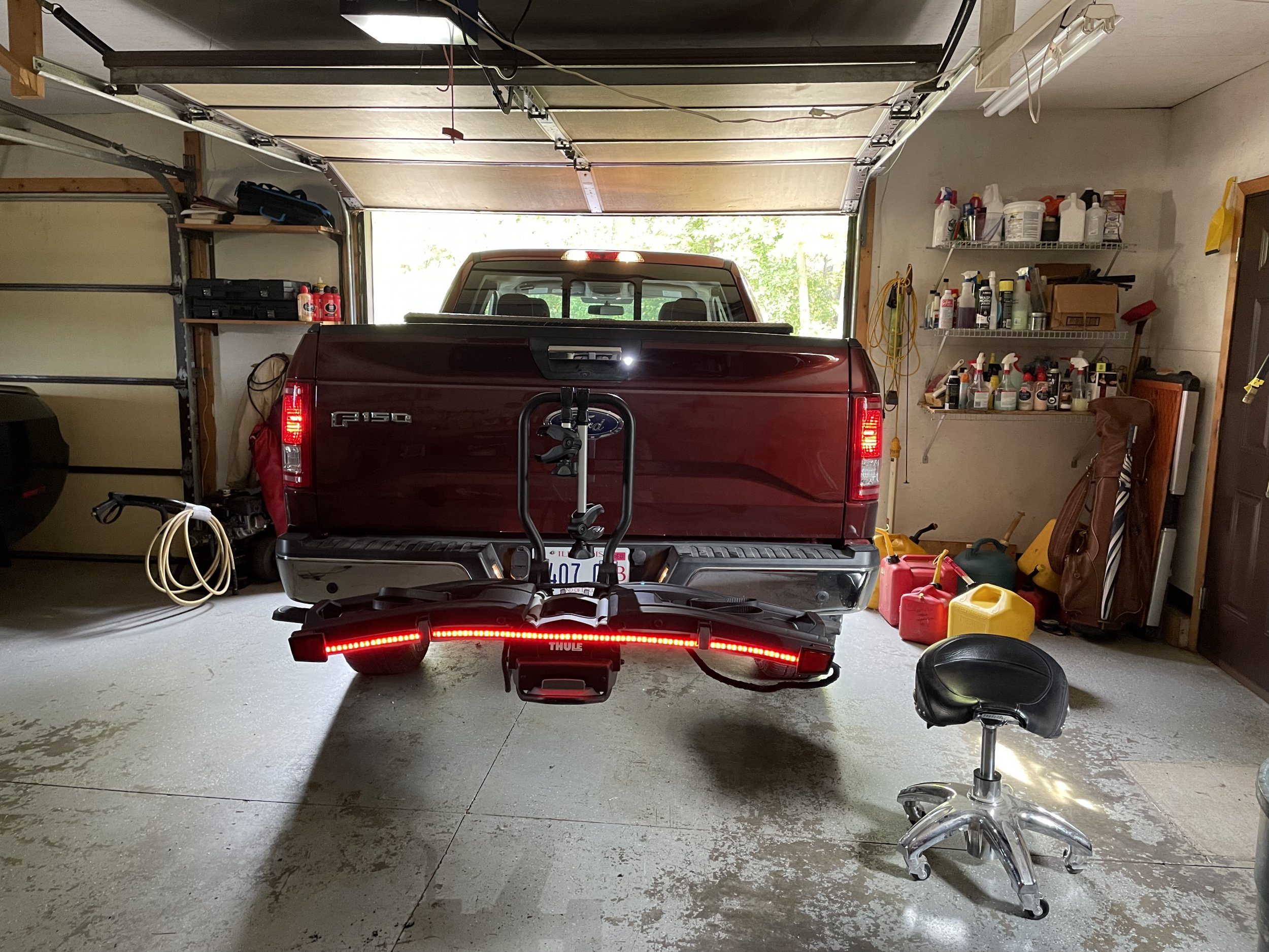

I have a Thule bike rack for my truck. It blocked my taillights mostly when bikes were on it. I added an LED strip to it that plugs into the flat four. Like Arly says, no brakes but it knows it’s there the minute you plug it in.
