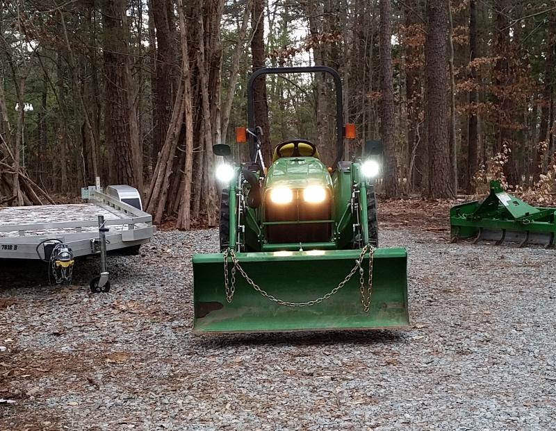

Does anyone have any pics of lights mounted to the FEL arms (or otherwise)? The headlight on my DK are bright but with the loader on they shine right into the rear of the quick attach and/or bucket unless the loader is almost at ground level. I was thinking that mounting a set of lights on the loader arms may be beneficial, just looking for some inspirational ideas. Mounting them on the ROPS is not ideal in my case as the ROPS typically stays tilted down to clear the door of the barn.

This picture is from a thread over on green tractor talk;

Had lights on my loader arms before, no rops. They alwsys cought on branches and got banged up. If you have a rops put them there. If no put them near the rear upper loader pivot. They should survive better.

This is what I did with a B7500 years ago. The lights are on brackets attached to the part of the FEL frame that stays with the tractor and mounted inboard out of harm's way. They worked better than expected, even doing a good job in front of the tractor where it seems the hood should block them. These were the cheap rectangular floods before the age of LED lighting availability. Another benefit with this mounting (rather than ROPS) was less irritation with bugs buzzing my head while mowing at night.
