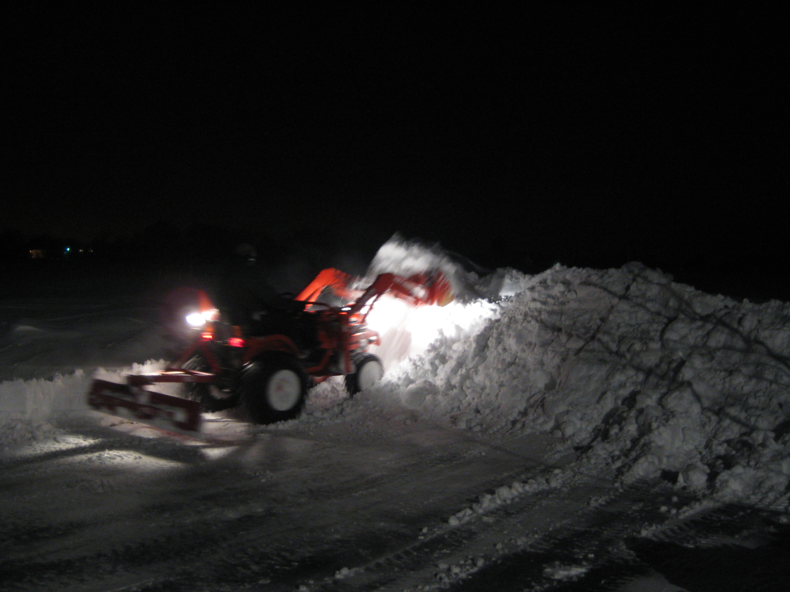

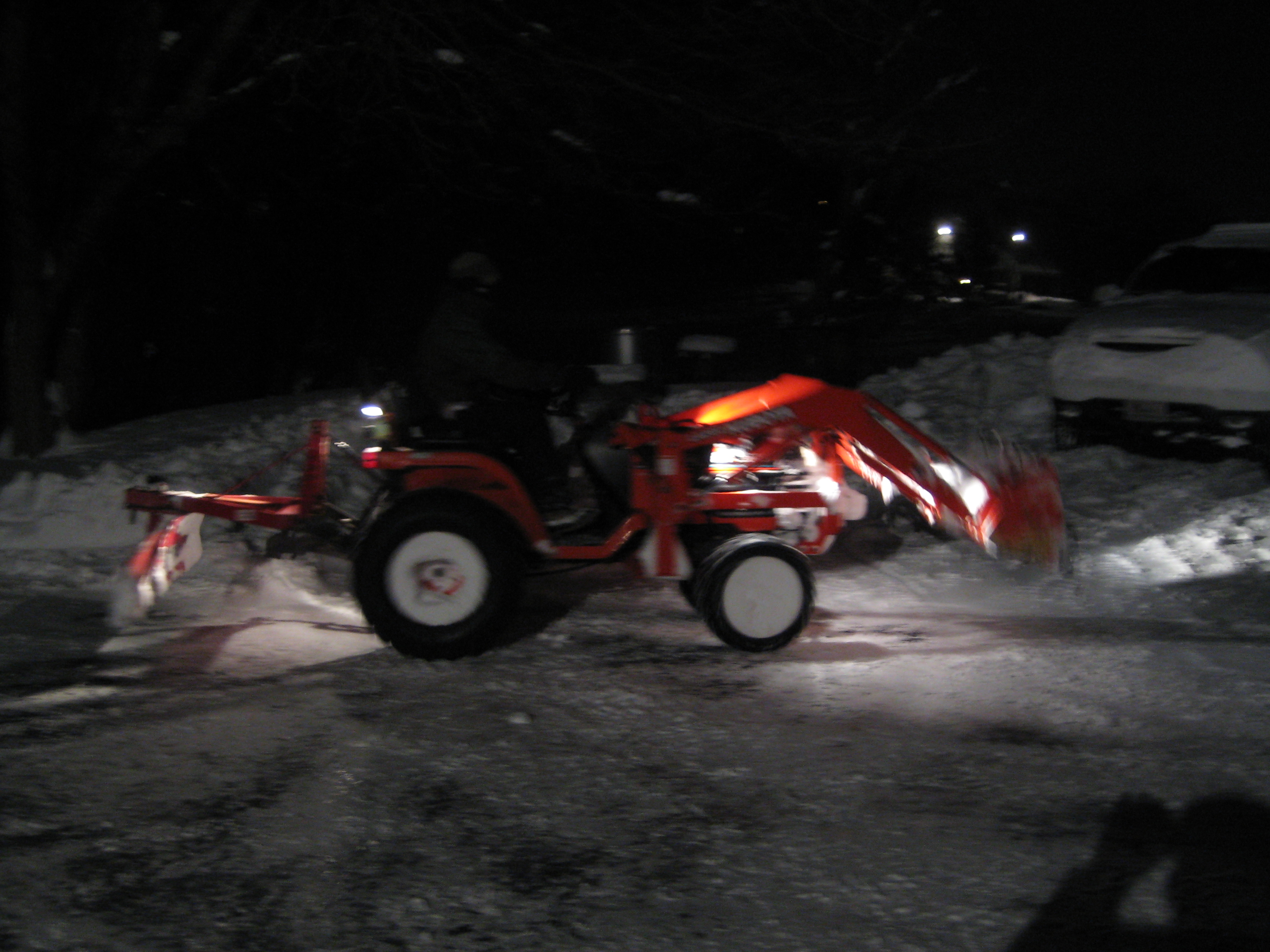

This is what I did with a B7500 years ago. The lights are on brackets attached to the part of the FEL frame that stays with the tractor and mounted inboard out of harm's way. They worked better than expected, even doing a good job in front of the tractor where it seems the hood should block them. These were the cheap rectangular floods before the age of LED lighting availability. Another benefit with this mounting (rather than ROPS) was less irritation with bugs buzzing my head while mowing at night.
