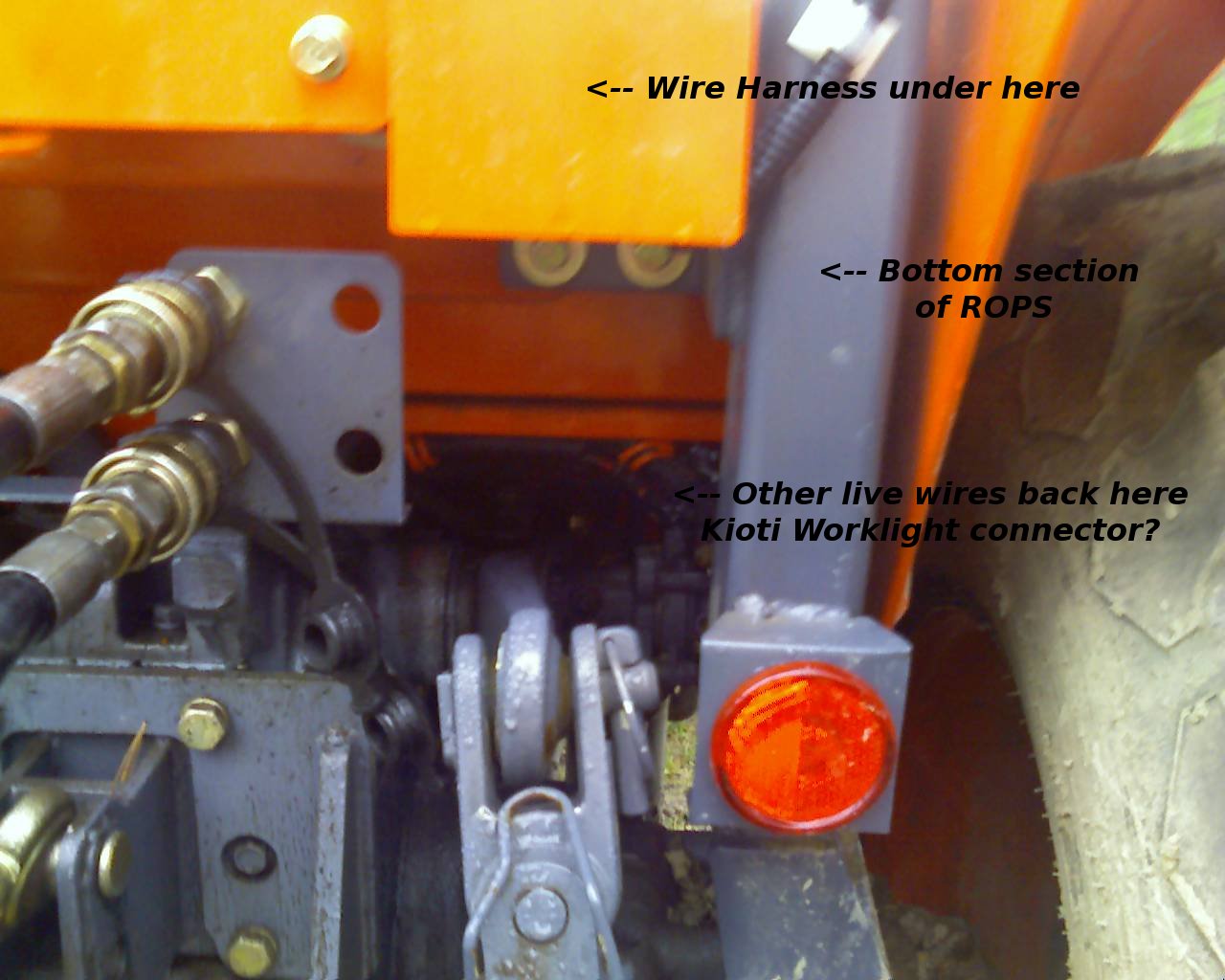

Funny, I've been working on this for my ck25. I was waiting until I was finished before posting it.
Here is what I've got so far.. I found 2 live connection on the back of my CK 25. I'll have to look later, but it popped the 7.5 fuse.. second one from the bottom of the fuse block if I remember. I just found my multimeter last night, so I still need to check the line to see what it has.
The wires are black and red, one each male/female bullet connectors. Looking the back of the ck25, they are on the right side under the tool box. (I also found a second ground in the middle plus 2 other lines on the left side, yellow? and brown?. These other two had no power, but I just connected the light to test)
Down below the black and red bullets that have power, in back behind the hydraulic connectors is another live black and red wire. But, they have a connector on them I wasn't able to find in any auto part stores. This is the one I popped the fuse on, which I think was the work light fuse.
The store only had one 55 watt light, but I did a test connection on the bullet connectors and it lit the light with no issue. I also plan to have 3 lights if possible.
I'll try to take some pictures of what I have done so far tonight after work and check with the multimeter.

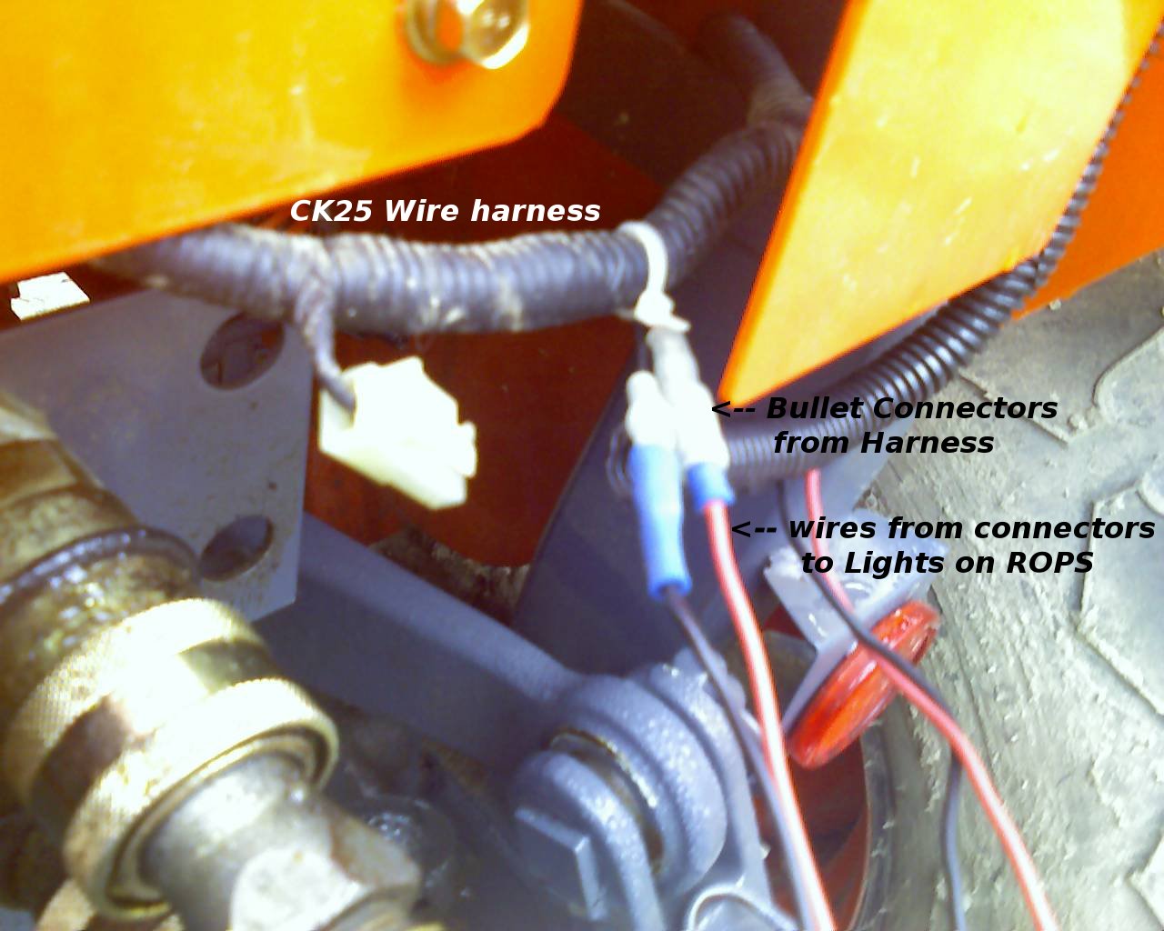

Here are 2 pics I just took of the location of the wires I found.

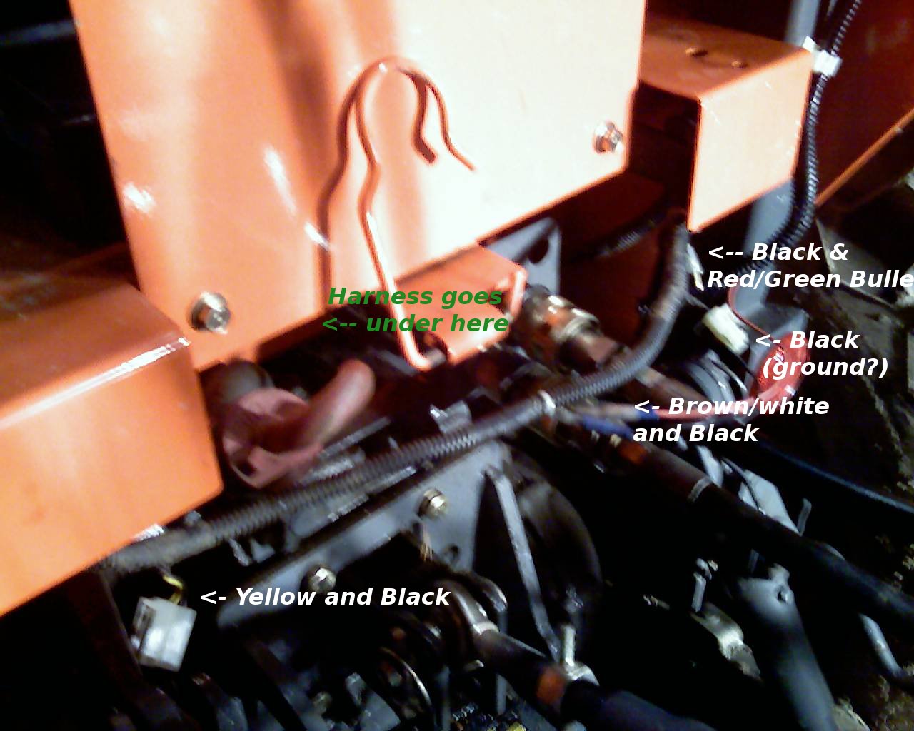

Hi,
If you follow that harness a little further to the left side you will find a brown/white tracer and a black. This pair will be live when you turn on your headlite switch(key on). Unfortunately I would question how much current this wire can handle (20ga). I would suggest a feed off the battery cable on the starter terminal with an inline fuse and a seperate switch. The starter terminal will make the distance shorter for running wire and has all the amperage you will need and will not effect the starters performance.
Good luck.

Attached is a pic with the wires Dave mentioned. I've connected my one light to this for now. Picture was taken in the dark with some spot lights on the tractor, not the greatest quality.
For some corrections to my earlier post, the red & black wires with the bullet connectors is red w/green tracer. I couldn't get into the other wires below it to see if it had any tracer colors.
I'm debating using the red w/green tracer & black wires for the back set of lights and placing the front facing lights on the brown w/white tracer & Black set. That is IF the wire can handle the lights

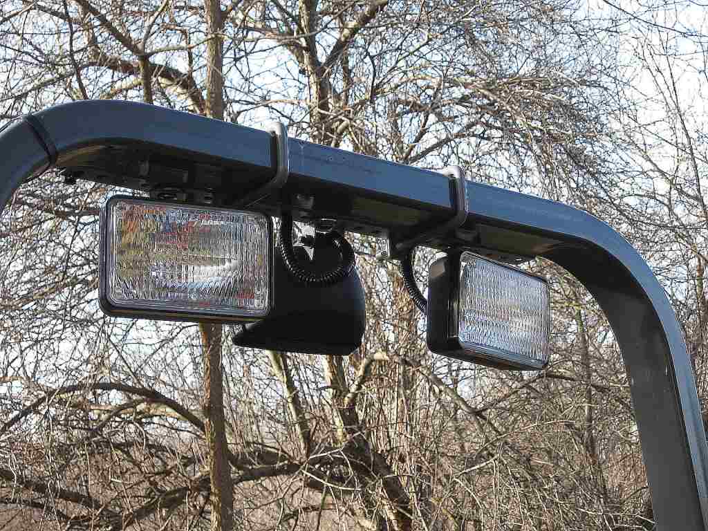

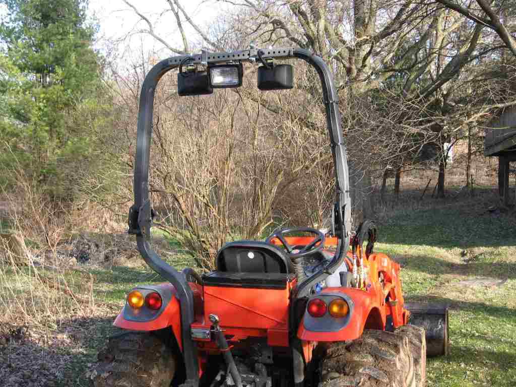

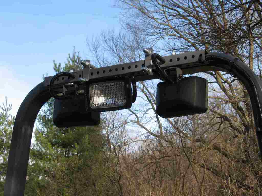

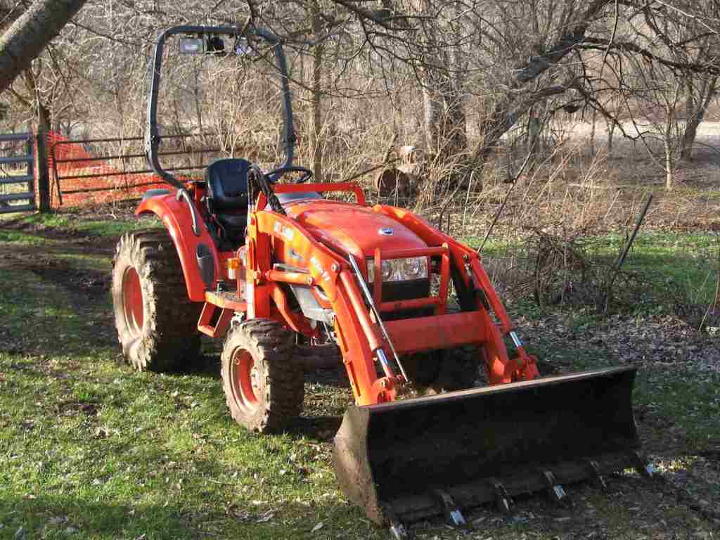

OK, finally got it done.
I ended up wiring to the existing bullet connectors on the back of the tractor. The rear facing light is wired into the brown/white set and the two fronts are wired to the red & green set. The brown and white wires are hooked into the main light switch, so in order for the light to turn on, the headlights have to be on. The two fronts are independent, but the key does have to be on. I've run them for about 5 hours solid with no problems, felt the wires and nothing seemed too hot or near melting. No fuses popped either :)
They both are controller by some rubber booted toggle switches I mounted on the slant in front of the seat (sorry, no pic).
The bolts that go around the ROPS are 2 inch leaf spring bolts I picked up at an auto parts store. Gave everything metal a coat of Machinery Gray Duplicolor. For the record the trim seems to be actually Charcoal gray.

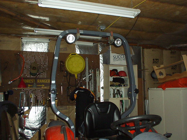

Let there be light

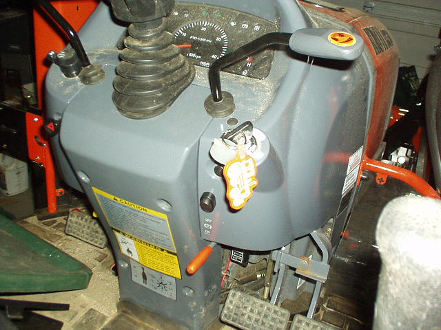

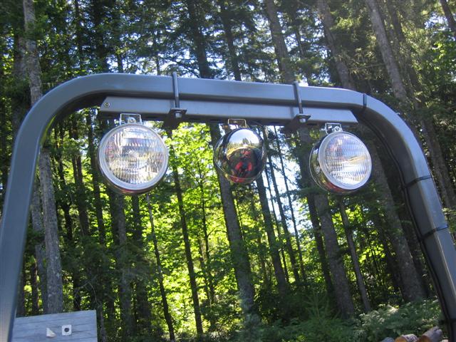

Must be the season to add light to the CK.:) Here was my solution, nothing earth-shattering here. Looks similar to the others' approach. I did not wire into those connections in the back harness though. Did not like not knowing what else was on those circuits, electric draw was a concern. So I ran a lead from from the fuse box, in line fuse and wired to a switch mounted below ignition on panel(even has a little red LED to indicate on :) ). Circuit is only hot with Acc. or On with switch. Seemed to work well. Have yet to add one more light for rear facing, may tap into the described existing rear bullet connectors for it.

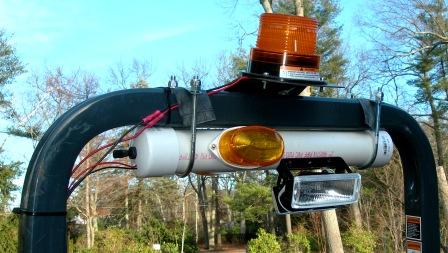

Here's a quick-and-very-dirty version I threw together just to see how much overhead lights would help with plowing. (Headlights are useless; blocked by loader bucket and back-scatter is blinding.) The flasher on top was installed by dealer; it's too vulnerable to branches, and will come off now. Meanwhile, the 2" PVC pipe mounts two 55W lights, fore-and-aft blinkers and a switch. Power is from the accessory plug behind the fender; it comes on with the ignition.
Not nearly as neat as the others here; if it helps enough; I'll upgrade to one of your excellent designs.
-Chelydra
