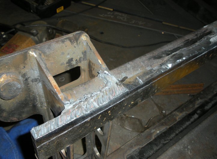

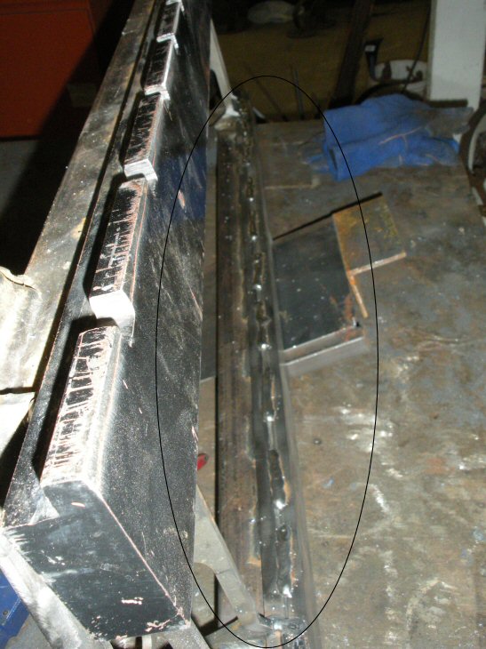

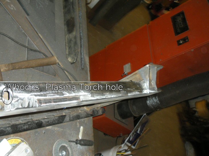

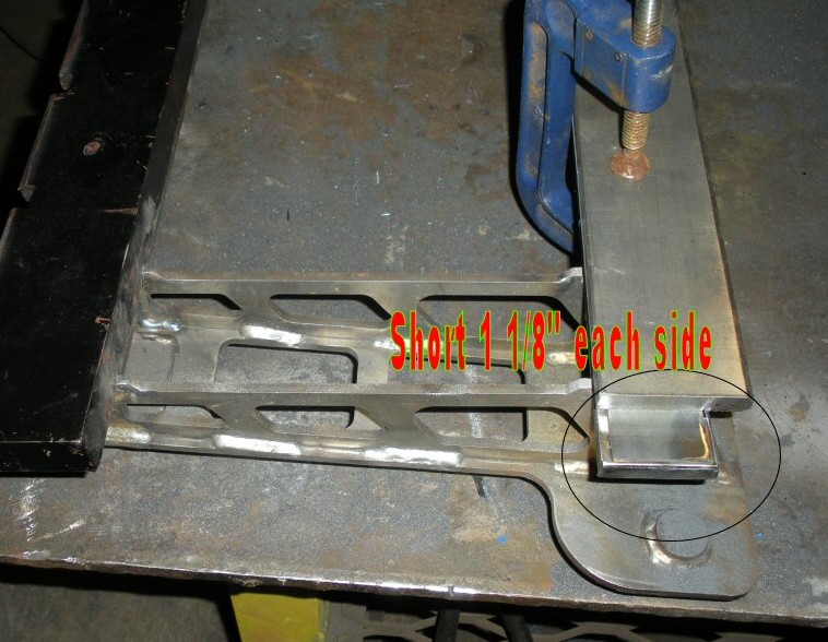

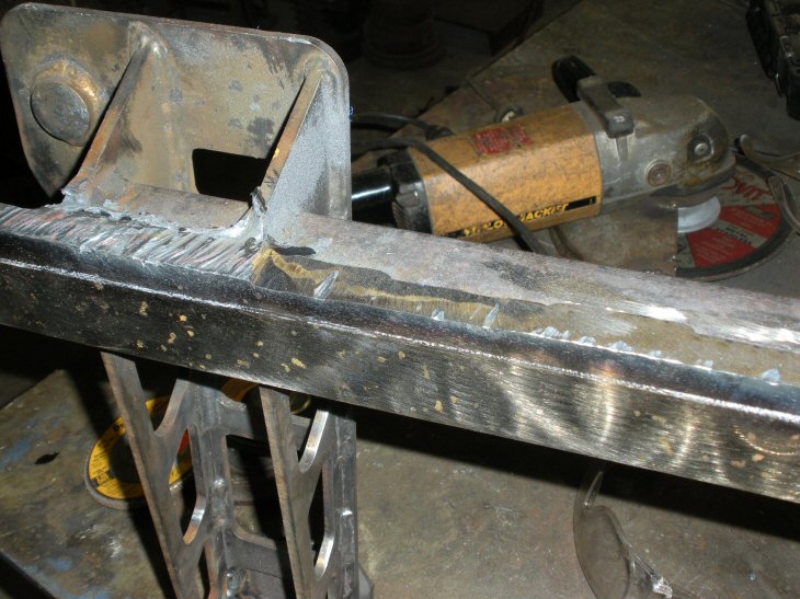

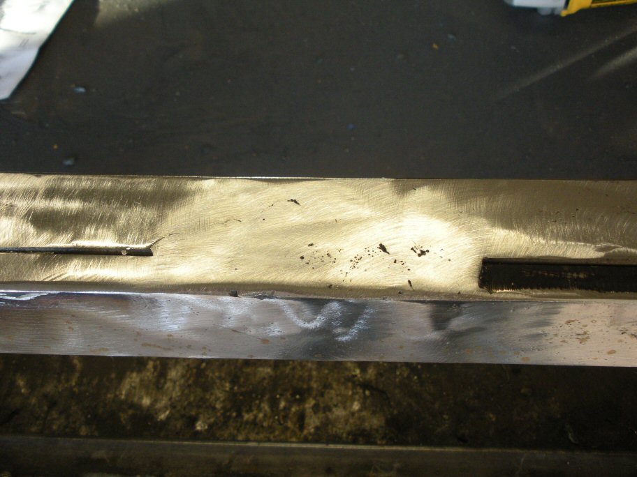

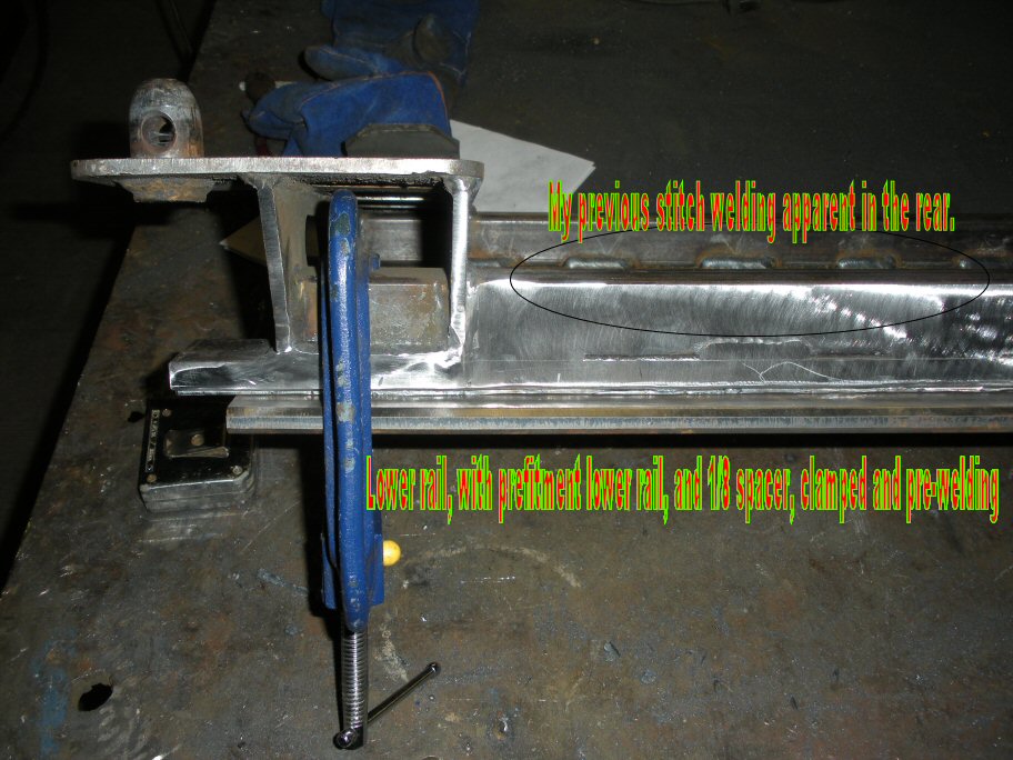

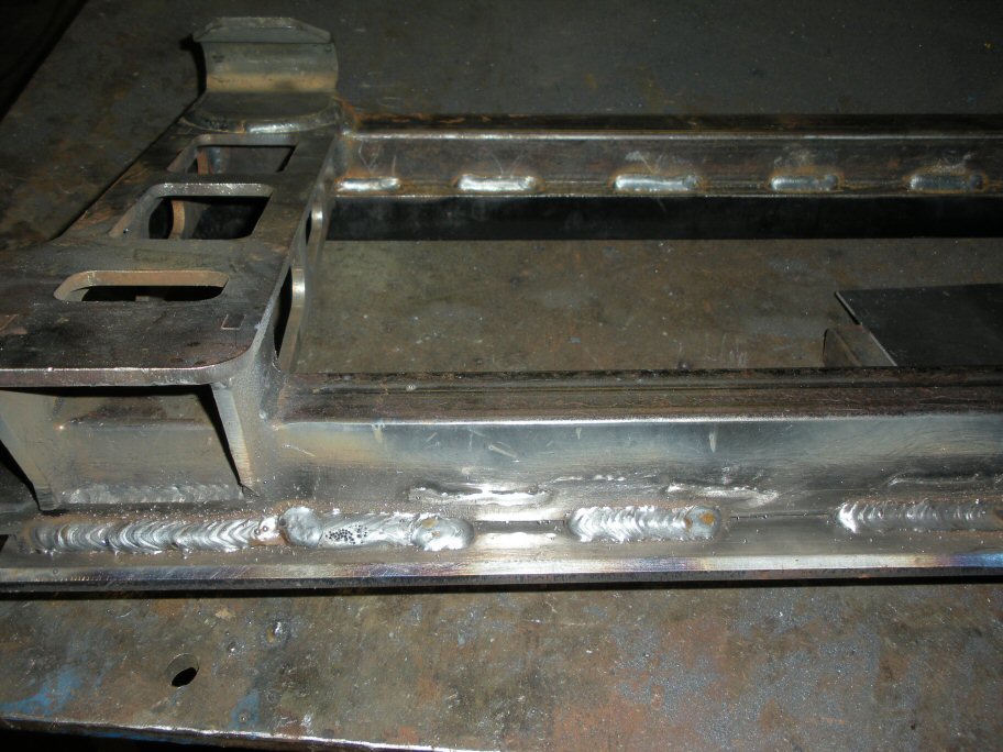

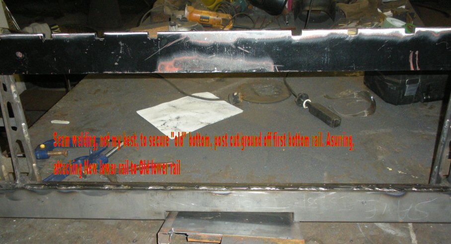

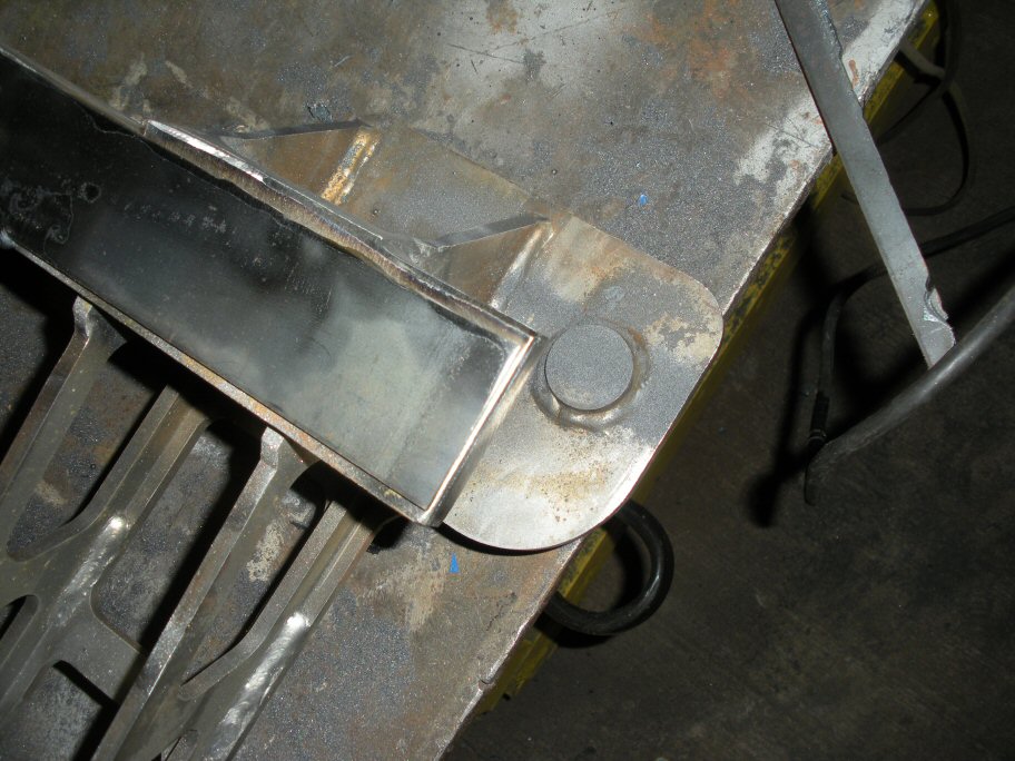

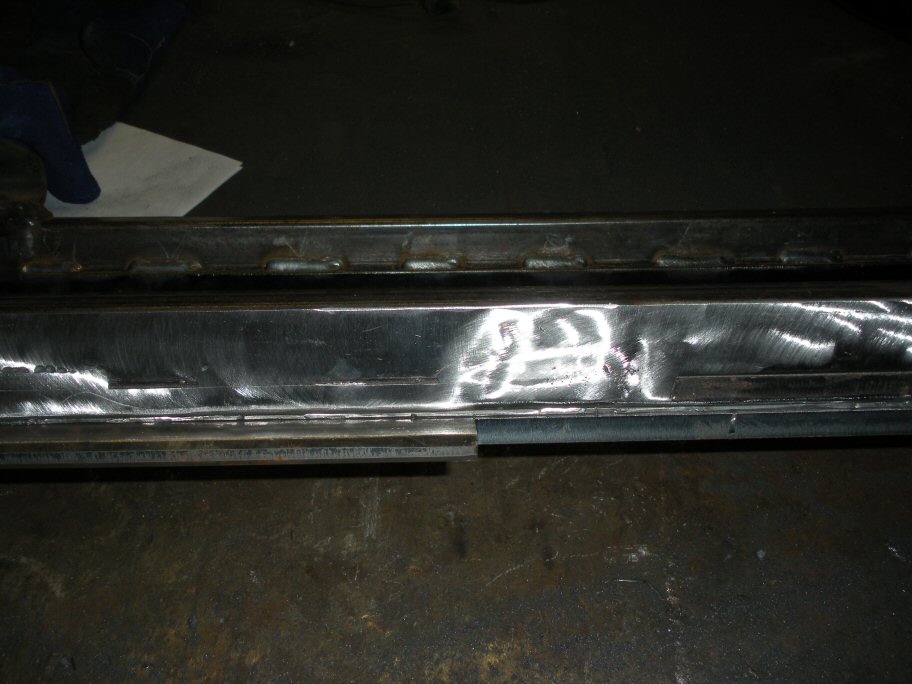

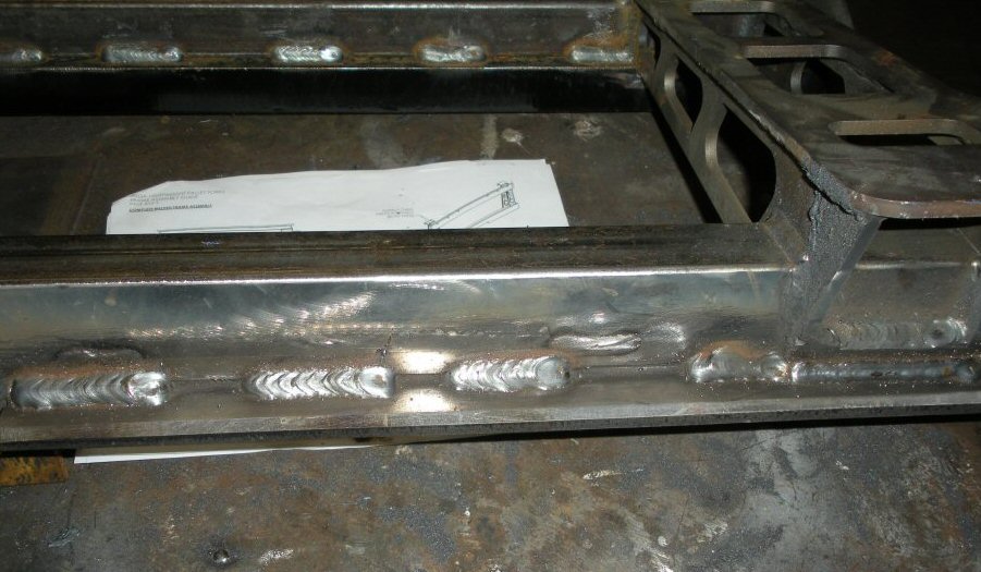

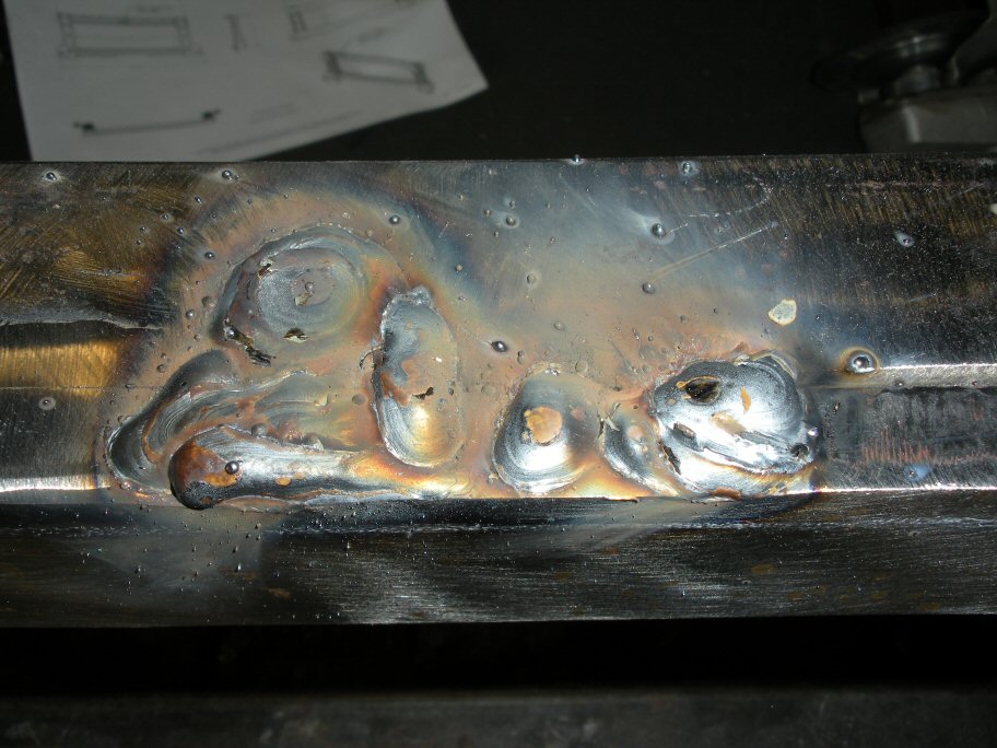

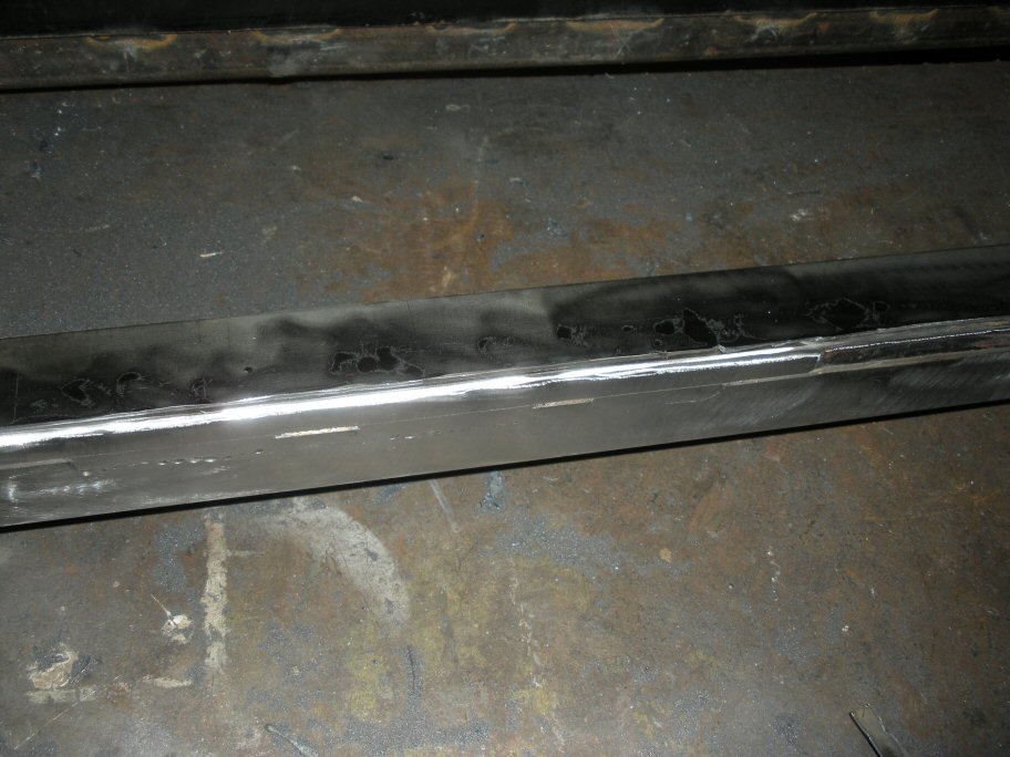

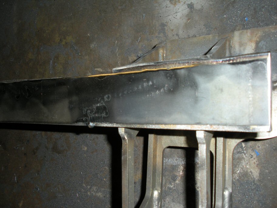

Just an update on my trials/tribulations,
Although ATV was fair in refunding part of my purchase price,
the request was before I realized that the replacement lower rail is
almost 4" shorter than the original lower rail that they sent me. I'm
scrambling trying to find filler end pieces. All this nonsense, time, money
and aggravation to save $50-$75 in shipping charges, BUT more importantly,
a hand in building my JD FL attachment. Again, NONE of my fiasco has
anything to do with Chris Perry or his frames. Caveat, as much as I try,
I now have poor up-close vision and makes welding difficult. I used to have Turkey-like
vision, so it's very difficult. Attached are updated pics.

   / Lightweight pallet forks for 200X & 200CX loader #129

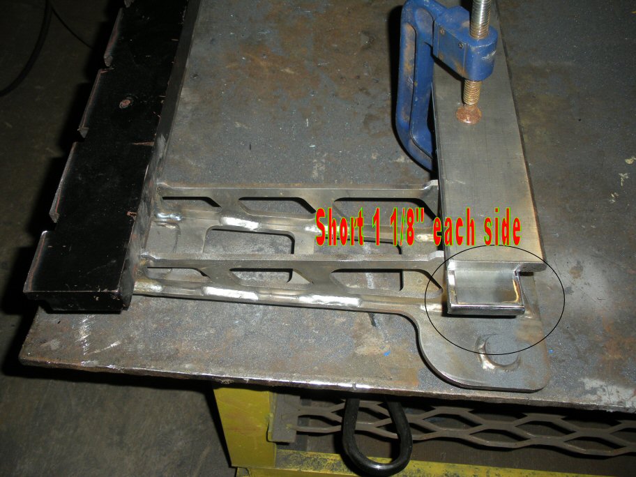

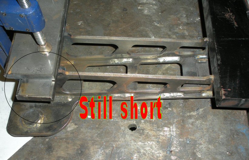

Yer gettin' there, rcbsaver!!
Chris is the engineer, so you might verify this with him, but that lower rail that's short on each end (see your photo below) only has to withstand straight rearward pressure from the backside of the lower part of the forks under load--it has no hanging or twisting loads applied. I'd cut a couple of filler pieces to fit and weld them in, grind them level, and not worry about it. Besides, your rails are going to end up being twice as thick as normal anyway. If you ever manage to bend anything it ain't gonna be those rails!

   / Lightweight pallet forks for 200X & 200CX loader #130
Picker,
Perhaps I wasn't clear, but it CERTAINLY is my intention to fill in the ends.
The problem is, I don't have any matching stock laying around, and thus it
is NOT filled in. Another WRONG assumption I made, when I contacted ATV with
this fiasco was that they would send me a replacement bar that was the same length
as the first errant ones (in thickness) that they sent. I'm going to email Bill @ ATV tonight for help with the steel filler ends.
Yes, you are partially correct in that, the upper bar holds most of the torque and weight. However, once you lift with the forks, any tilt UP of the forks will pull outward against the lower rail.
I'm NOT worried about any bending. My concerns are separation. As I explained to Chris, I picture my current frame set up as an Oreo Cookie. The original ATV lower rail was securely welded to Chris' Frame. Before, I could add the "new, shorter" bottom rail, I had to grind back those welds, The "new, shorter" rail was "for the most part" welded to the original rail. I did weld it to Chris original truss frames at the ends, where possible. Again,
not worried about bending.
Proof comes tomorrow when I MUST use the frame as is to unload 1 ton (50 x 40 lb bags)
of "Equine Fresh Pellet Bedding" from Tractor Supply, then I have to Pick Up a 260 lb pallet
of Spray foam insulation, which my wife can't handle for Mon. delivery. Pics to follow.
Nothing glamorous yet, but just wait until my Deere has her 46 longs attached in blazing glory! LOL
