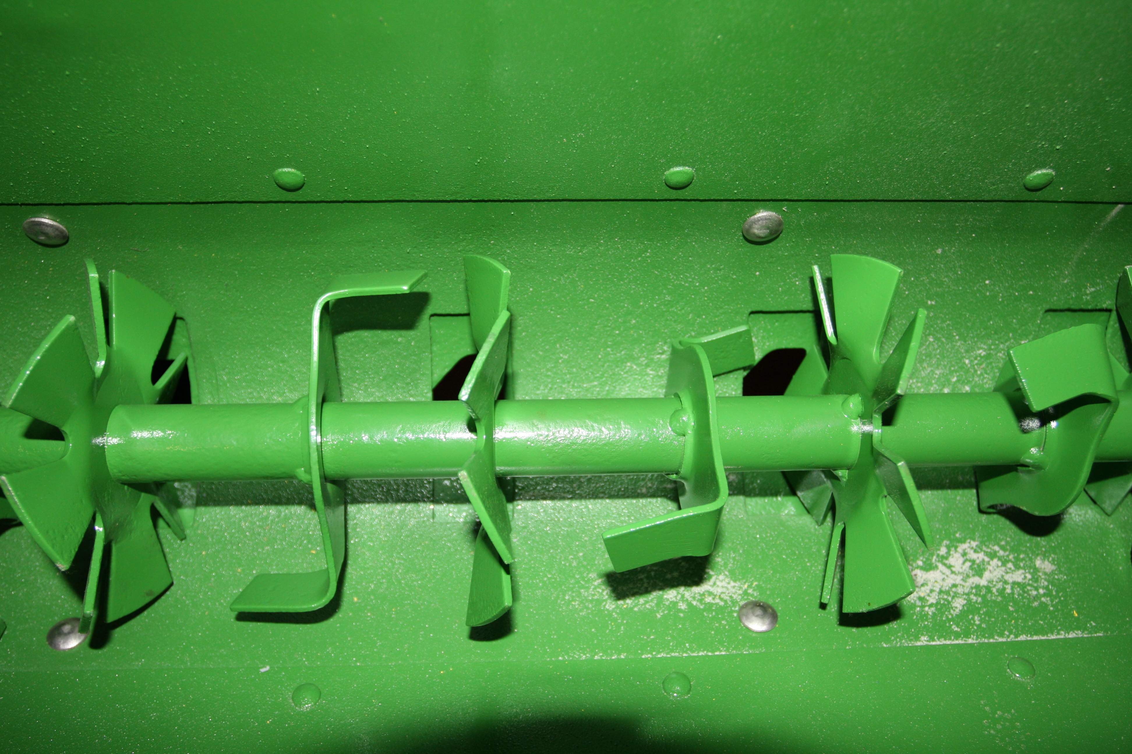

Hi dgallow. I sent you a email. Hey, you can buy mine. I decided to sell it as I just don't need it. I don't have a good source of Ag lime around here. I have not used it since I restored it.
One thought, for a 12 footer, I would be a little afraid of the torque an agressive "beater" puts on the ratchet case (the outside drum that holds the shaft and engages the shaft when the wheels roll) When I was restoring mine, I found that on several of the used ones I found, the cast iron ratchet case had been broken and repaired. I assume when the beaters engage a hard lump of lime or a misplaced rock, they lock up. This transfers lots of rotational torque to the ratchet case and breaks it. i saw that fracture on most old ones I found. It seems the longer the shaft, the more the pressure and force. So if you make a new shaft, be a little careful not to make it too agressive. Just a thought I had.
I will post some more pictures, and will help in any way I can.

On your unit are the fan shaped beaters the ones over the drop holes or is it the scrapers (90 degree bent pieces)? If I weld in fan shaped beaters over the drops that should work. The rods should suffice as scrapers/mixers but won't move material laterally like the true scrapers which are staggered around the lime/fert shaft.

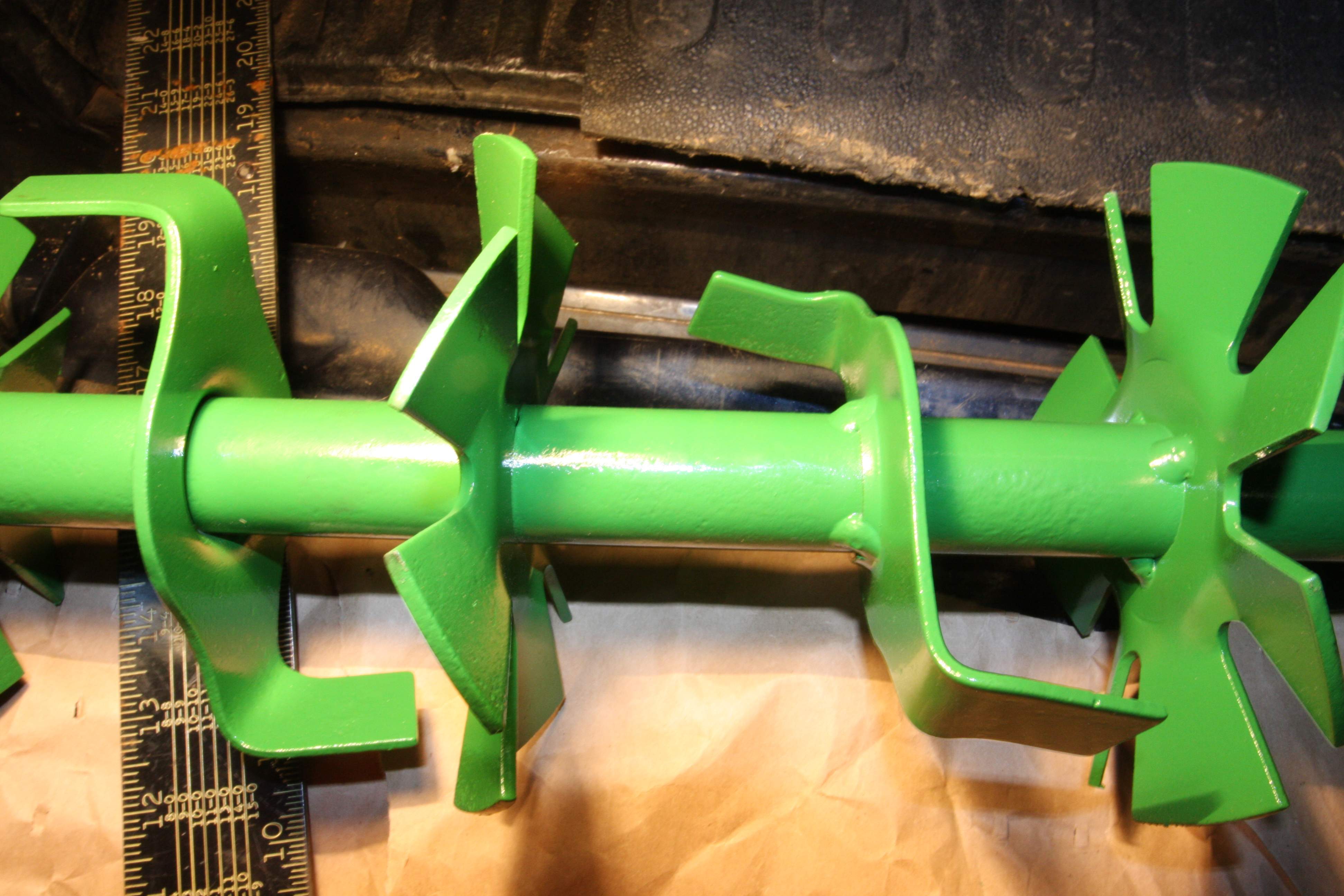

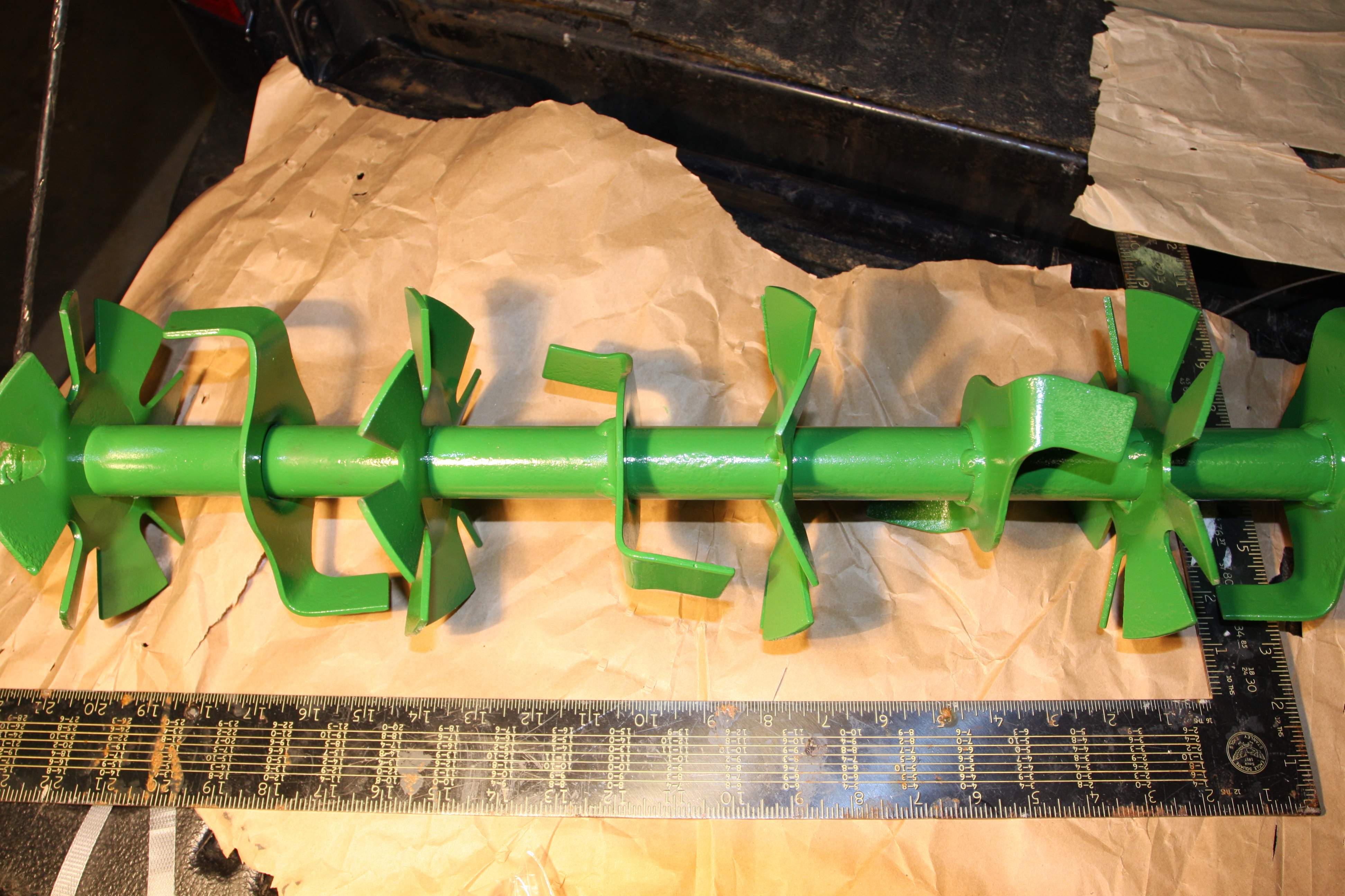

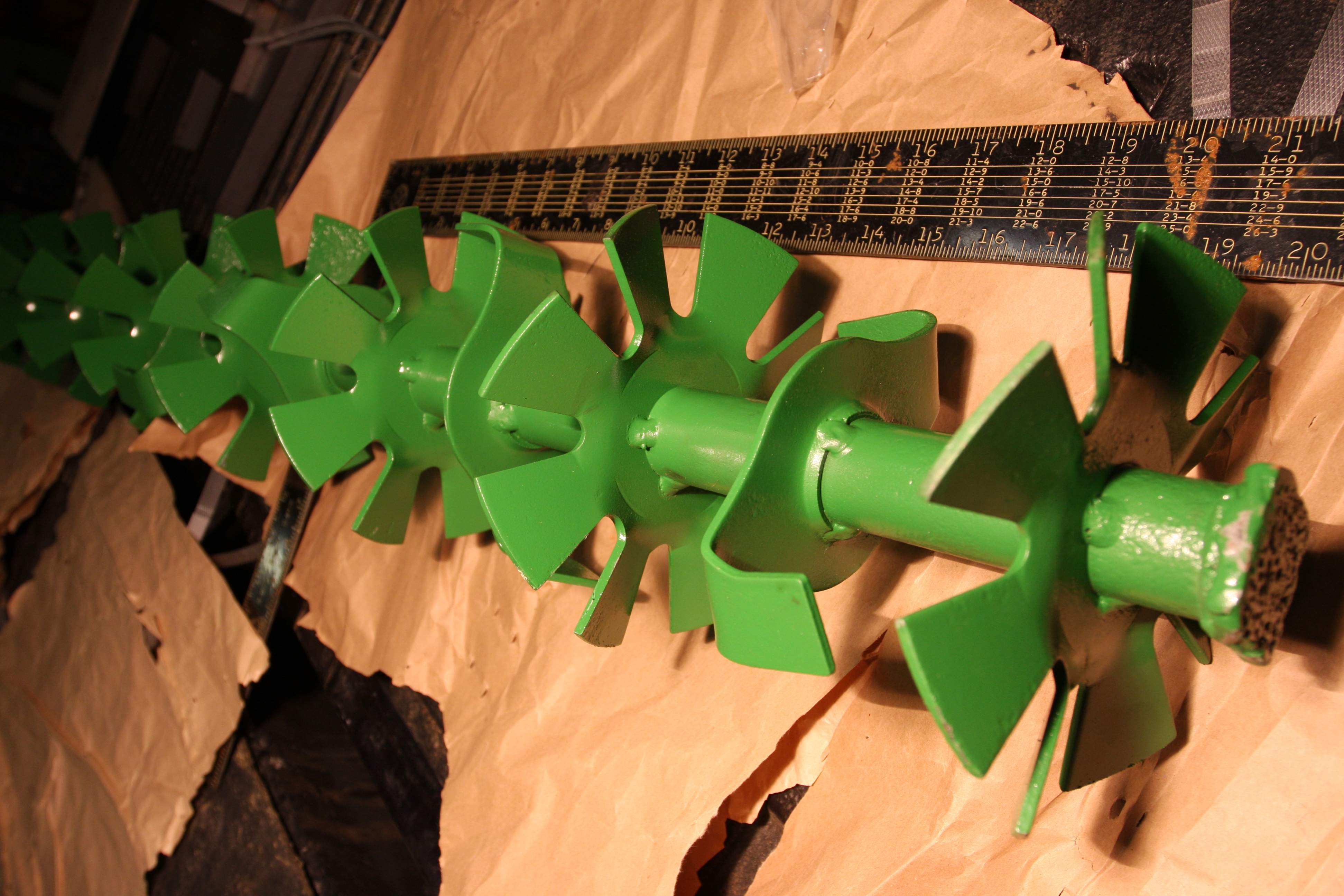

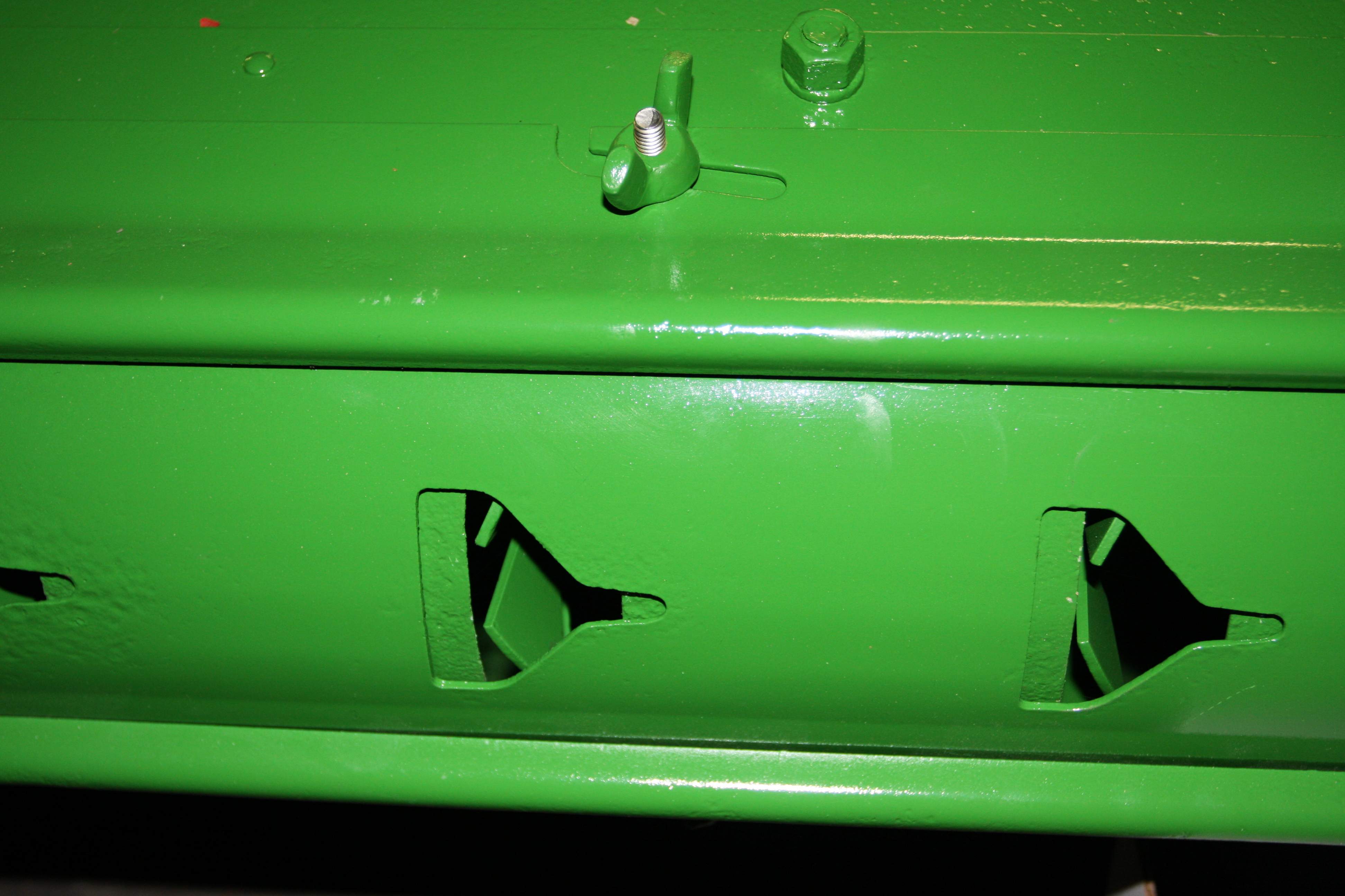

Here are some pictures. The flat "chopper" is above the space between the holes, and the fan shaped "distributor" is directly over the holes. Metal is about 1/8" thick. Hope that helps.
