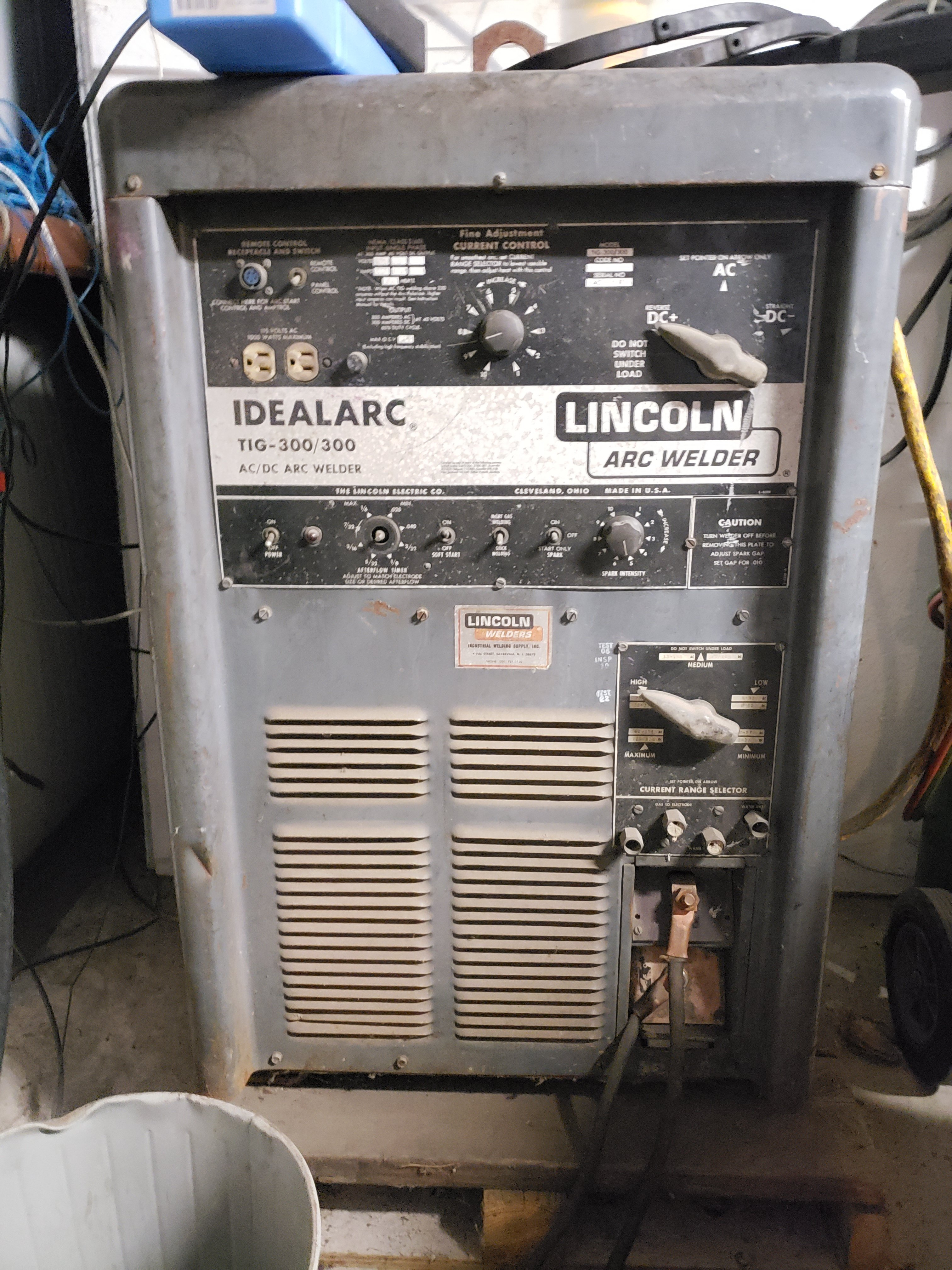

I have Tig 300 and I can't get a arc at low voltage. Have to have Voltage on high to get arc on steel, and it just blows hole through 1/8 inch aluminum. And should the torch be on negative? I know with newer machines the torch goes on negative, but the manual for this one says to put it on electrode and that just melts the tungsten on DC+, works better set on DC-.
