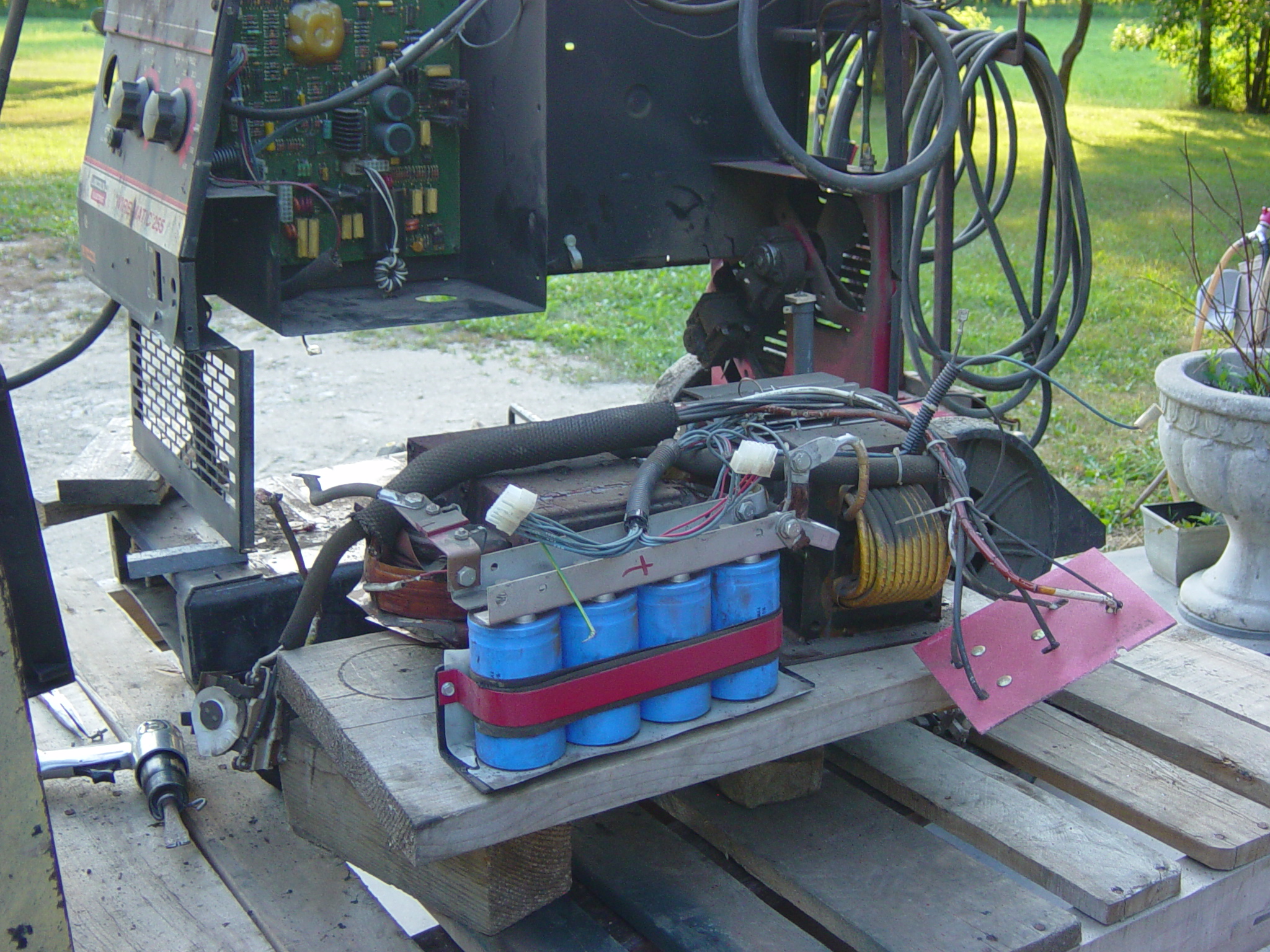

My little Lincoln MIG, I had it for years, developed a problem. Pulling the trigger, the wire moves out of the gun but the welder makes loud noise and eventually - in 3 or so seconds - it will pop the outlet breaker.
Not while welding, just to get the wire rolling. I took the wire handling apart and the transmission is operating smoothly, the motor spins easily with fingers but it still pops the breaker. I suspect the wire feed motor got a short???
Ideas, anybody?

I would suspect the contactor first, since the machine idles without tripping and it does feed wire.
   / Lincoln troubles #3
Never seen a worn contactor (welder or otherwise) blow an overcurrent device.
Sounds like a short. Maybe even shorted transformer windings. Does it smell burned? Is the Transformer crispy? How old, how much use? Does it always do that or only sometimes?

Maybe a shorted rectifier. Probably more likely than the transformer.
   / Lincoln troubles #8
Disconnect capacitors & repeat gun off test.

The motor checks out, spins nicely. By the sound of the welder - without the motor and shorting the gun contacts - it sounds like a relay switching on and having too much resistance.

The problem is not the motor. If the unit is back together, plugged in and power on, but not wire feeding, does it still trip the breaker? Of can it set there running, until you activate the feed trigger?
Have you swapped out the breaker, just to make sure it is not a bad (weak) one? My friend just down the road, had this happen to him just a few weeks ago. Breaker looked good, it switched on and off as felt normal, but it was bad. Voltage coming out was very low. Have you measured the A/C voltage at the welding receptacle (or at the breaker) while the welder is plugged in and powered on in standby? Or are you reading a significantly low voltage?
If none of this helps, I would troubleshoot the high-current DC power supply in the machine. Most likely it is a shorted filter capacitor, or high-current diode. Those are both inexpensive to replace. If you do not have the skills to do that, do you know anyone in the electrical or electronics repair biz (TV repair tech), or a ham radio operator? They would likely be able to help.

I narrowed it down to diodes. Two out of four don't check out by the meter, so I need to find M9661 - 40RU and M9661 - 40U. Of course they are on the heat sink deep inside the welder, but it's good to make a progress.
