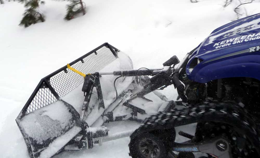

I agree with most of the comments here and we've been using 12volt linear actuators on snow machines for many years. When you are shopping for one, its speed and power will be noted in the specs.
On this plow, is 6 of them.

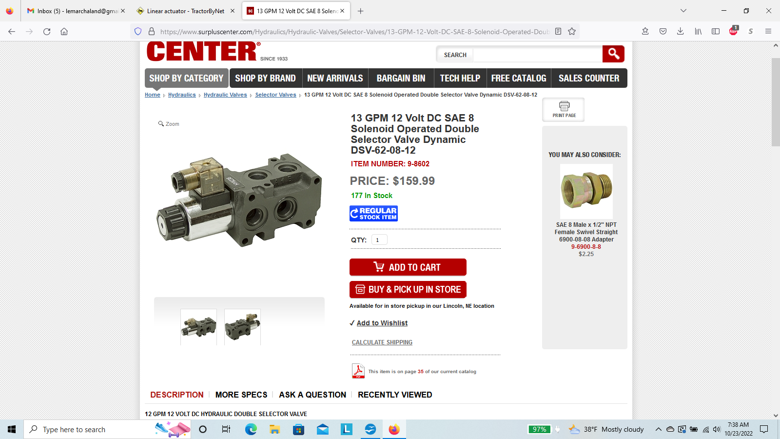

When I bought my blower it had the same setup (hydraulic rotator and manual chute deflector). I didn't want a linear actuator because of the slow speed. Instead I bought a 12v solenoid operated double selector hydraulic valve with an on-on switch placed in the cab. I have been very happy with the speed of the deflector and the lack of maintenance required. It is a very robust system.
