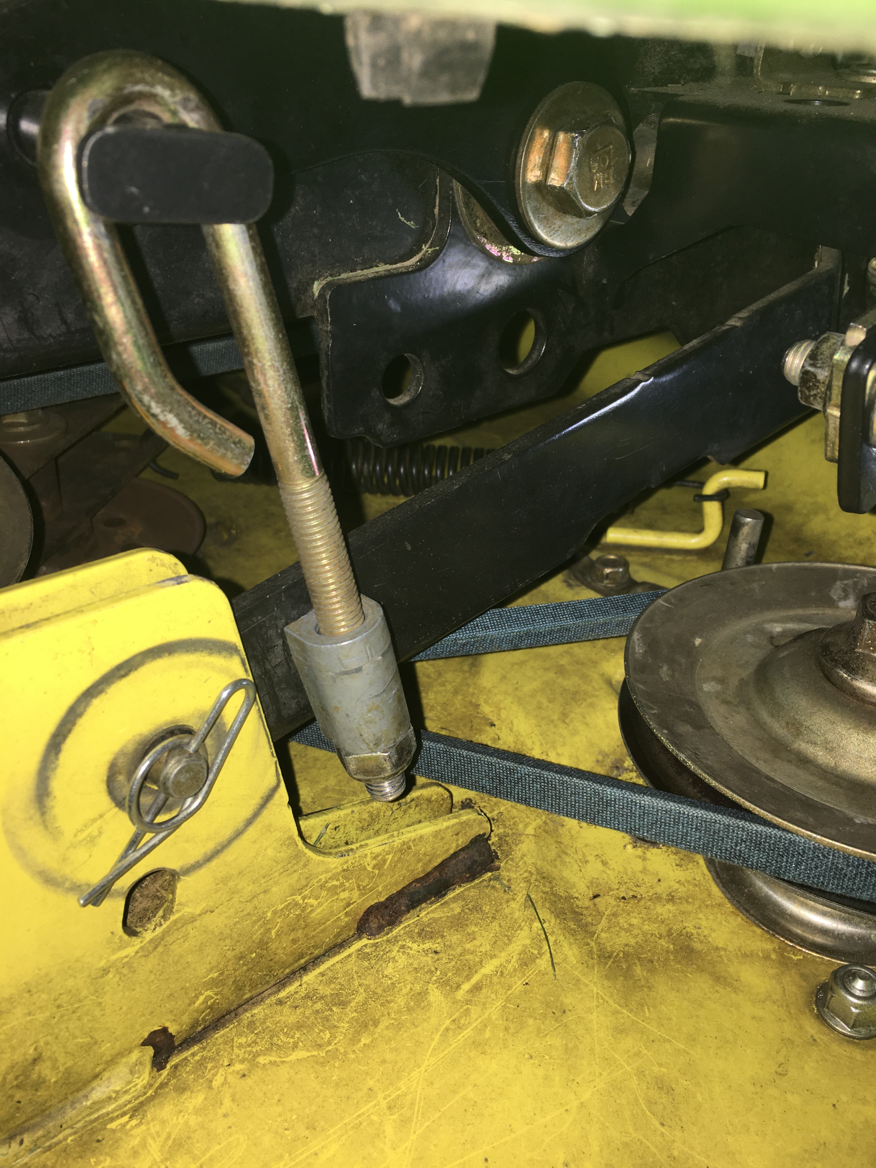

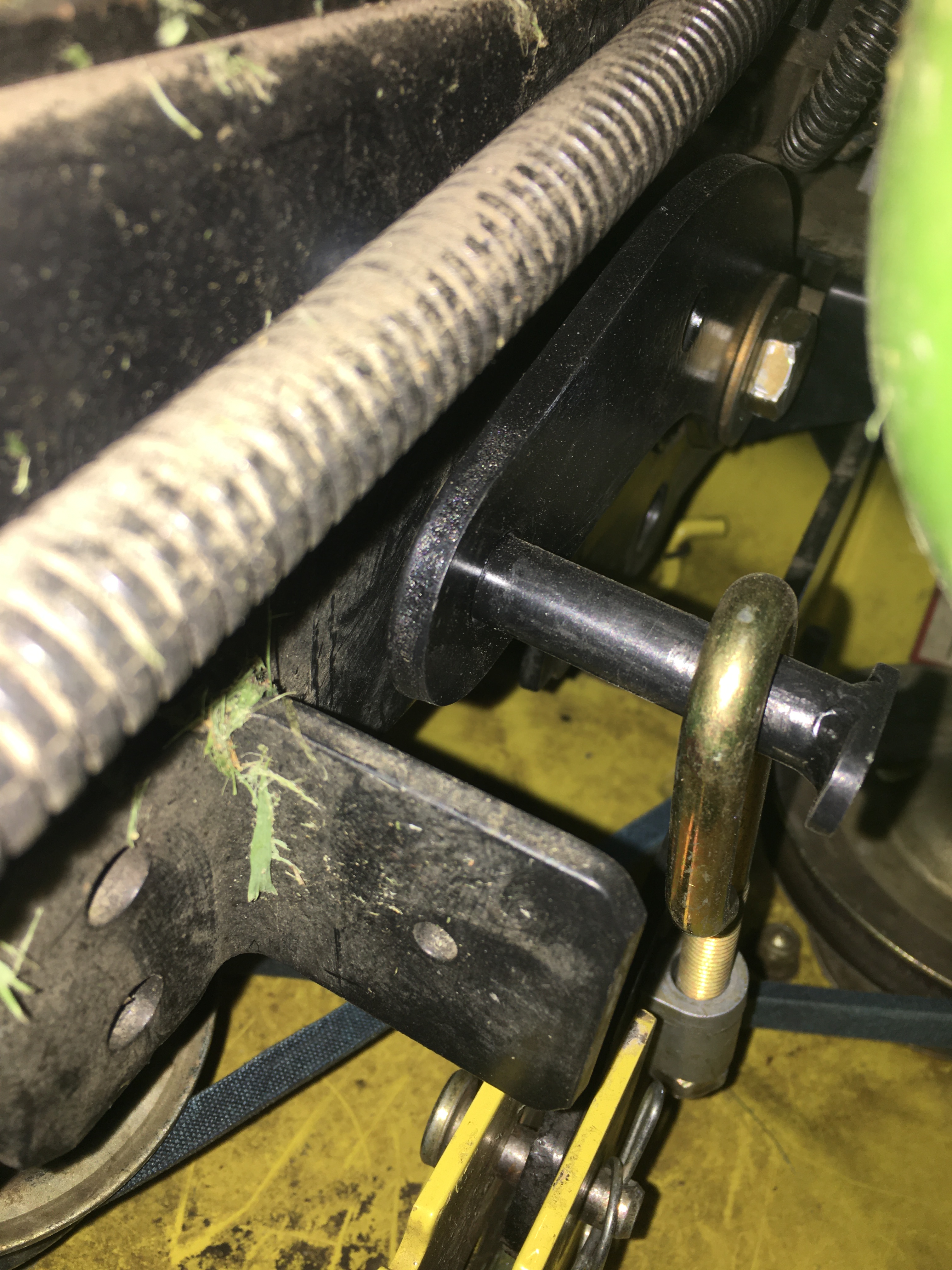

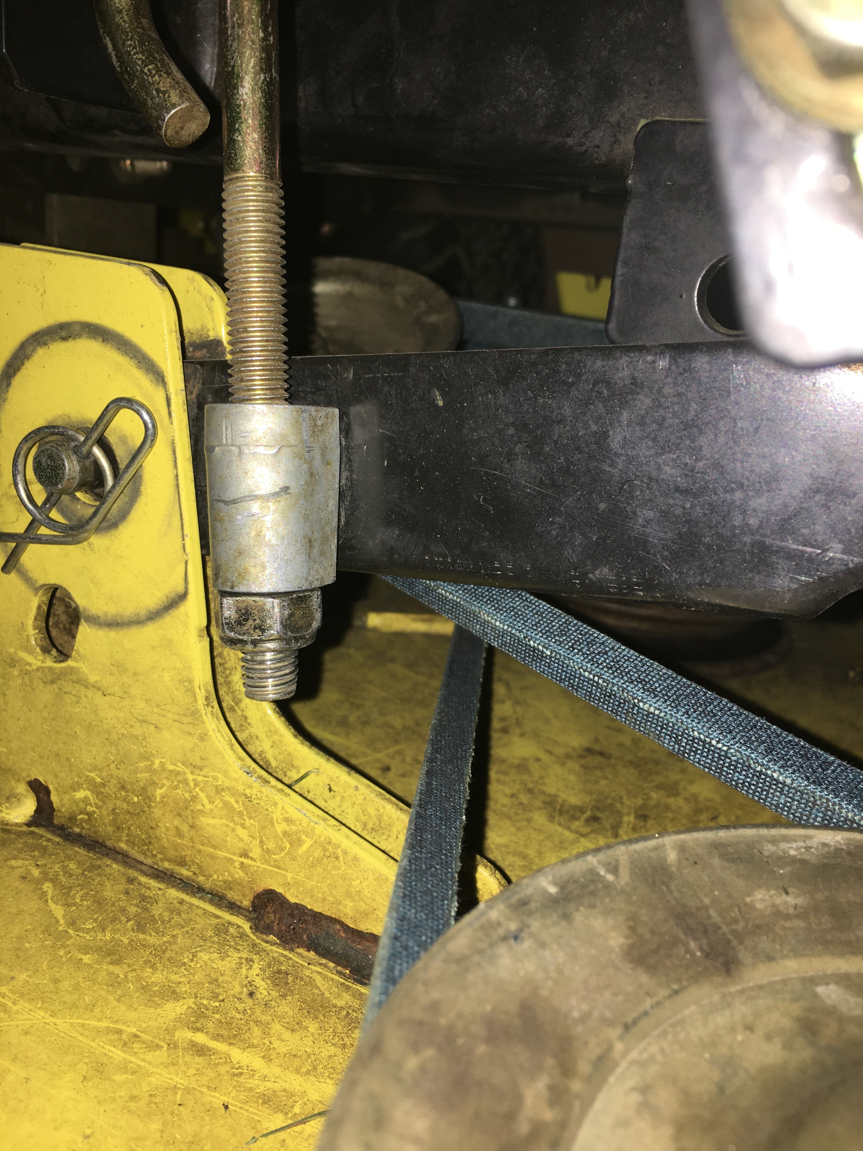

I had a problem with my X300 mower deck belt breaking, so rather than cut the threads shorter on the adjusting rod, I installed the bracket on the outside. It's currently installed on the inside and it's too close to the belt. This is the grass shoot side of the mower deck.
I removed the bracket, ground the weld and removed the existing pin, and welded on a new (longer) pin to the bracket, and reassembled. This allowed the threaded adjusting rod to be installed on the outside of the bracket, nowhere near the belt. Works great now. all I used was 1/2" dia rod x 2" long and a small piece of flat bar 1-1/8 long x 1/2 wide x 1/8 thick. I attached pics. Now I use a $20 kevlar belt from Ebay with no problems.
   / link belt on x300 mower deck and pto clutch operation?
#15
I will look again but I could not find anything in the way. I have had the deck off many many times now. there are now adjustment bolts coming close. I can't figure it out. there's a bit of slop in the tensioner arm. im probably getting ready to either buy a new deck or a new mower.
View attachment 654572View attachment 654573View attachment 654574View attachment 654575

well I needed to mow and didn't have any more belts until I order more. I took the deck off. I re-bent the idler pulley so that it looked to line up with the other pulley a bit better. As others suggested I installed the lift arms on the OUTSIDE of the deck housing slot instead of where its supposed to go to allow for more bolt clearance. I Also reworked the governor and throttle assembly so that it almost stalls at idle when I engage pto to limit as much jolt as possible. I also reinstalled the link belt and retensioned. I just mowed some and it worked quite well....I just don't know how long it will be before something goes wrong again. the only bad thing about link belt is the potential slip in very deep or wet thick grass...otherwise it operates quite smoothly.....I will keep you posted
