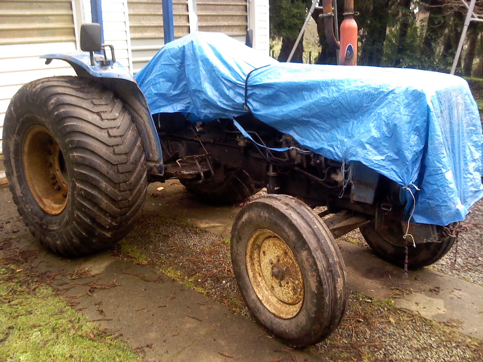

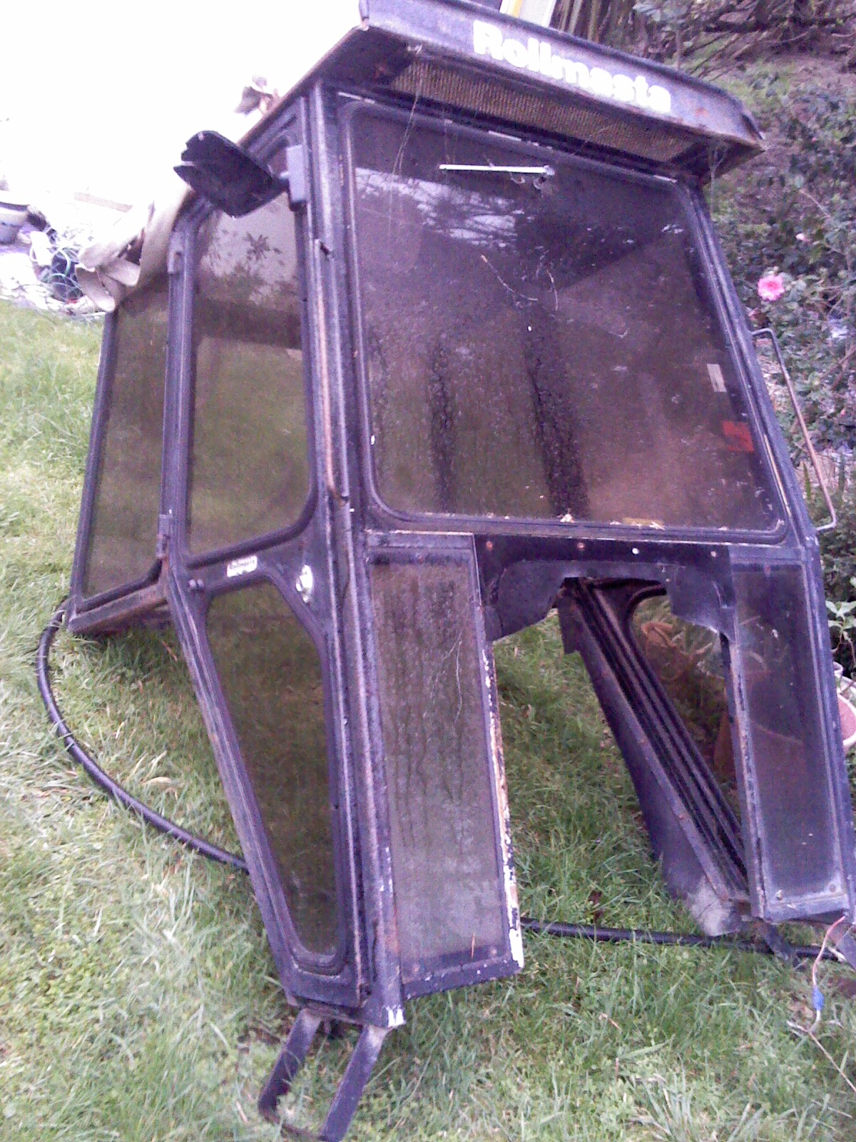

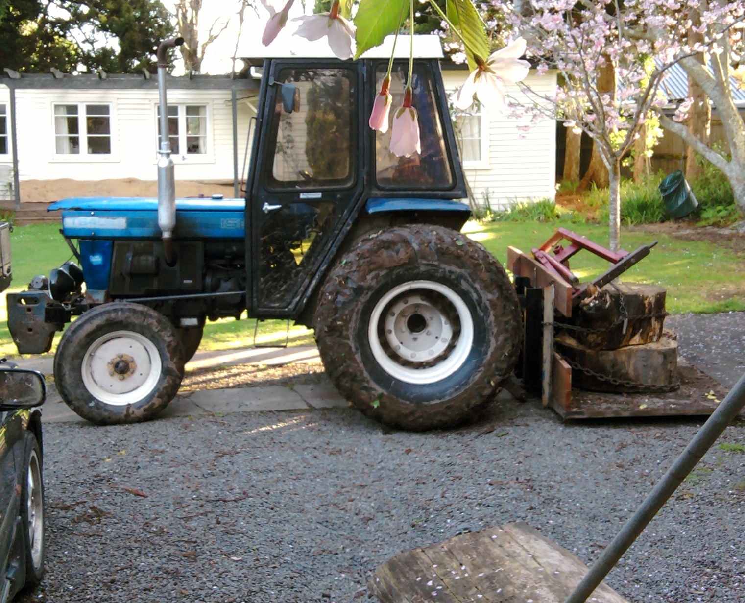

Well its coming on to summer this side of th Pacific. I read your article and echo the compliments of my priors on your build and particularly your literary skill! In fact it was motivational. I did a similar job but 'scored' a touchdown with a second hand engineered cab for a fair price on account of the armourplate glass being worth $$thousands$$ here & I need it for safety with tree work.It was designed for an IHI of some sort and All that needed doing was position the crate & create some mounts. Quickly discovered the roll bar could stay if cut & rewelded(I'm certed for arc),so done and MIGed it to mimick the rear cab frame angle is unnoticeable.Other benefits are built in roof mounted fan and front filtered intake and very importantly a windscreen wiper. I'll take a leaf from your book for the headlining as the foam remaining up there rains down on my hat at present. should serve to silence the inherent acoustics. I'll try to load a couple of pics for interested persons. And I Thank You for the motivation to tackle it myself and some nuggets of inspiration provided by your instructional account of your own venture.
