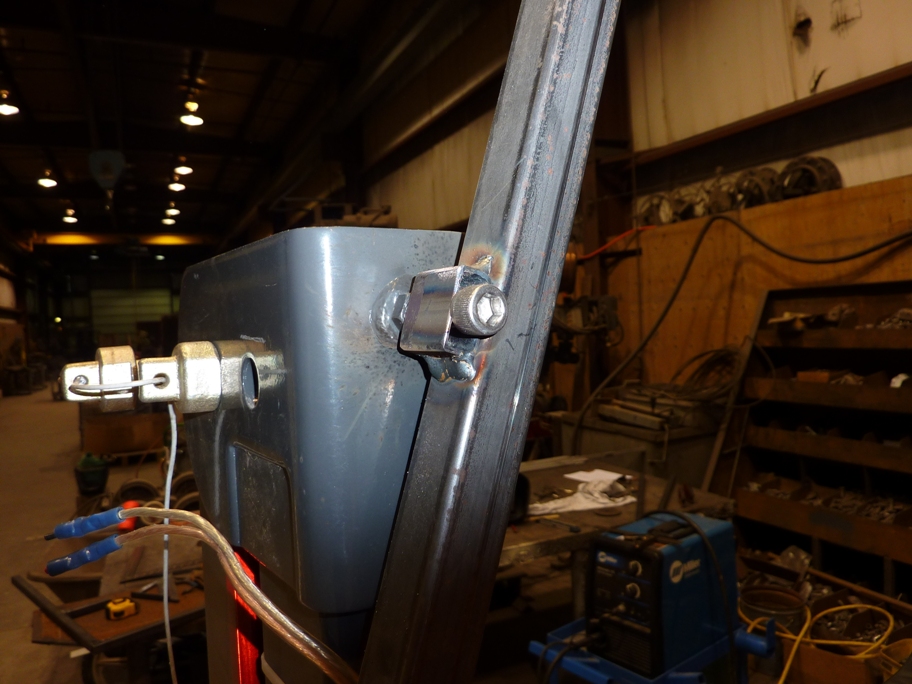

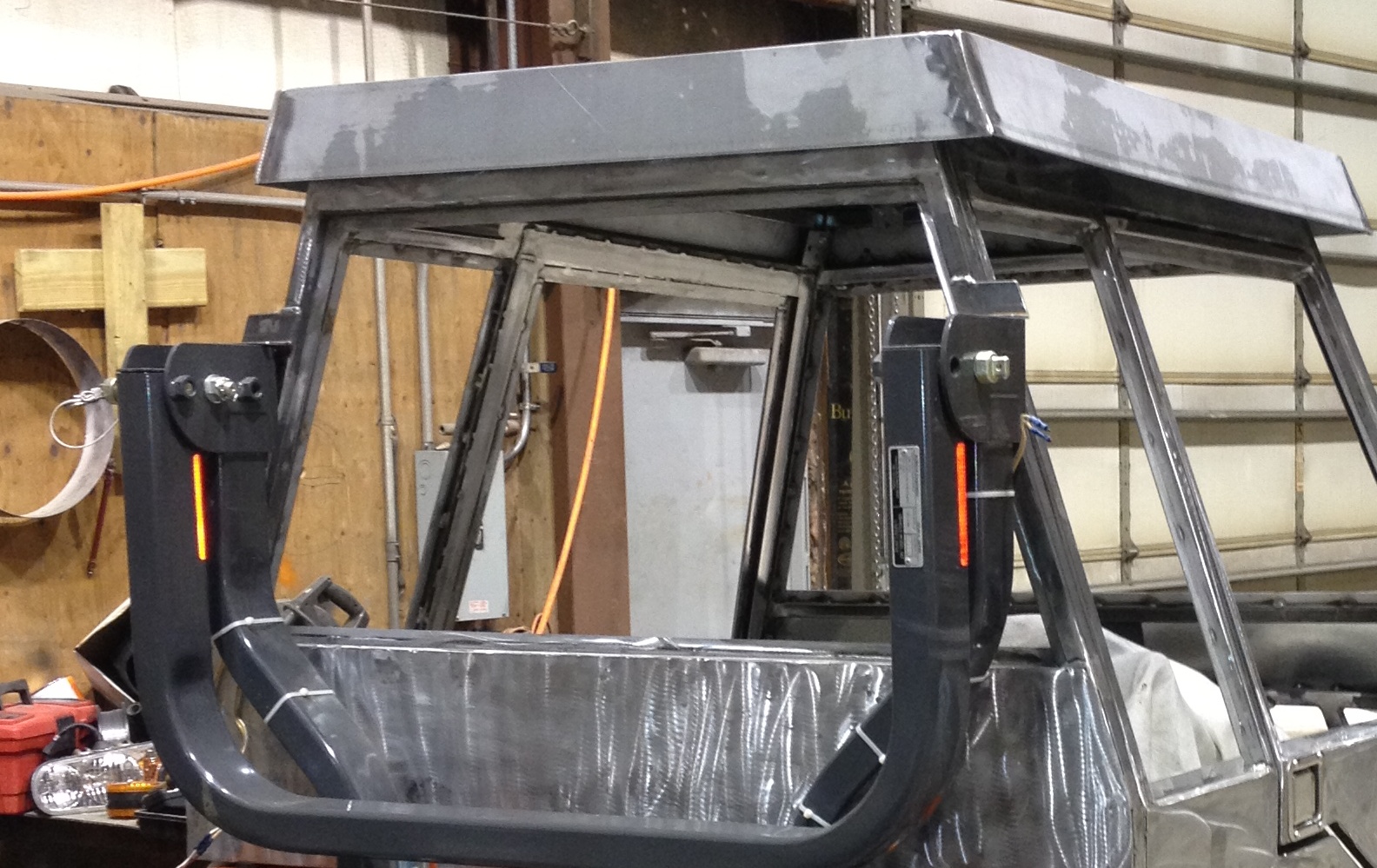

Roy's site was one of the most helpful and informative places I found when doing lots of seaching befor talking my cab. I had a B-Series for 10 years and never gathered the courage to attempt a cab while I owned it. So attachemnt details were something I didn't check for. If it's any help here are the main attachment points I used on the L-Series.
Excuse the folded-down ROPS. It won't make it in the shed with it up. The FEL joystick support worked great on the right side, so I made a mirror image of it for the left side. On the rear, I drilled out the threads and through bolted it. The weight is carried by two small clip angles welded to the rear cab frame and they just rest on the ROPS stub. These don't show in the first pic because it was taken earlier in the build. I used 1x1x12Ga tube for the main framing. Since the cab is made in sections the tube is doubled up / bolted in parallel in most places.

Thanks Chim. After I posted I went back and took a look at your thread. I have the same threaded nut welded to the ROPS from the factory. That looks like a good way to go. I'll just use the same threaded bolt instead of drilling it out because I want the ROPS up. I also noted you attached on the fender where the light had been. I think I'll do that as well after adding some additional support on the fender bracket. You did a nice job on your cab.

I think that's a good way to go. To help carry the weight on the back side you could make up the fastening point at that nut so there would be a piece of steel drilled to fit over the nut, and then run the bolt into the threads. I'm guessing the welded on nut will provide more support than the metric bolt that will go into it. Another possibility is running a tab back alongside the ROPS hinge and using a hefty bolt through an unused hole.
The bolts through the fenders were put there more for making sure they stayed clear of the cab frame. I expected - but haven't seen - some flexing and didn't want the fender's paint to get scratched off.
