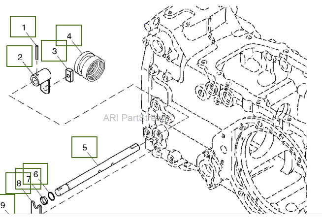

Hi Everyone,
I have a John Deere 110 TLB that is stuck in 4wd. The knob for moving in and out of 4wd is super loose and feels like its not connected to anything. Underneath the tractor I found that the shaft that goes into the transfer case and attached to the linkage is broken. After looking at the parts diagram I initially thought I could just pull out the shaft and put in the new one. After looking at the diagram some more I saw that the end of the shaft that is inside of the transfer case is attached to the shift actuator with a roll pin and just can't be easily pulled out. Does anyone know if it is possible to get to that roll pin by removing the PTO off of the top of the transfer case or does the tractor have to be split to access the pin?
Attached is the parts diagram, the broken shaft is #5 and the part connected to it with the roll pin is #2.
Thanks for the help!!!

I am guessing you mean the rockshaft, not PTO, off the transaxle case.
Still guessing, but I think you will find the counter shaft and gears that are above it would be in the way.
I think you need to o a split.

Hi Jtag The picture of transmission looks very close to my 4520 Reverser.
The lever to engage or disconnect became loose. and locked into 4Whl. position so your description about the same also.
the flywheel housing to transmission needs to be separated. on mine the part #3 had not been installed properly and wear allowed it to jump out of the guide to slide the shaft into engage and stay.
The little part #3 must of been made of gold about 3/4th x3/8th thick with a hole drilled in middle and the shaft is inset into the hole. the cost is 2 men 8 hours each to separate and put in a new called(shifter shaft selector) and costs 54 bucks.
Used to own a Gravely garden tractor. and the part is very close to this. 2 bucks.
If you are familiar with John Deere tractor repair and have help not impossible to do your self.

I went to the local John Deere dealer today to order a manual and talk to their service department. The Service Tech. told me the tractor has to be split and he estimated between 20-25 hours to do the job.

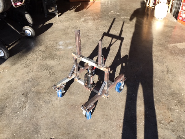

I received the manual a few days ago and have been reading through the section on how to split the rear section of the tractor and I'm going to go for it once I mow the field for the last time this year. In the meantime I am going to fabricate stands for securely holding the tractor halves when they are split. There are a few good designs out there I found that look fairly easy to fabricate.

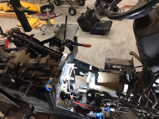

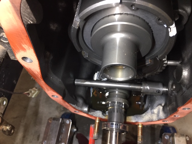

I finally got around to splitting the tractor. I split it, installed the new shaft and put it back together. Everything seems to be working fine except that the rockshaft is not moving up. It is all of the way down and I can easily lift it up. The loader moves up and down as it should and the power steering is working fine. Did I mess something up internally when I had the tractor apart? I know there is a switch that is depressed on the rear of the tractor when the backhoe is installed to keep the rockshaft from moving and it is fully extended (not depressed).
Any ideas on what to check? Do I need to bleed the hydraulic system?
