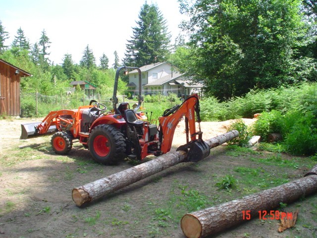

Given the list you have provided and the smallish size of your property I think renting would be cheaper. It is nice to have one and I have gotten lots of use out of my Kioti CK35 with Woods 7 ft backhoe, have 14 acres and lots of uses for it.

Notice his picture with the mechanical thumb ....... with that you'll never have to drag brush again.
Grab it ..... pick it up ..... take it where you want it and drop it off.
Certainly has made my life easier.
