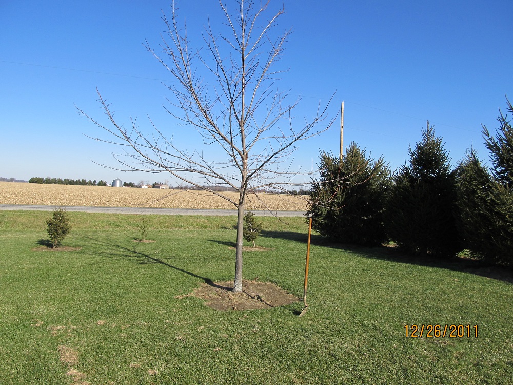

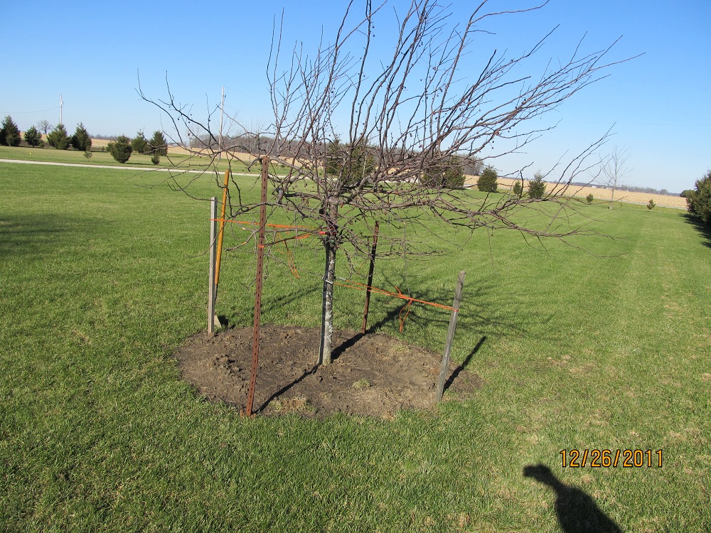

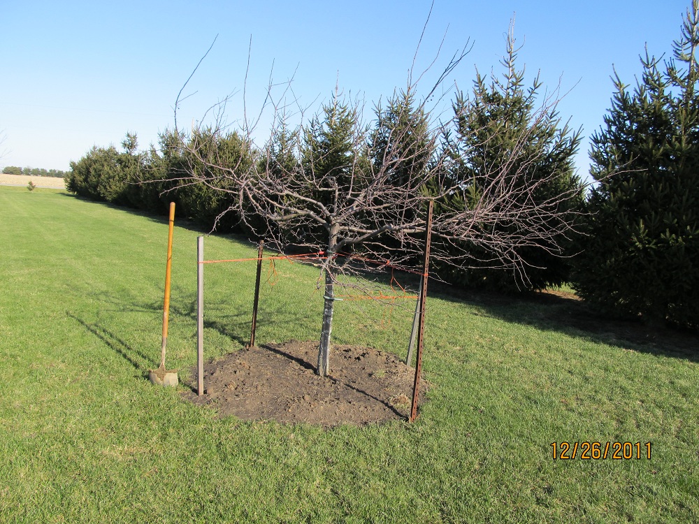

You can certainly dig holes for new trees, however, in my limited experience a small BH does not work very well to remove trees for replanting. For me, anyway, it is almost impossible to scoop the tree and root system in one bucket pass, without mangling the tree or the root system...
I use my JD790 TLB all the time to dig trees for transplant and I found a method that works very well. I start by digging a square around the tree, very much like a footing for a house. The inside dimension will be a square and no bigger than the width of my bucket on the loader tractor I want to use for transplant. If I'm using my JD790, it's 4' by 4'. I dig down maybe a foot and a half or below the root line. When I'm done digging ,the tree will be on an "island" of dirt. Then I push the bucket in and just try to push the edge against the bottom of the tree-hole on one side, and then the other. When the tree looks loose, I scoop it up and put in the new hole. is not exactly smooth in that you still rip a few roots but it works surprisingly well.
For bigger trees, after I'm done digging all around the base of the tree and below the rootline, I scoop out an entrance "ramp" on one side so I can get my bigger bucket in there.When transplanting any tree I dig a bigger hole than needed and after thee tree is in, fill it half or 3/4 full of soft dirt and then fill the hole with maybe 30gallons of water to make a soupy mess that makes complete root contact. Then I fill the hole with more soft dirt, add more water and stake the tree.
Here are two that I did recently. There is a shovel in the photo for comparison. The flowering cherry I did a few weeks ago by digging maybe two feet all around the tree as described. It was maybe 5' by 5' and i dug a small entrance ramp on one side to get my JD5520 bucket in. I dug my transplant hole oversize and probably scooped out an 800 to1000 lb rootball with the tree. I had to make the tree fit correctly in the hole and did the soft dirt and water thing--maybe 70 gallons. Then I staked it and it's not going anywhere. I probably wouldn't have had to stake it since I got a good rootball.
The maple tree in the photo was done last fall and you can see is a big tree. Maybe 15-17? ft. Same drill, dug completely around with my JD790 and scooped out with the bigger tractor. I did prune pretty heavy and will likely prune the cherry by 1/3 or more in the spring. Digging this way is more work but it allows me to get an excellent larger tree transplant and far less violent transplant. I have probably done 30 this way.
My little backhoe gets used 50 hours a year but I could not get by without it.
