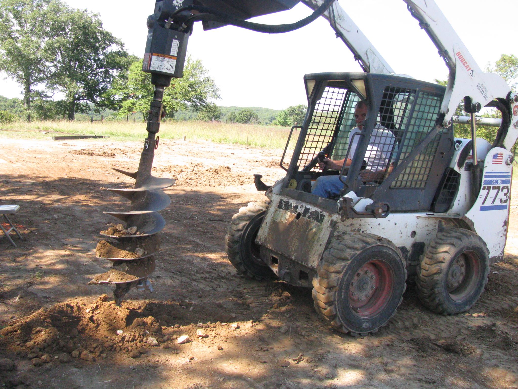

Well forget the "bell" :laughing:
I knew I was going to get in to rock but Hole ly COW:laughing:
I ended up with a 18" auger cuz that's all they had but I was ok with that.
I was very lucky to get through this rock today. Broke a couple of teath off the auger at some point. :confused2:
I got my 36" down and then some. :thumbsup: more like 48" in the corners. :cool:

36" seems pretty unreasonable. Takes a dang big shed to need it that big.
Here we don't fill the entire hole with crete, just the bottom thus making a "bell". Most don't even do that much. They just set the post on a cookie.
This is a 40'x100' steel building so it aint much of a "shed"
