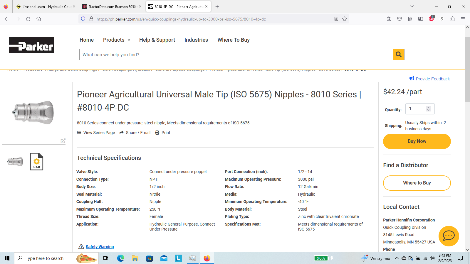

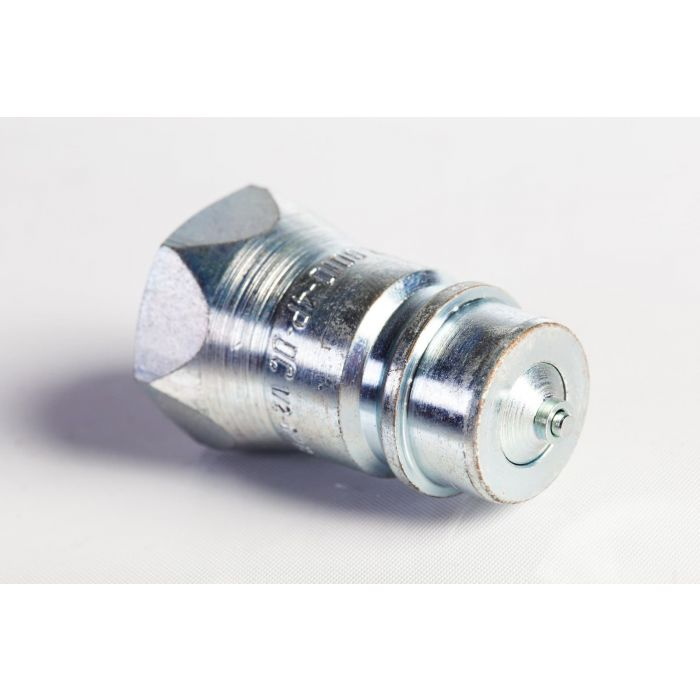

   / Live and Learn - Hydraulic Couplers #7
I'll stay with the "ag" or Pioneer style, diversity can kiss my ____.
I do use mostly the pressure relieving style male connectors;
That little poppet valve in the tip will help relieve pressure and make them easier to connect.
