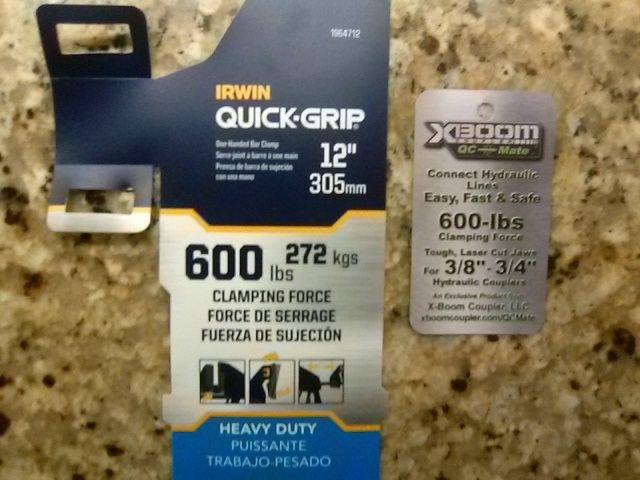

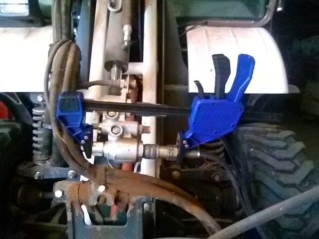

I have flat face couplers and this tool:
Lined up straight:
Latched:
Also use it to couple the connectors when the attachment is removed:
And the Xboom Thread: Front-End Loader - Flat Face Hydraulic QC

Several of the tools used to connect flatface connectors under pressure or relive pressure without having to loosen a fitting.
   / Live and Learn - Hydraulic Couplers #20
I would find it annoying to have to carry around a tool to connect and disconnect couplers. Good idea for older guys or weaker hands trying to force flat face couplers together, but easy to lose in the field.

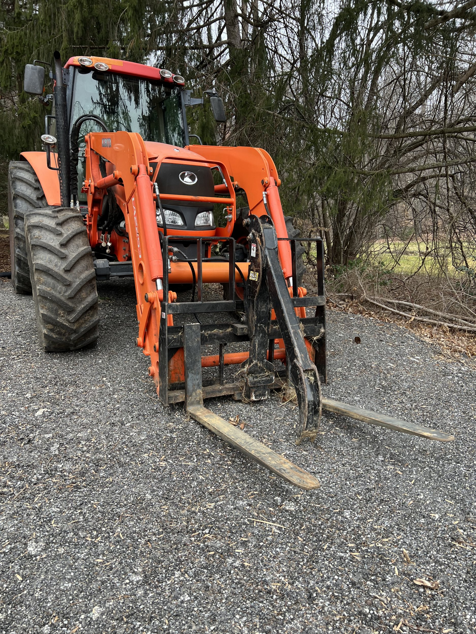

Tried flat face, but didn’t get what all the excitement was about. Will be removing them from my HLA log grapple and snow plow as soon as the last Kubota with FF runs down the road in March.
