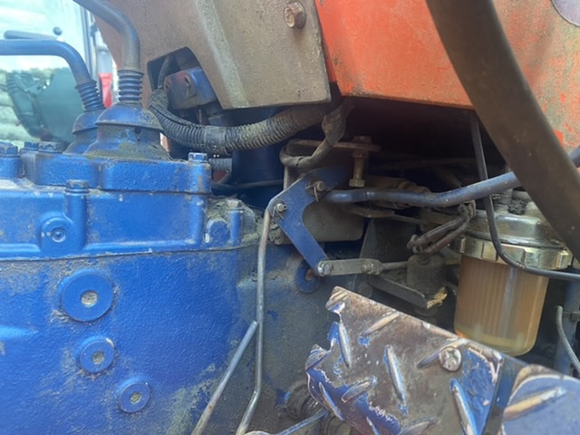

Is this what you wanted?
   / LK3054 accelerator lever question #12
I see that the linkage from the "C" plate to the foot pedal is orientated differently between your tractors. Not sure if that would make a difference.
   / LK3054 accelerator lever question #13
Good point but I do not believe it matters. If the spring not engaging the petal is a concern for him he probably could tighten the nut on the foot petal and it would twist the spring up some. At least I think it would. Persanal it would not bother me because normally you would use the hand throttle to bring it up to 1200 or so RPMs anyway then use the foot petal. By then the spring would be engaged.

The issue was that while using the back hoe, the most i could get out of the engine was 1800 RPM (the 540 PTO RPM is listed at 2600 RPM). I ended up extending that linkage to push the C plate down and I tightened the throttle lever screw to give it some more friction to hold it. The RPMs would hold around 2100 which was enough to use the backhoe with good power/response. Thanks K5lwq for the quick replies.
#15
On a side note, here is the mockup i had in my mind of how i would get the throttle lever to be in the right spot (either welding such a piece on or bending the lever until a similar spot:
That picture is before I extended out the linkage.
