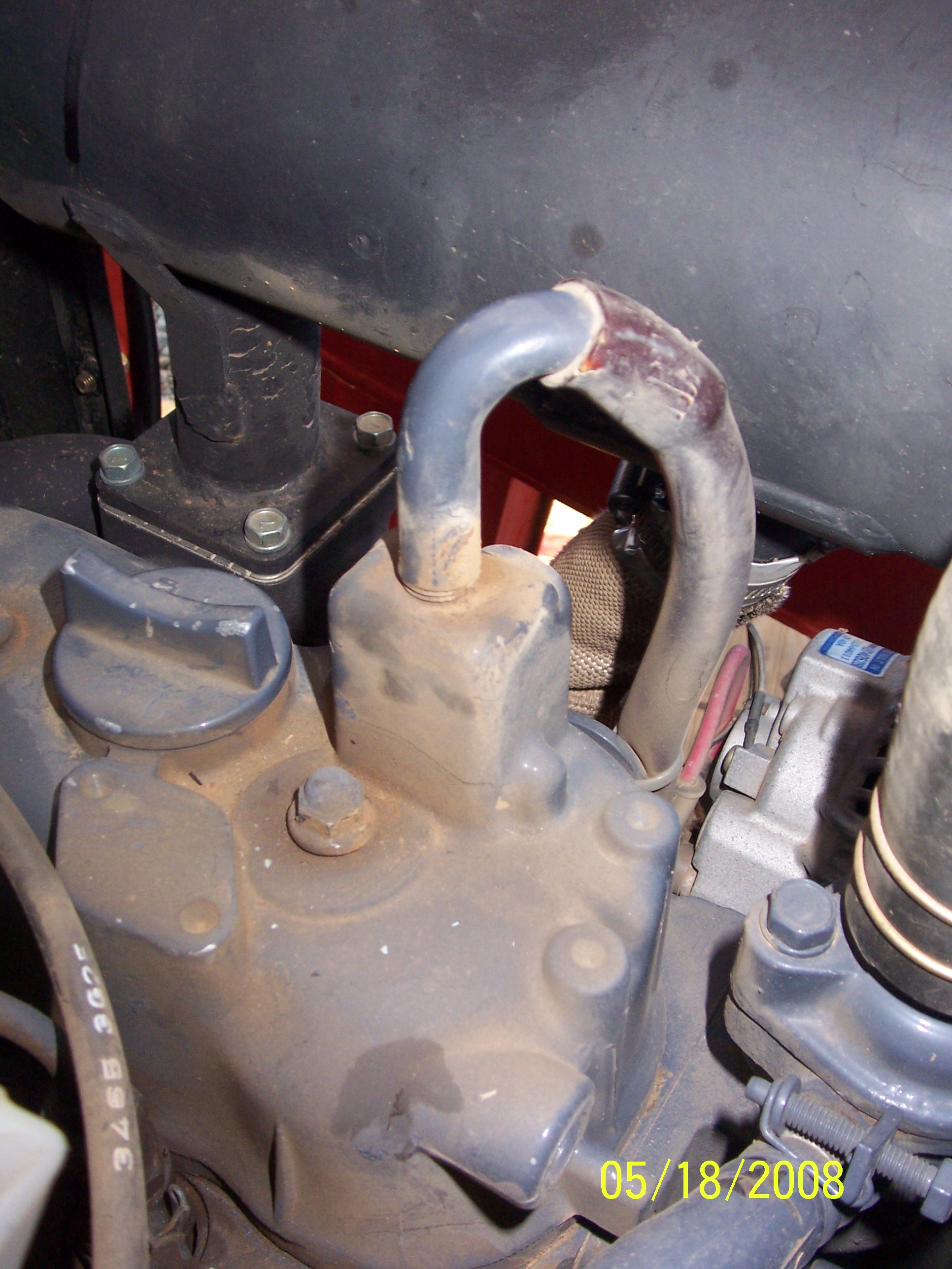

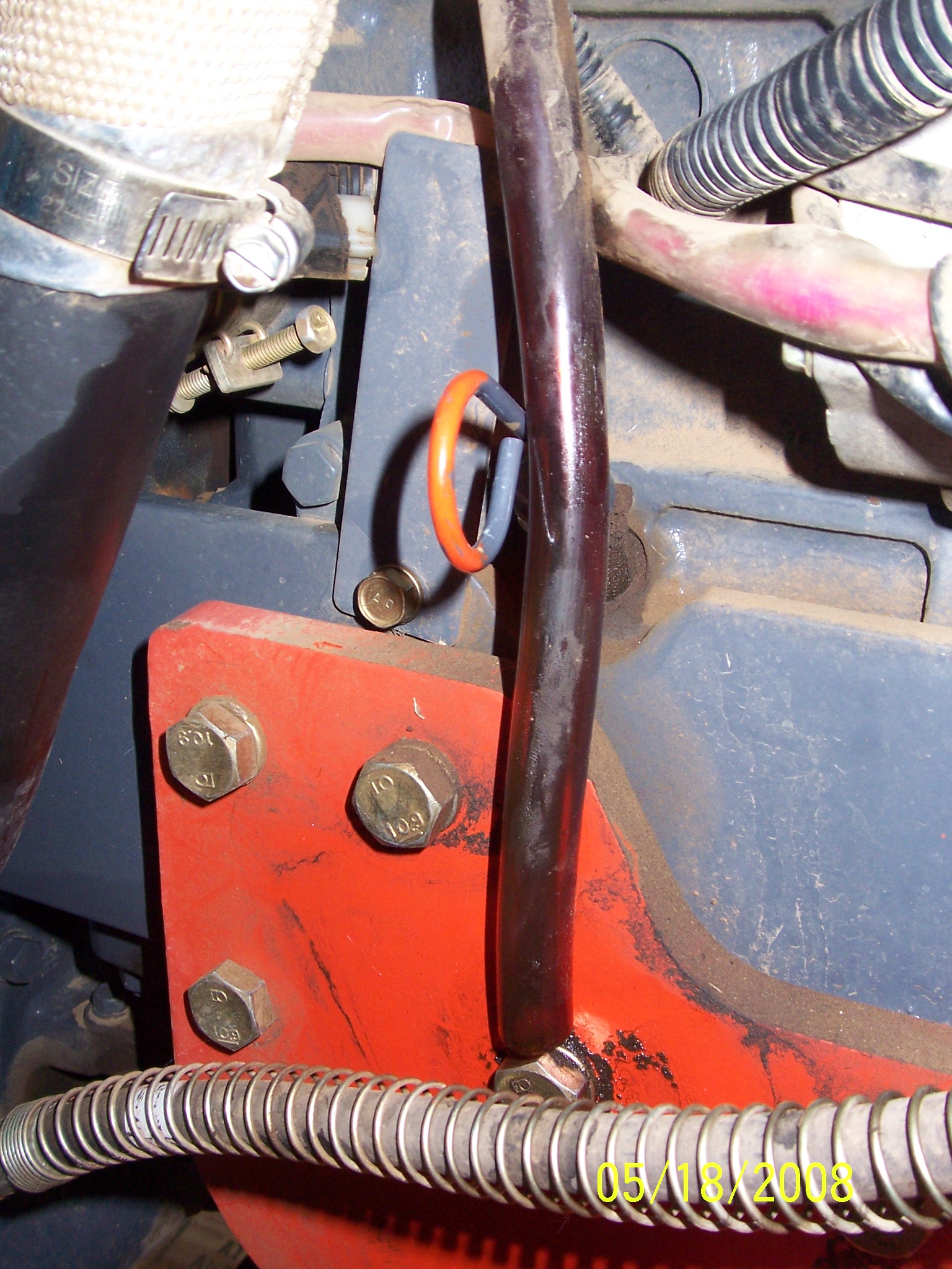

5-18-08, Re: Oil breather tubing. Tell me more. If you have a PVC then I need to do the same, anything to keep the dust out. Can you please advise me on the part no. and when do you replace it. On my engine I have just a piece of 1/2" tubing that is attached to the bent pipe that is coming out of the rocker cover. A friend has a Dodge Ram and he showed me how his engine oil breather is set up with a small paper filter, hose clamped, onto the end of his breather tube. I intend to do the same. If you will look at your Owner's Manual on pg. 23 you will see in the middle photo and to the left of the White "coolant reservoir tank" is the rocker cover; notice the square box that sits on top just below the black radiator hose, with the bent pipe coming out of it. If you look carefully you can make out the tubing that is attached to the bent pipe. In this photo it is black color. Next look at the photo above it showing the "Oil level gauge" and to the left of it; that is the very same tubing end. My manual photo shows what appears to be a flat attachment to the tube end. If I suspect correctly that is dust filter of some sort. Rick Wallace will advise me on this. BTW as mentioned, according to the link >>>engineparts.com<<< Clevite 77 bearing manual, 45% of bearing failures are caused by dirt in the oil. In my case either the selling dealer or factory failed to install, or it fell off while operating, as I have never seen anything there and I look often as it is located right next to the oil dip stick and have to push it aside to insert the dip stick. end caltrac

Cal-Trac; Either your tractor isn't an '04 LK3054xs or mine isn't. Your pics are no where near representative of my unit. The top of the "rocker box" on mine is smooth from one end to the other,except for the oil fill plug,which is on the very front top of the cover, and a small raised cover about 3/4 of the way back which is secured by 4 phillip head screws;a type of baffle,I suspect. It is at this location the "PCV" hose comes out from the side of the "rocker box"; a 3/4 inch OD rubber hose about 3 inches long,and goes directly to the air intake manifold. There is no other engine venting I can locate:confused:
PS My oil fill plug is located right where your vent tube originates

I have what I understand to be a 2004, my breather for the valve cover is connected directly to the intake manifold, therefore, breathing filtered air.
