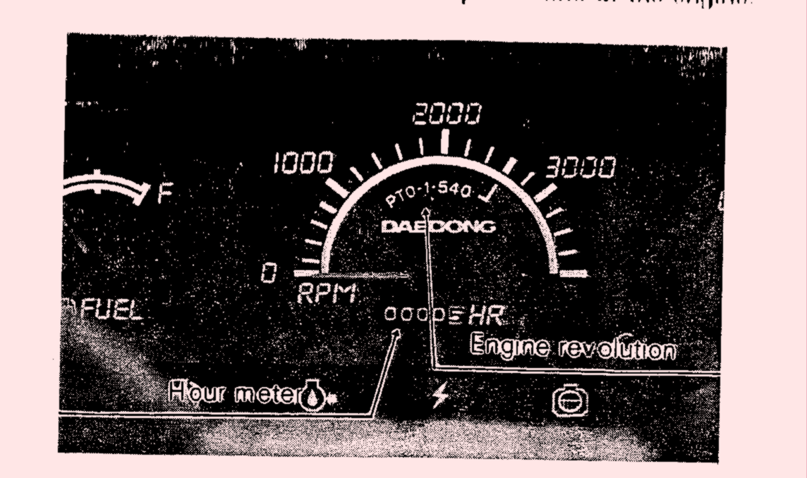

If it's a fairly new model(not sure about the older ones)it is your coolant level. In order across, from left to right;low fuel, oil pressure, alternator, low coolant
   / LK3054 OIL LITE STAYS ON TO 1400 RPMS #32
I don't know how good my scanned image is but here it is.
Icon on the left, circle with drop (after the words "hour meter"), is for low oil level.
Icon in the middle, lightning bolt, is for charging system.
Icon on the right, rectangle with slashed circle in the center, is coolant level.
   / LK3054 OIL LITE STAYS ON TO 1400 RPMS #33
My old 1994 also has that instrument panel. That light is the coolant and the wires that go to your overflow bottle that might be empty.
