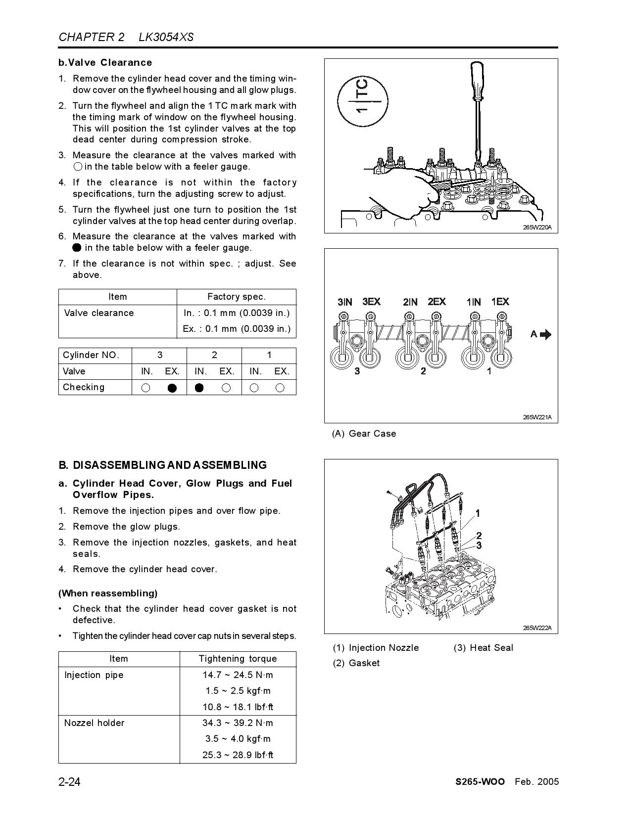

Hey ! Owner of 1998 lk3054 here.
Anyone have the proper specs on valve clearance gap ?

I have a 2004 3054xs; I'm sure the engines are the same TD 1400. The work shop manual lists the valve clearance as 0.18 to 0.22 mm (0.0071 to 0.0097 in) so 7 to 10 thousandths of an inch with no difference between intake or exhaust

Did some searching around and found a LK3054XS manual ...
It has different tighter specs ... is this an update ? or is yours an update ?

I'm pretty sure your researched manual is the updated version as mine does not have the xs notation. The 7 to 10 thousandths should be the correct clearance for your '98 tractor. Thanks for the heads up, as I've not yet checked the clearance on my unit
