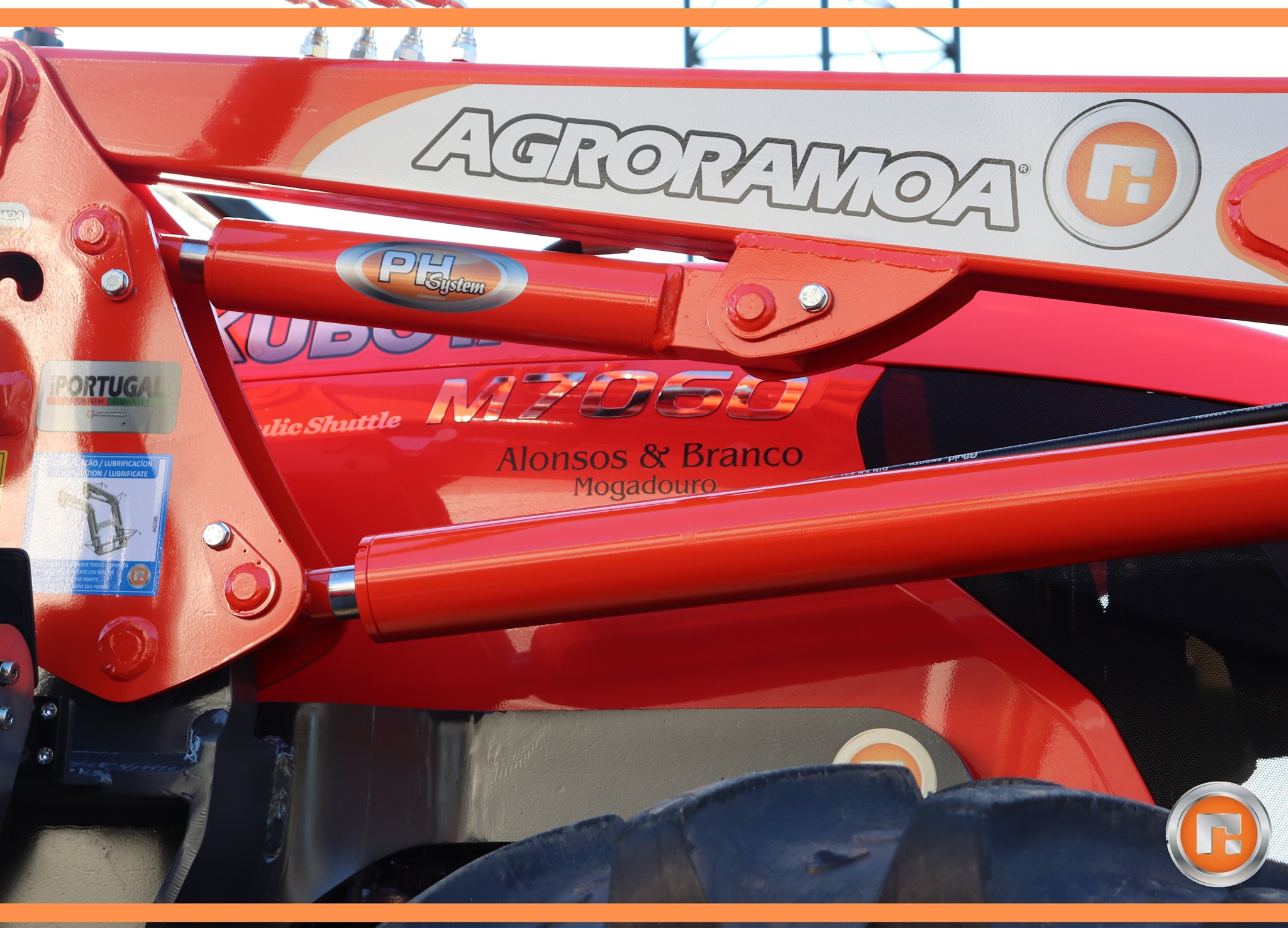

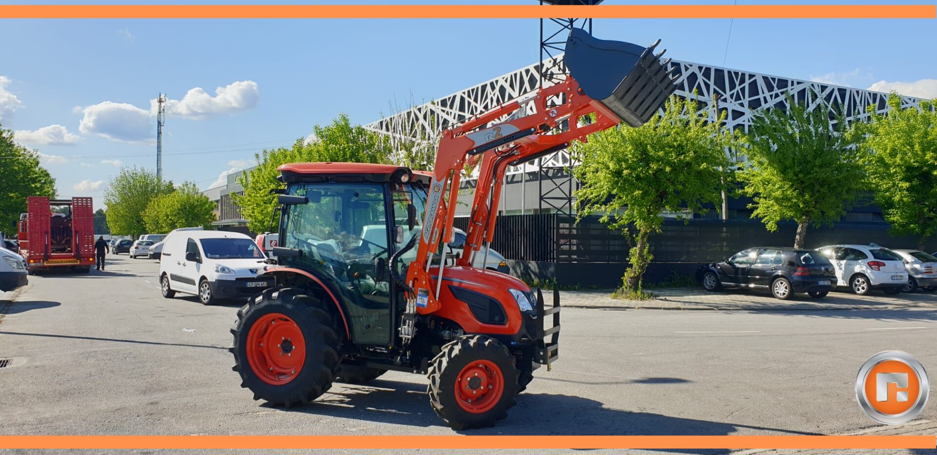

Self leveling can also be done hydraulically, using to shorter cylinder mounted above the lift cylinders and then tied into the dump and lower circuit of the loader. This one is a bit harder to recreate than the mechanical linkage.
I can't see a reason to have the need to turn off the self leveling ever. Unless it's one of those systems that just use a self leveling valve with no feedback that keeps losing it's position. That can be annoying.
Another great benefict of the self leveling is that it makes all of those arguments of: "my tractor can do two functions at the same time and yours can't" totally irrelevant.
