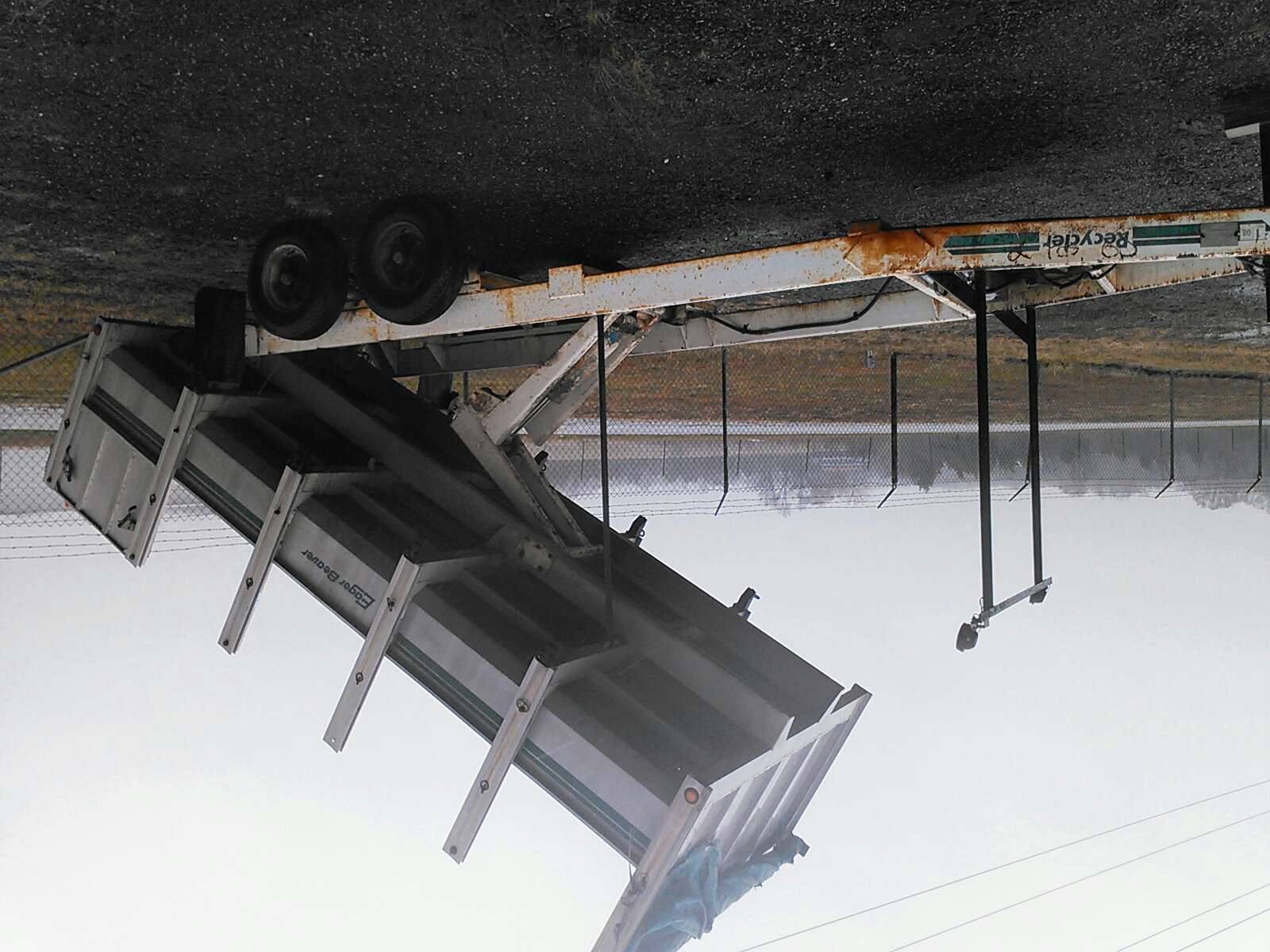

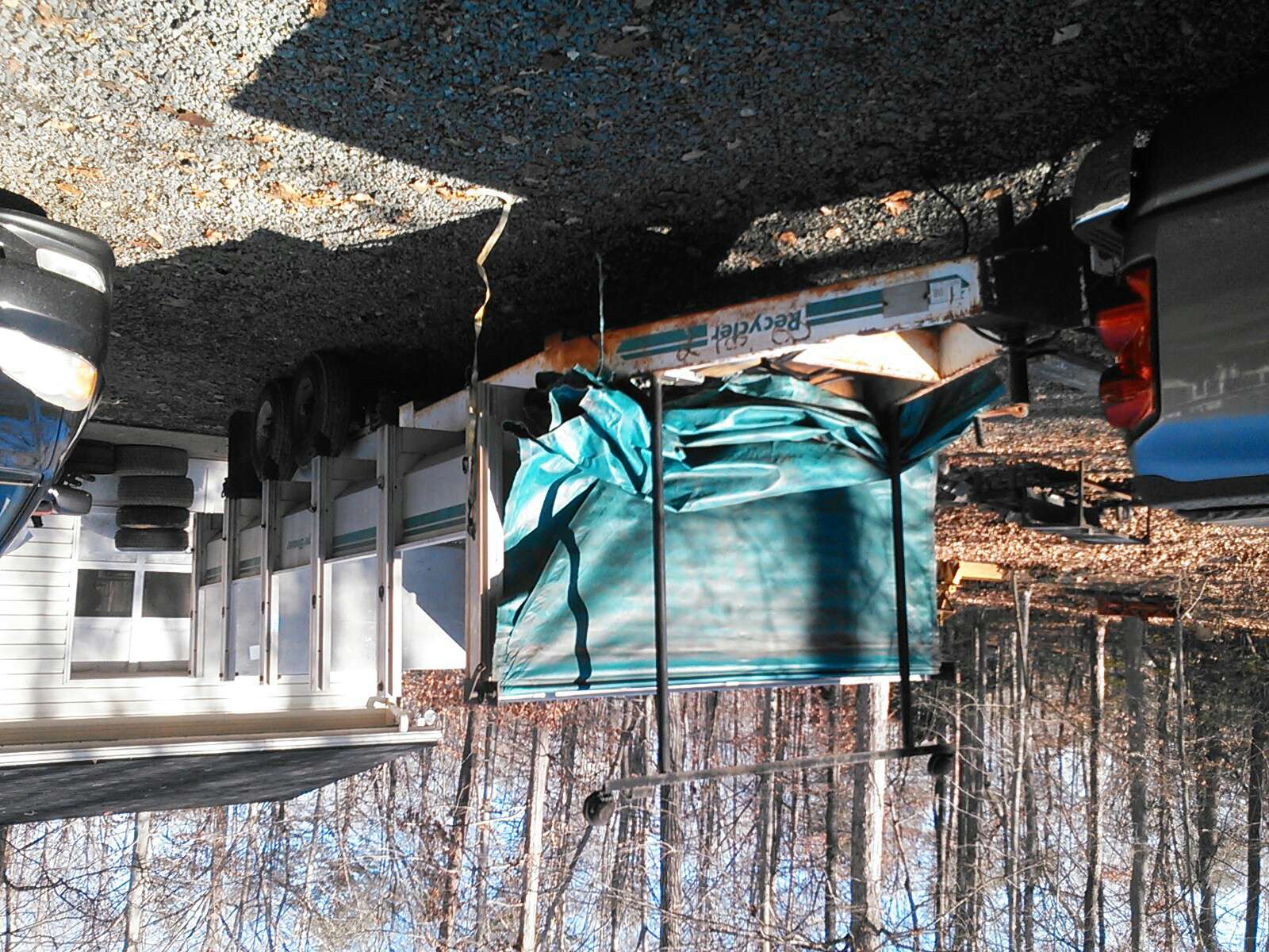

   / Load Trail Dump Trailer with King Sides ? #14
My dump has those sides, I usually get 5t of material when I go the quarry, it's a 16x8 and the material doesn't even really sit on the flared out section. 5t of gravel isn't much volume!
One day I want to upgrade to 8k drop axles to get the load height down.
   / Load Trail Dump Trailer with King Sides ? #15
Here's some newer pics that show the wheels better.
