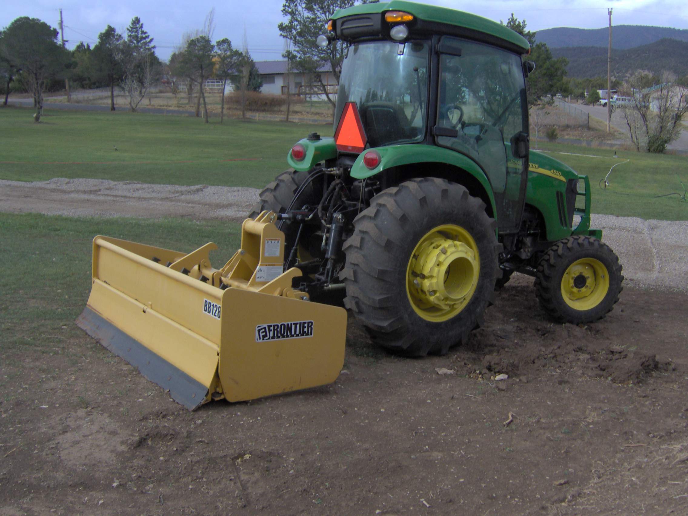

It seems the R4 tires are pretty stiff compared to the R1 tires I am used to having. These tires have 10psi, checked with 3 different guages but notice how tall these stand up when the implement is lowered. While not loaded with fluid I still have 330#s of weight on each wheel. I don't have traction problems but I attribute that to the mostly dry soil conditions in my locale. If I were in the deep south it would be a big issue.
