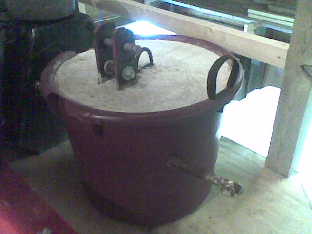

By the way I also have wheel weights on the rear tires and 4 suit case weight on the front. The biggest problem of doing loader work with a bush hog on the rear or something else is maneuvering. I do a lot of logging and that extra 6' of length can make it hard in the woods. I made a cheap 3 point ballast weight for this purpose.
