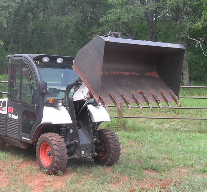

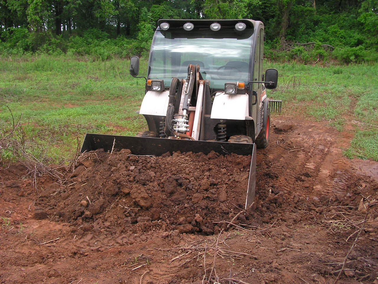

With teeth on the bucket I don't have to use a ripper here in the hard red clay:

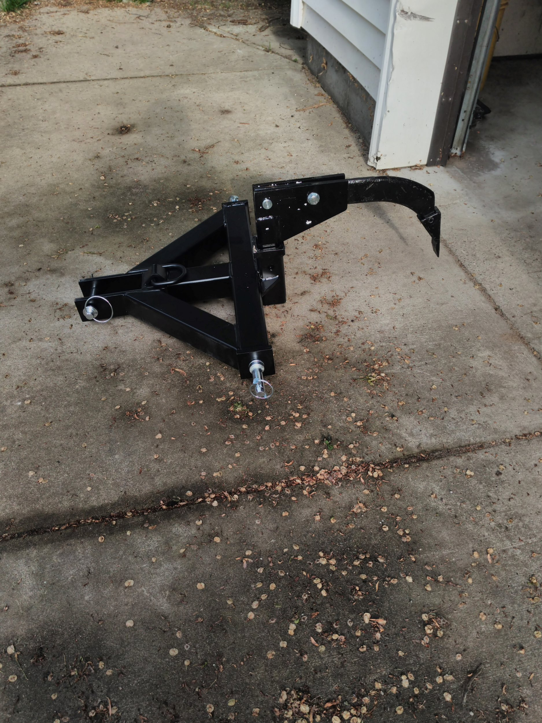

Less than $200 and I can use anything that goes into a 2" receiver...👍

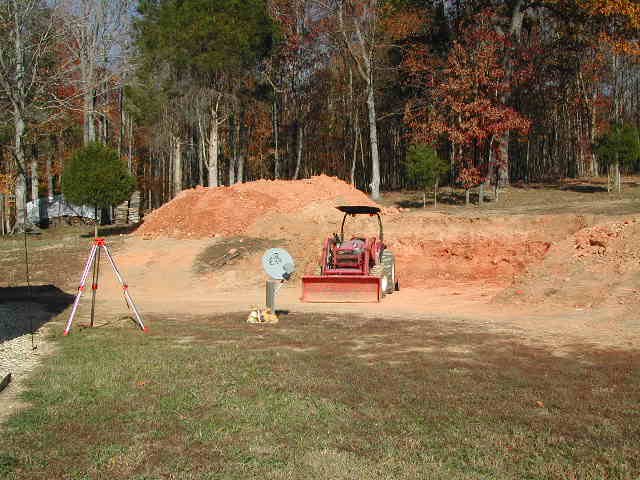

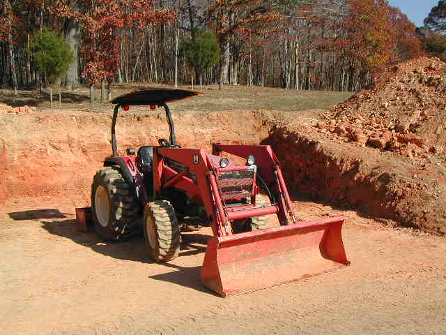

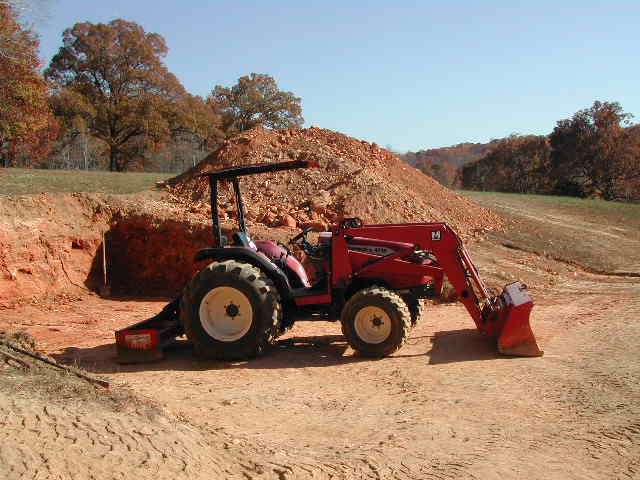

I used one of the rippers from TSC to get the ground started, then just used my plain 6' bucket to dig many projects over the years. This was for my storm shelter build about 10 years ago. Ours is a lot of red clay and layers of chert rock - with a few really big rocks peppered thru. Only had to hire a backhoe to do my footer and utility and french drain trenching. I've used and abused my little 4110 over the years but it has done a BUNCH of work for me.
