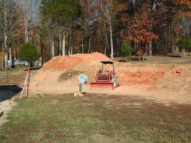

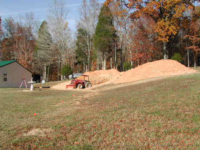

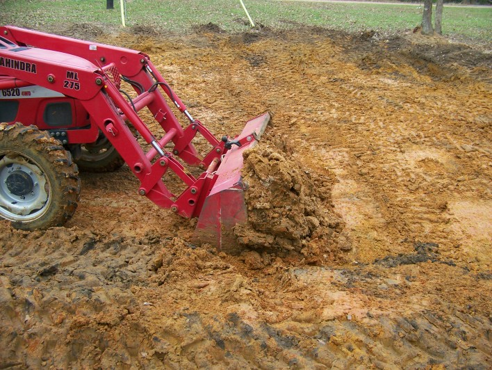

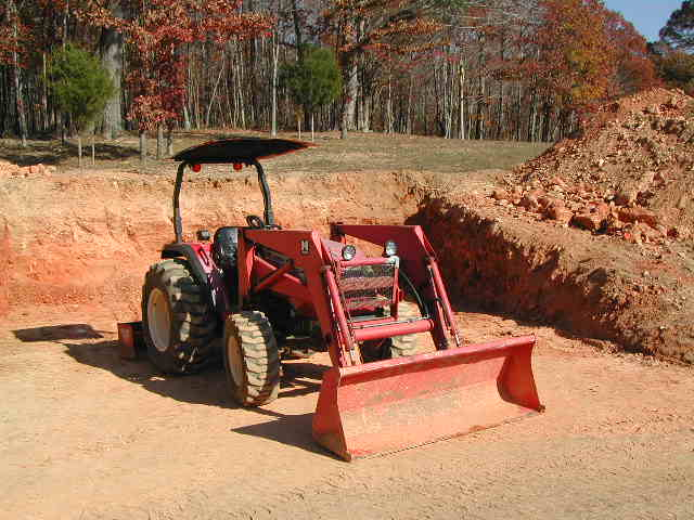

/ Loader as excavator??? #14
I dug two ponds with the loader bucket with no tooth bar. Angle the bucket right and the right size tractor will doze right thru clay. This bucket is 7 foot wide.
hugs, Brandi
