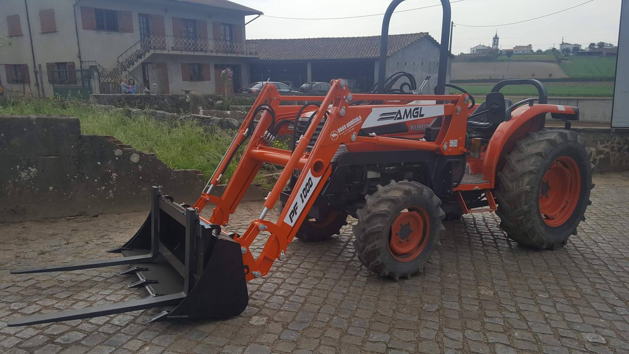

I had an old 1957 ford 851 that had a old loader with geometry just like the OPs. I just lifted the bucket more when transporting dirt.
You can also lift the bucket and get some dirt to sit more at the back of the bucket, then lower it. Or you could extend the bottom of the bucket longer. Kind of like a skid steer bucket.

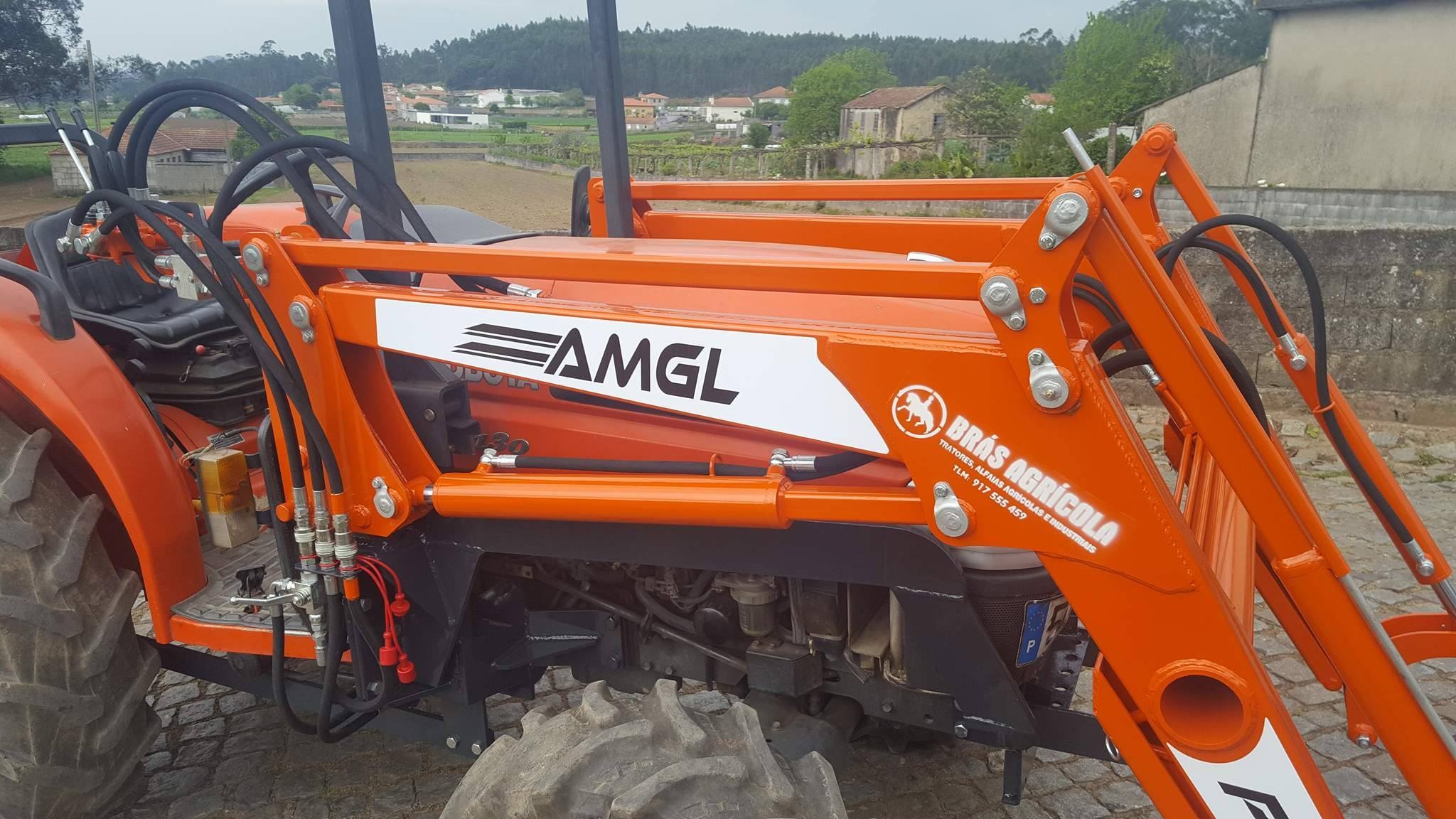

Self leveling using a mechanical linkage, usually above the loader arms, sometimes even ran inside the arms, will move the curl cylinders back and forth as the loader goes up and down.
See the picture below. Note the linkage running on top of the loader arms and note the bracket in the middle where the curl cylinders attach to. As the loader lifts, the linkage will push that bracket forward and therefore moving the cylinder as well, this will give more dump angle at max height.
As the loader lowers, the bracket is pulled back and so is the cylinder, giving it more curl back angle.

If the self leveling is done hydraulically, using a second cylinder mounted, usually, above the lift cylinders but tied into the curl circuit, the curl cylinders are fixed in place as a non self leveling loader.

Thanks. I have seen those, and never did take the time to look at one long enough to work out the geometry.

In my mind, it seems like adding (say 6-8") to the bottom edge of the bucket might help. Not sure how it might work or what issues it might create...

I got about 20% more lift capacity after i converted to self levelling: the arm you lift the bucket over, is no longer the fixed pin on the tractor, to the center of gravity of a full bucket, but from the fixed pin to the bucket pin. The lift cylinders have to do less work, thereby increasing the capacity.
On the loader pictured, the tilt cylinder angle is too steep to have decent breakout force anyways.

His tilt cylinders are already pulling the bucket into a dead end. Lengthening the bucket will worsen that, and not increase the rollback angle.
Only thing that works without worsening the breakout force is cutting a wedge out the sidewalls so the backwall gets a narrower angle with the bottom. That puts the cylinders at a better advantage so it actually improves breakout force.
