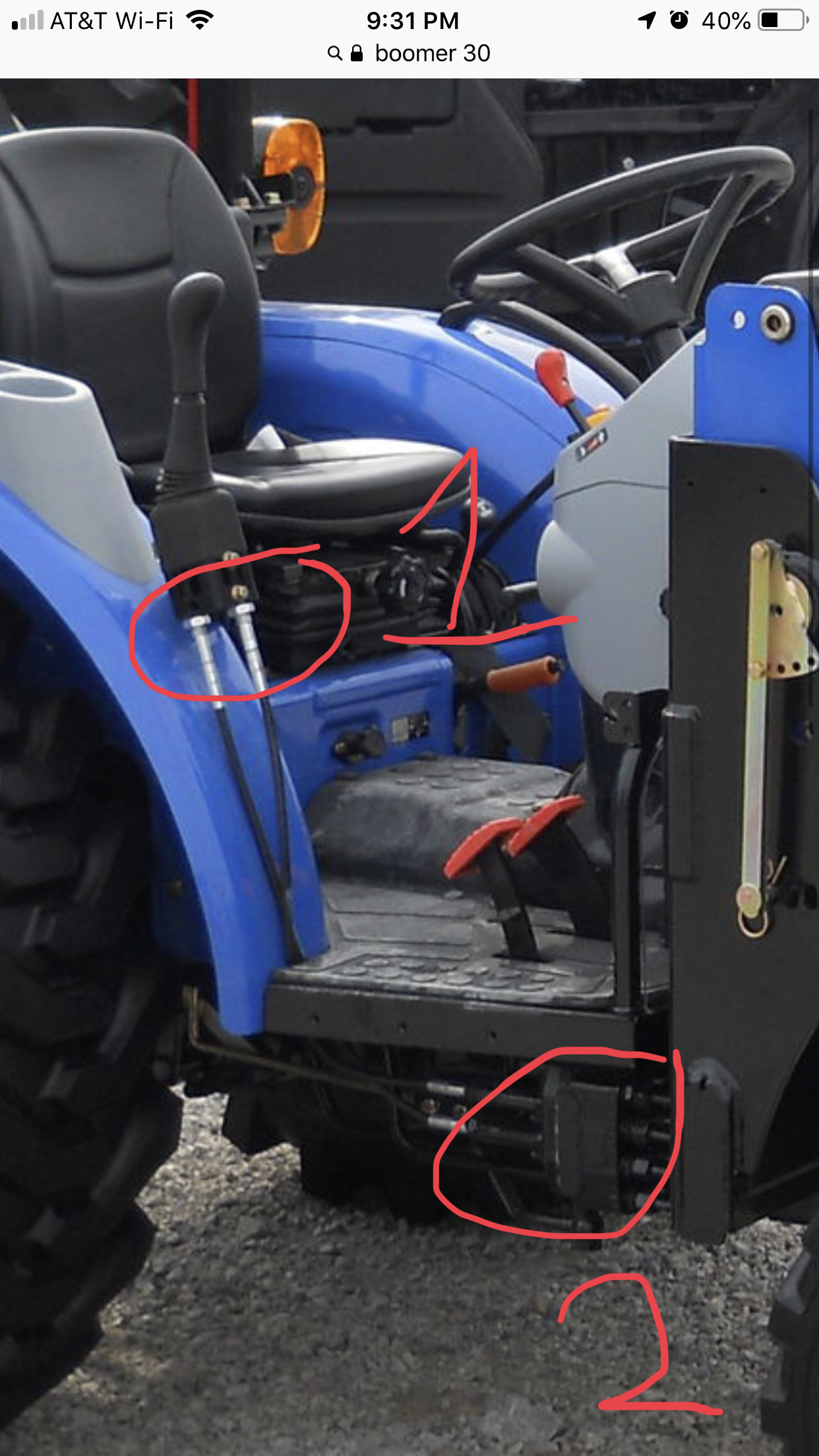

on the very bottom of the valve there will be a cup/cap that covers the ends of the spools...they are usually held in place by two screws (usually require an Allen wrench)...
sometimes moisture will accumulate in these caps...general maintenance is to inspect the caps every 6 months or so...some come with weep holes some drill their own weep holes...

are you talking about 1 or 2 in this image?

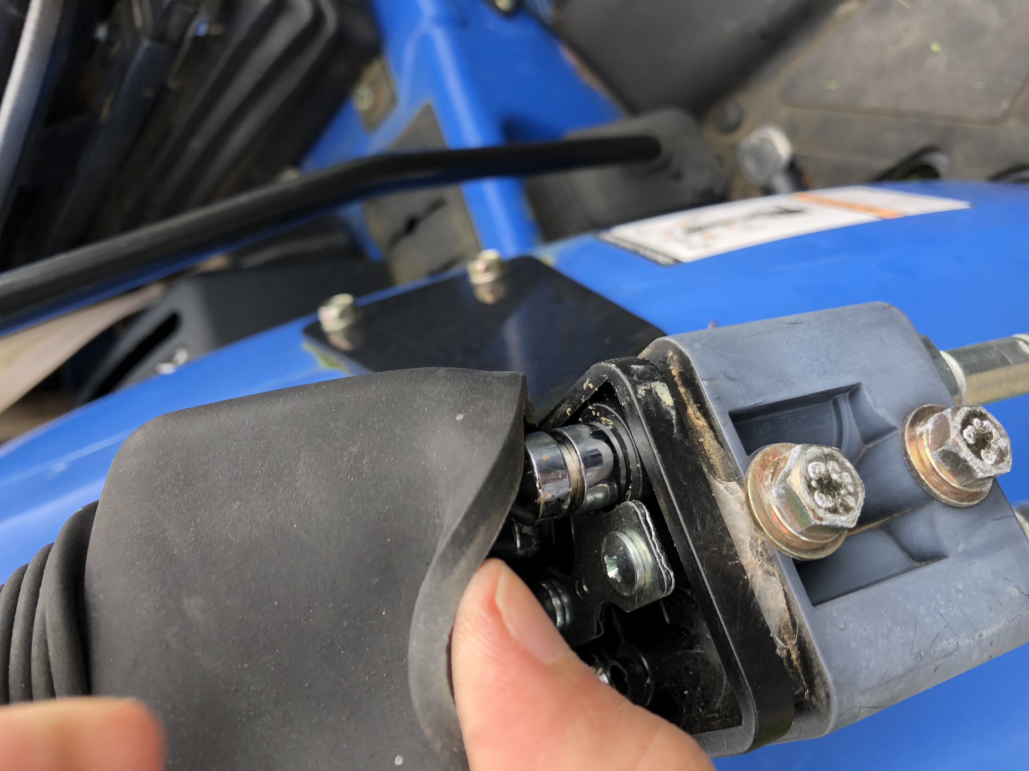

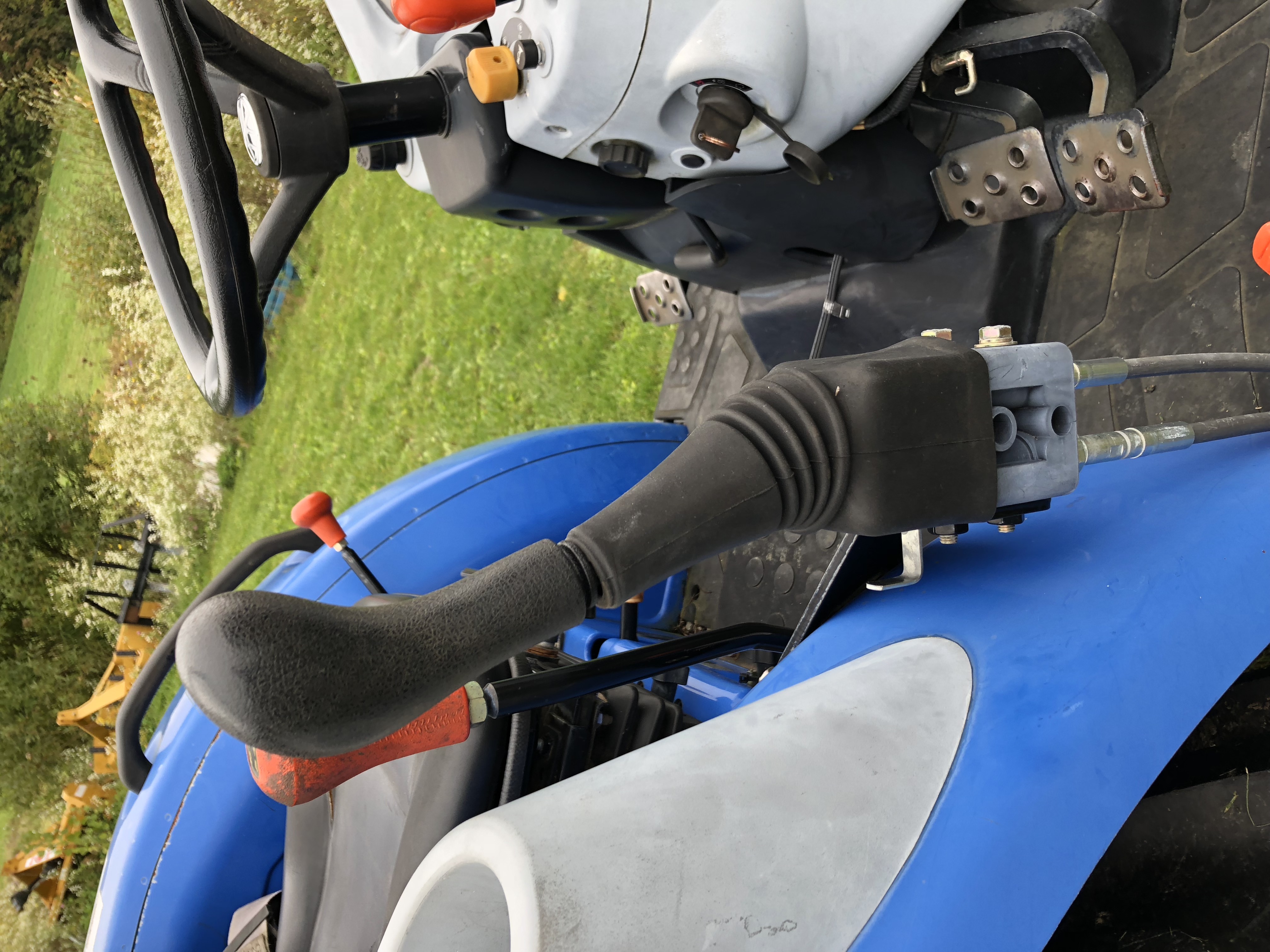

Hopped on the tractor this morning and went to raise the bucket and noticed the throw was very short. Not sure what happened, but seemingly overnight the stick is back about 1/2 way to the end of the lift, so I can only lift very slowly. Any ideas?
View attachment 572907 View attachment 572908
That one looks much different from the one that I had so I am not sure what to tell you now.

# 2 the "caps" are on the right hand side of the valve in the picture
