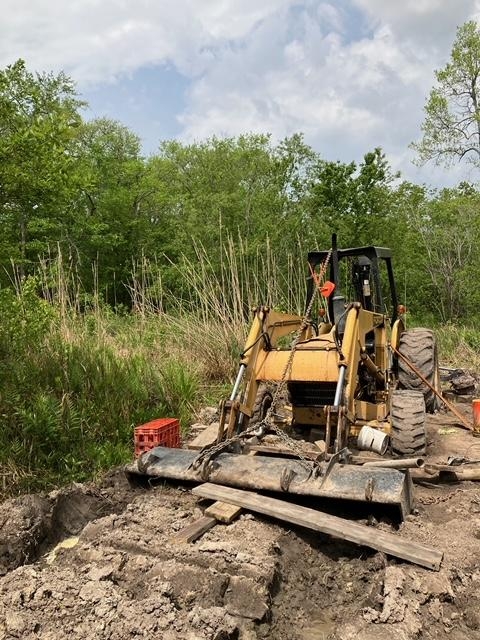

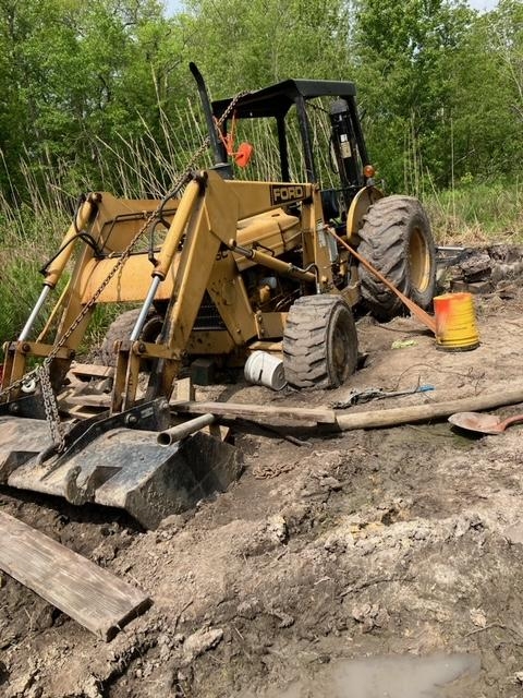

Ted, I so glad I'm finally getting back to you! foolishly I allowed an experienced (???) tractor guy try to get the 445C out of the mud. (I'm 90, can't walk and went back to house) Found loader into the clay mud. engine turn over but struggled to start. loader no response. I jacked up loader and engine improved. The higher the better the engine. I put it in forward slight clunk revved it up and wheels didn't react. might be clutch. Is there an adjustment I can try? I live on the 1st floor, so jumping out of the window won't help!

Fred, when you chained the backhoe to the loader and activated the backhoe, I assume the backhoe moved, was working.
Did you move the loader lift valve at the same time you were trying to pick the loader up with the backhoe so that the loader cylinders could transfer oil out of the top of the cylinders?
The backhoe works as expected. The loader is on float. I jacked up the bucket a couple inches at great effort and now the engine runs without strain.

Hire a young kid to dig the bucket out on the sides and front... then try to operate the loader. It may just be sucked into the mud without enough lifting force available to set it free.

suggestion, disconnect the upper hoses on the curl rams and tie off into a bucket(to catch the oil as loader bucket rotates ) then use the backhoe to drag your self onto the grass. Then sort the trans issue, and the loader issue.

Mike1955, the loader bucket is "locked" in position by the hydraulic curl cylinders. Disconnecting the upper curl cylinder hoses will unlock the rams allowing them to retract and the loader bucket to rotate flat and then slide on the ground as to OP drags himself out with the backhoe.
The bucket is to catch the oil displaced by the retracting rams.

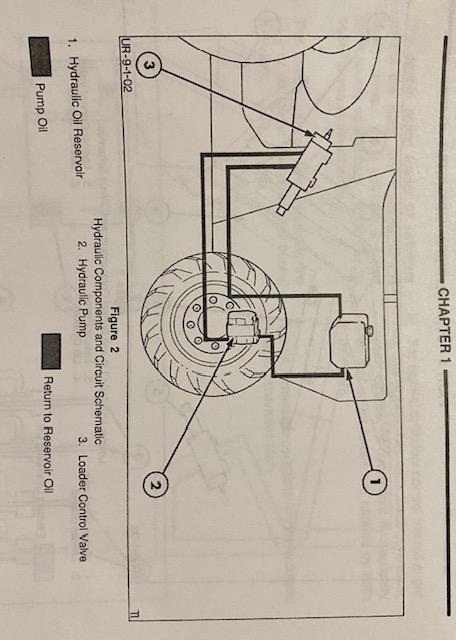

Y'all seem to be adamant about something I don't quite follow you I have a simple loader system on my 445C industrial model here is the layout. I think I just lift the loader bucket, which is on float, then tow it all out. If it is necessary to disconnect some lines, I will plug everything exposed.

That is just the loader hydraulic system. I'm working on what I think the system looks like with the backhoe. Do you have a book on the 764 backhoe that might show it? Or does someone here on the site have one?
I am thinking that a quick coupler came off or separated (maybe not all the way) and is not allowing flow to the loader.
The flow comes from the front mounted pump to the backhoe, then from there to the loader. There also is probably a relief valve after the backhoe to the loader that is popping off if the coupler is disconnected.
