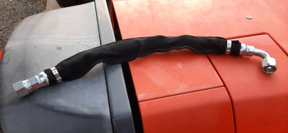

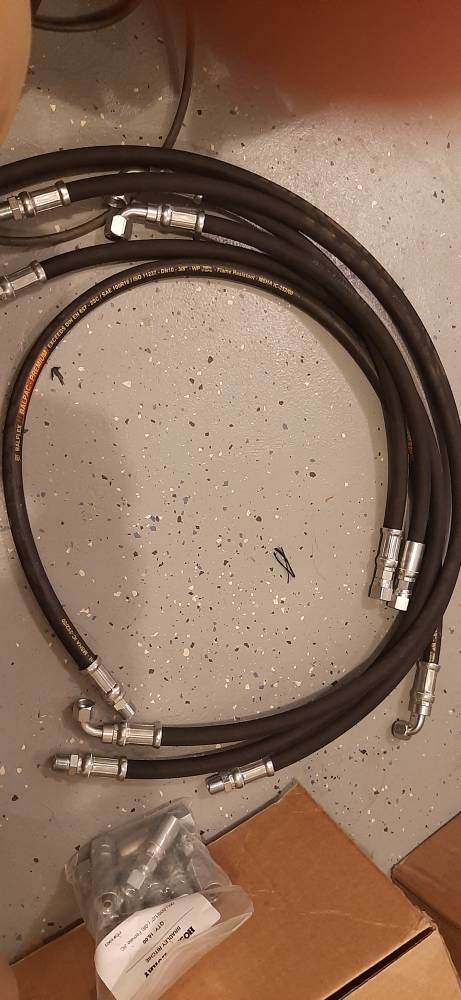

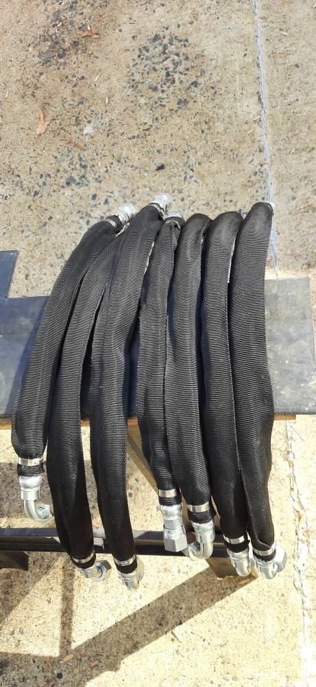

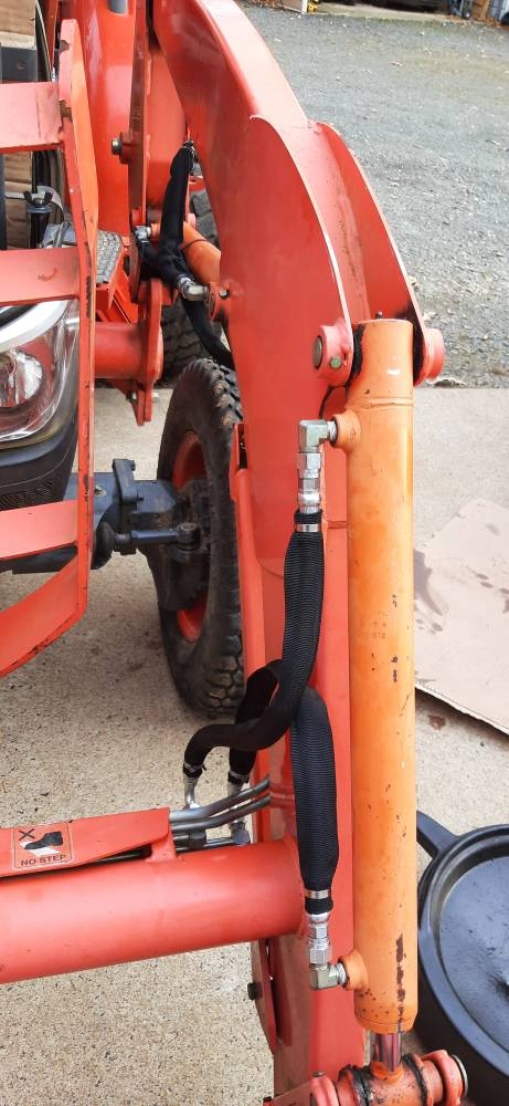

It's worth doing, I had a hose blow on the loader a few years ago, worst possible time and made a huge mess. Hose didn't look that bad when it went.
Decided to change all the loader hoses to avoid future problems.
I have a crimper so was able to make all my own hoses, but for an additional $10 each Discount Hydraulic Hose will make the hoses, if you know your fitting type/size.
I would also recommend a nylon cover to help protect from UV, you can buy the cover by the roll from multiple vendors (even Amazon).
I also used crimp style clamps to hold the covers in place (also found on Amazon).
The local hose shops are really pricey!
