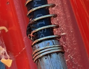

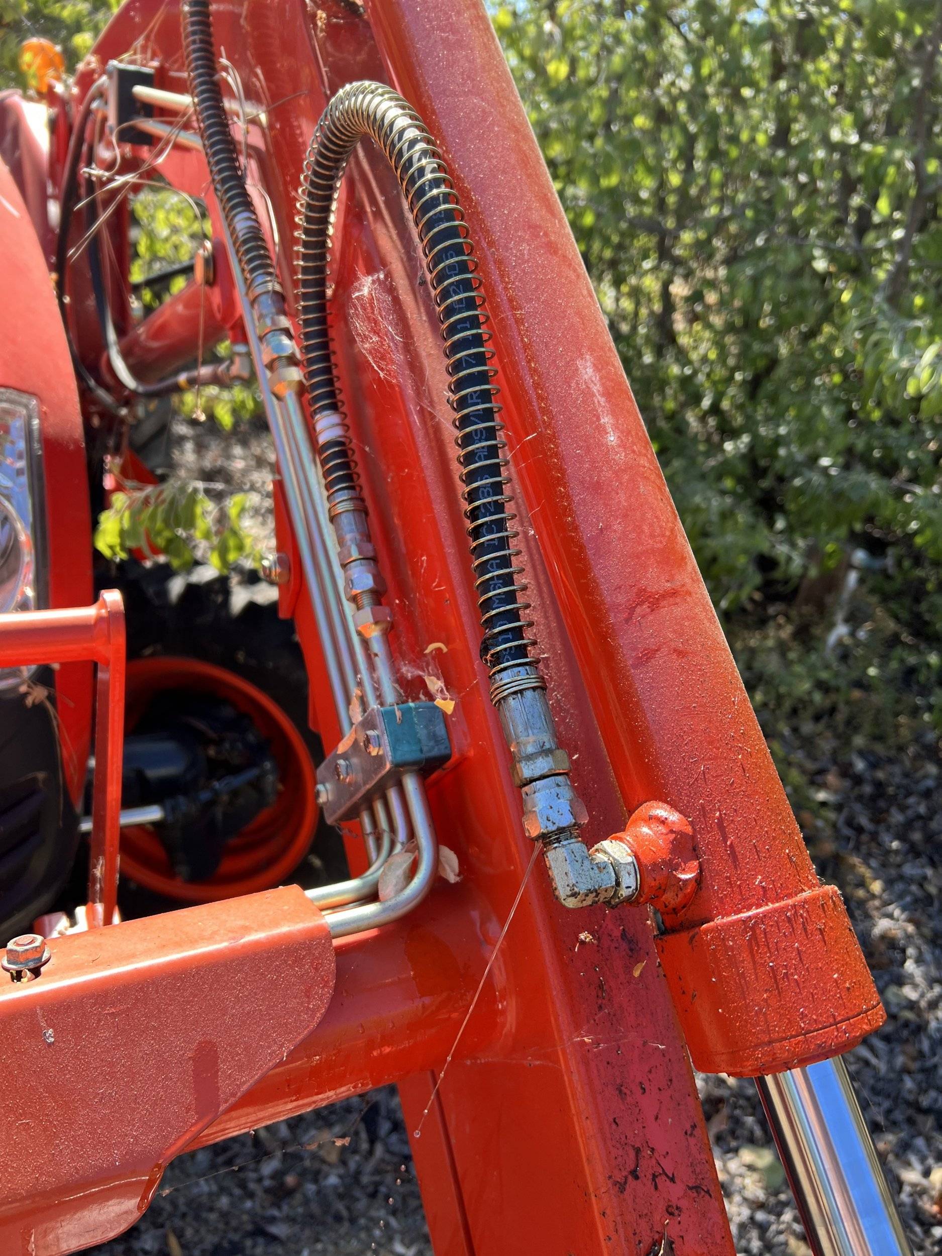

CK3510SE--sprung a leak. 5-paw Kioti dealer closed till Tuesday. Non-5-paw dealers seem to only stock filters, etc. Does anyone know if a Kubota (or other?) line can be used? Are these things fairly universal? Dumb question: after I change it, any bleeding needed? Or just top off hydraulic fluid?
Thanks!

Any hydraulic or tractor shop, regardless of brand, can repair it. Problem is going to be finding one on the july 4th holiday. The system should self bleed afterwards. Hoses are not brand specific

Interesting spot for a leak. Did you pull apart, Teflon tape and put back together?. Did you crush it with something? As others have stated, take it off and bring to shop. I found a local hydraulic place one time and the put together a new hose for me
/ Loader hydraulic line--need quick help #5
Make sure that it just doesn't need to be tightened.
I had that happen once - connection had slowly unscrewed and started to leak. Just tightened it and it has been fine since.

Thanks for pic. It looks like there is hydraulic fluid where the connector is crimped to the hose, if so then tightening/ sealing connector is not the problem. Hoses are generic but threaded connections are not and contributor 5030 has good suggestions about who might be open on July 4 weekend. You will have to identify what the connector style is. Forcing another hose on with incorrect thread will permanently damage the thread on the elbow.
Kioti web site may have info on thread/ connectors they use.
Hydraulic systems are self bleeding since fluid return to a reservoir where entrained air floats to top and is vented and pump in fluid picks up fresh fluid. Check reservoir fluid level and top as appropriate.

Thanks everyone for the advice! Pretty sure the leak is caused by--ironically--the helical wire guard cutting into the hose. Fittings are all tight.

Fittings are British Standard Thread (BST). A good hydraulic shop will have them.
Put a sock on the hose and toss the spiral guard. Had the same thing blow out one of my steering hoses on my NX series that was tight enough that I had to drop off my loader to go after it a couple of years ago.
