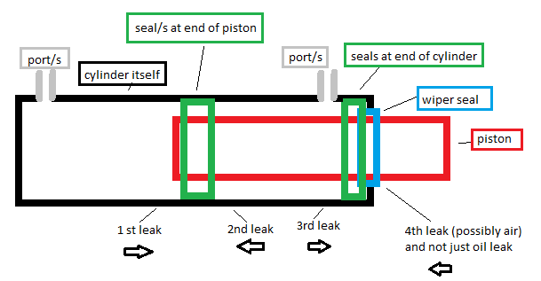

*waves a white flag* it finally clicked in me mind.
when i started to draw, and just about to open excel sheet to rough calc volume... for total hyd oil volume in A and B diagrams.
B = more hyd oil in the cylinder vs A diagram, that has less total volume of hyd oil in it.
thanks for keeping at me. was in the old fart mood, stuck in me ways and not about to budge.

Yes. This animal has been beaten on TBN numerous times, but it is an important concept that bears repeating.
It is important to emphasize that loader boom (or hoe boom) bleed-down is the result of unwanted cylinder
retraction. If you get unwanted cylinder EXTENSION, as BRAIN55 points out above, then forces are trying
to PULL the rod out of the cylinder. Since the valve is closed, the rod-side fluid has nowhere to go. If the
piston seals are damaged (or missing), this force imposes a vacuum on the cylinder, resulting in air getting
sucked into the gland seal. Or cavitation of the oil (less likely). So the bucket or boxblade bleeds down
without any visible oil leaks, and you need to do more investigating before you can blame the
valve or piston seals, or both.

A cylinder will leak down with bad piston packing if the load is held by the cylinder under extension. The rod going out causes a vacuum in the base end but it still does not stop it from creaping. Less fluid in the rod end [because of rod volume] goes into the base of the cyl. I have had cylinders under extreme load [oilfield] blow the gland packing and/or o-rings out because high rod end pressure under compression but it still will leak down. Just been my experience, don't shoot me. When I design power units for industrial application I now use double PO checks because the quality of a standard control valve is so poor you cannot rely on them holding a cylinder in place anymore and most customers are too cheap to buy quality valves like Dynex. So like JJ said valve seals have nothing to do with cylinder holding. And technically for a double P/O check to work correctly the control valve has to be open to tank in the center position. [motor spool] CJ
