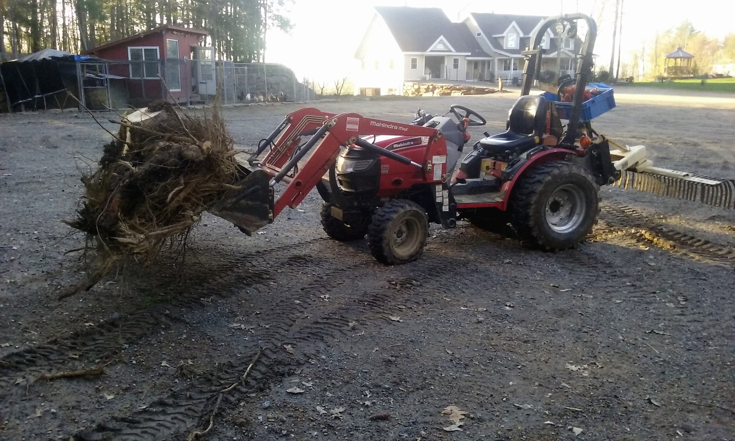

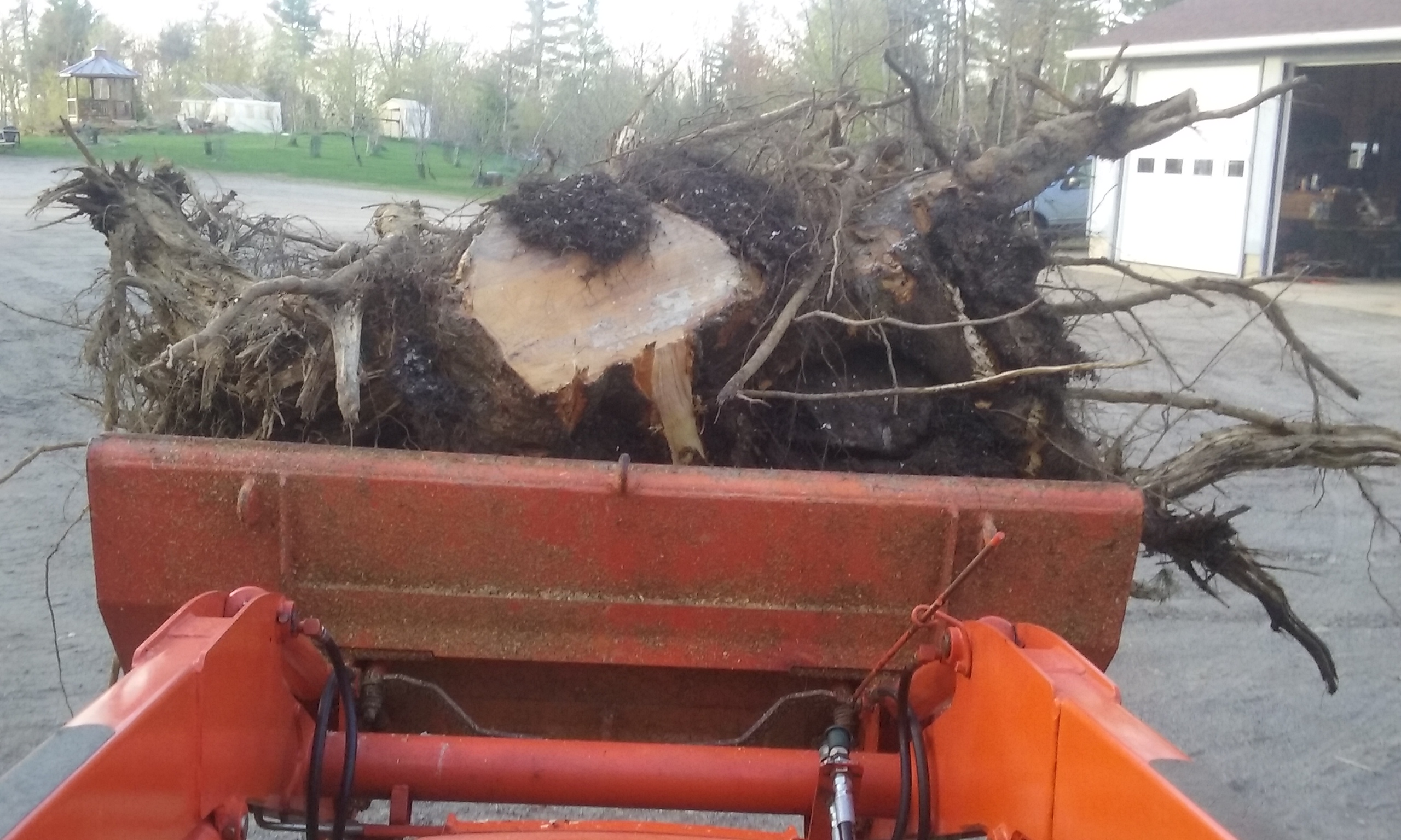

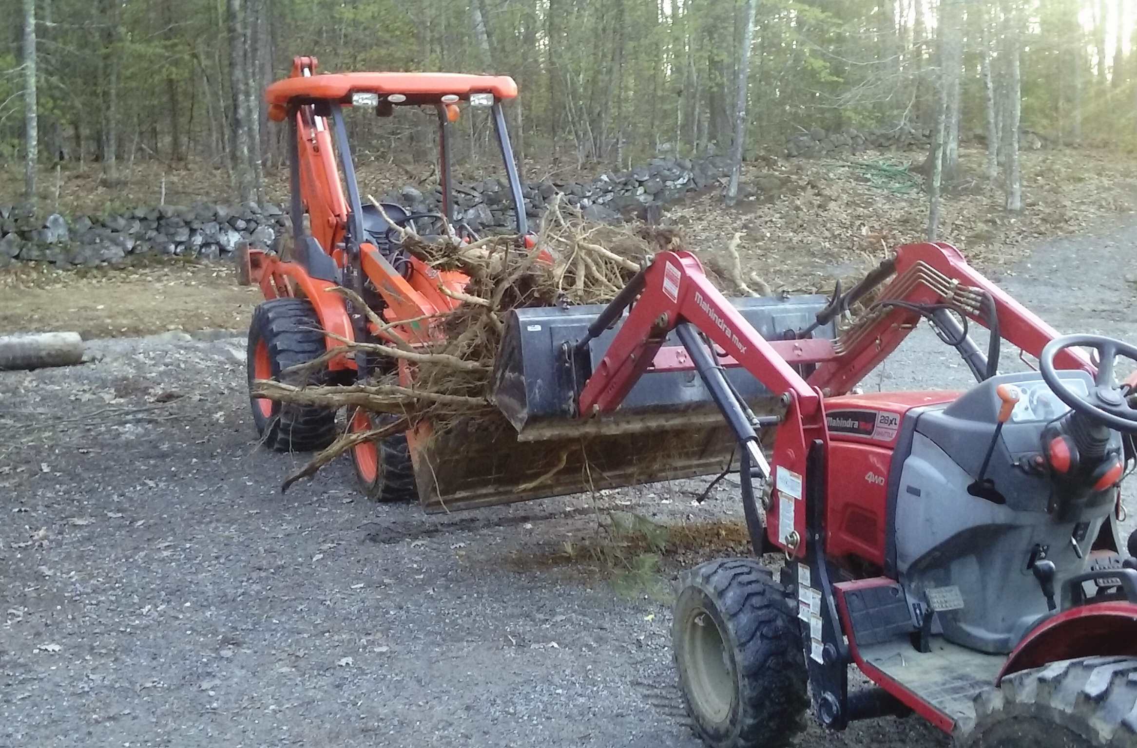

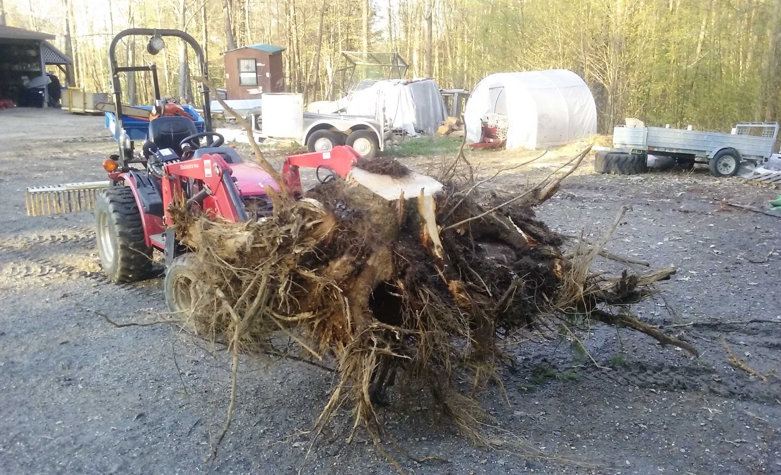

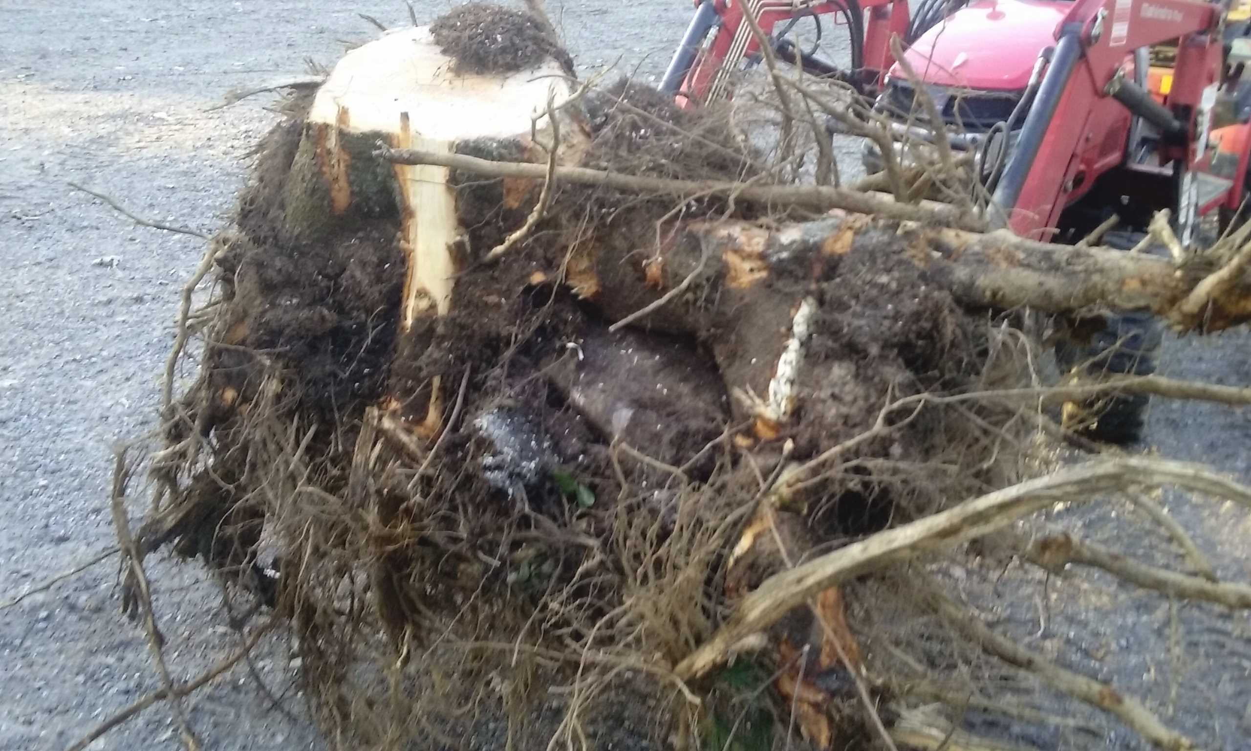

I adjusted my new loader valve, it was bypassing at 1950 psi, now it's at 2250 psi, so more than 10% greater lift (2250 is what my dealer said it should be at.)
Considering it takes near 400 psi just to lift an empty bucket, you added another 20-25% to your lift capacity, not 10 %
PS
You can go another 5-10% on the pressure, (2,400 psi) just make sure you use a gauge and do not exceed the main pump relive pressure.
My loaders more than match the capacity of the tractors.
