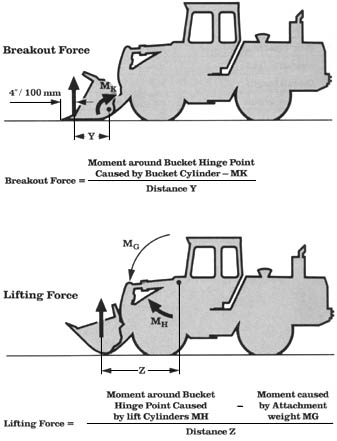

Any one have a link to source that gives a definition of "breakout force"? I have looked and can't find a definitive description or how it is calculated. I chased this once before and I thought I found a source that indicated "breakout force" was the maximum weight (at the bucket edge) that could be curled at ground level.

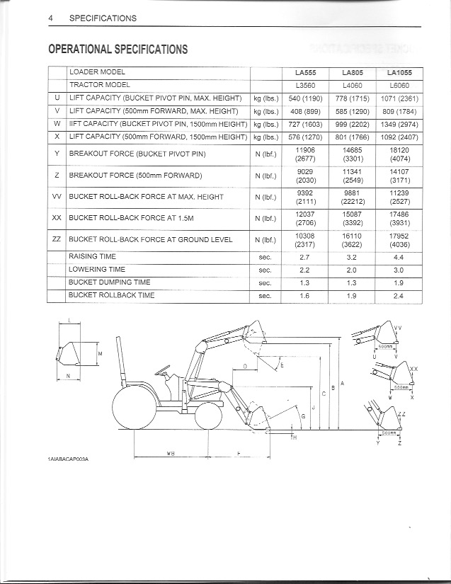

I found it and it clearly shows that the "breakout force" is the curl function. According to the Kubota spec sheet for my loader I should be able to curl 75% (3171 lbs / 1784 lbs) more weight than I can lift, which is not the case.

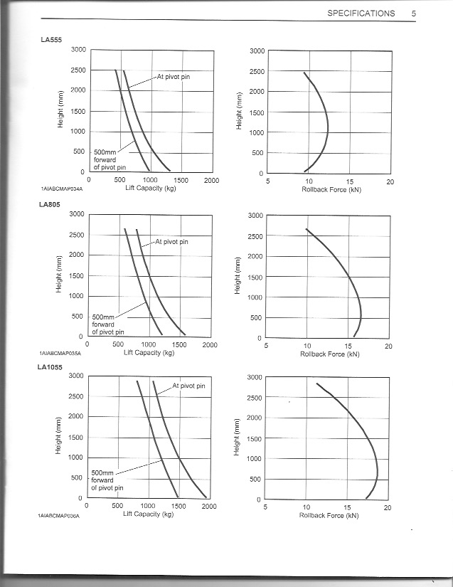

Here are 2 pages out of the Kubota Operator's Manual for my loader.
The graphs on page 5 show the lift and rollback capacities at different heights. I assume the rollback graph is at the pins. If that is correct, then the rollback capacity at ground level is less than the lift capacity. However this reverses quickly and at 500 mm above the ground the rollback capacity is more than the lift capacity. From what I can determine, the loader specs listed in the tractor brochure show the lift capacity at maximum height (not at ground level, where the capacity is much higher). However the breakout (rollback force) listed in the brochure is for the capacity 500 mm forward of the pins and it does not appear to show that information on the graph, in the Operator's Manual. Looking at the drop in capacity from the pin location, to the 500 mm location for the lift capacities and assuming the drop would be about the same for the rollback capacity, then it appears the brochure is listing the rollback (breakout force) at ground level.
The brochure appears to show lift and rollback capacities at different locations, which just adds to the confusion.

Well.....what you are looking at according to the image is the force with the bucket bottom level? Maybe that is the definition of rollback force. What's really going on is your cylinder for your bucket is changing angle to the bucket if keeping the bucket bottom level as the arms raise, thus the force changes. Let's change the terminology for a second. Change it from force to moment about the pin (torque if you prefer to think of it that way). It does not matter the height of your loader arms. That does not have any effect on the moment about the pin. If your bucket remained in the same rotation relative to the arm (curl cylinder was same extension), then the available moment about the pin would be exactly the same. Look at the images on the right. The curl cylinder when loader in up position vs. down position. you can see it swings thru the "perpendicular to" angle. This angle is your maximum force applied at the cylinder connection (but may be different angle than max breakout force depending on some geometry). As stated in earlier post, this is not linear. So cylinder/linkage designers design for an "ideal condition" location and then realize that force will be reduced as the cylinder swings thru the arc.
