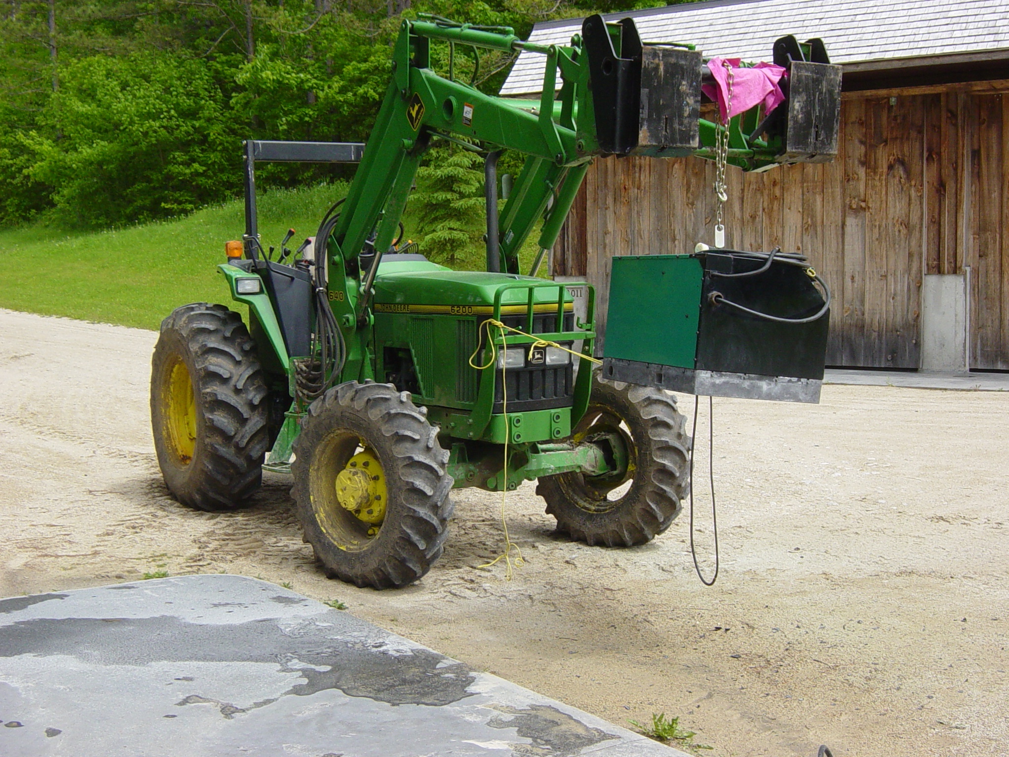

So what we have learned from all of this is simple, the angle to the dangle matters so pay attention to it.
At the end of the day, if your tractor won't pickup the load, figure out a way around it.
I've had people complain that they can pick the rear of the tractor up with a heavy load in the bucket.
I've had people complain that their loader is too weak to pick the rear up with a heavy load in the bucket.
I've had people complain their loader can curl more than it will lift.
I've had people complain their loader can lift more than it will curl.
I've had people complain their loader wouldn't lift the front wheels off the ground then lie about having the brake locked when they were trying.
There is a single factor that limits every operation. Sometimes that limiting factor is in the seat.

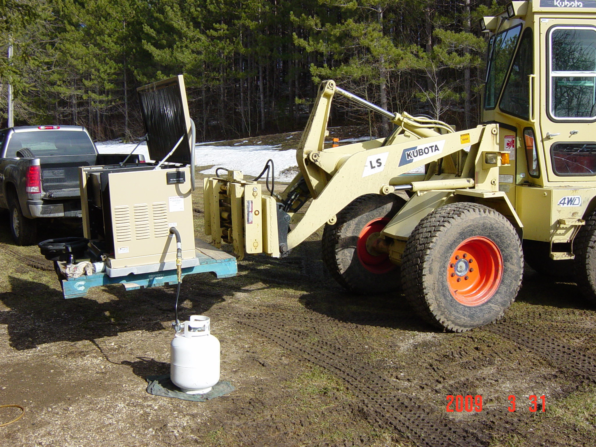

I guess they achieve self levelling the same way. Compare that to the horrible clunky, and rattling system on our 6200.
Interestingly, both machines as different as they are and the JD having 75% (or so) more HP, have similar lifting and breakout capability.

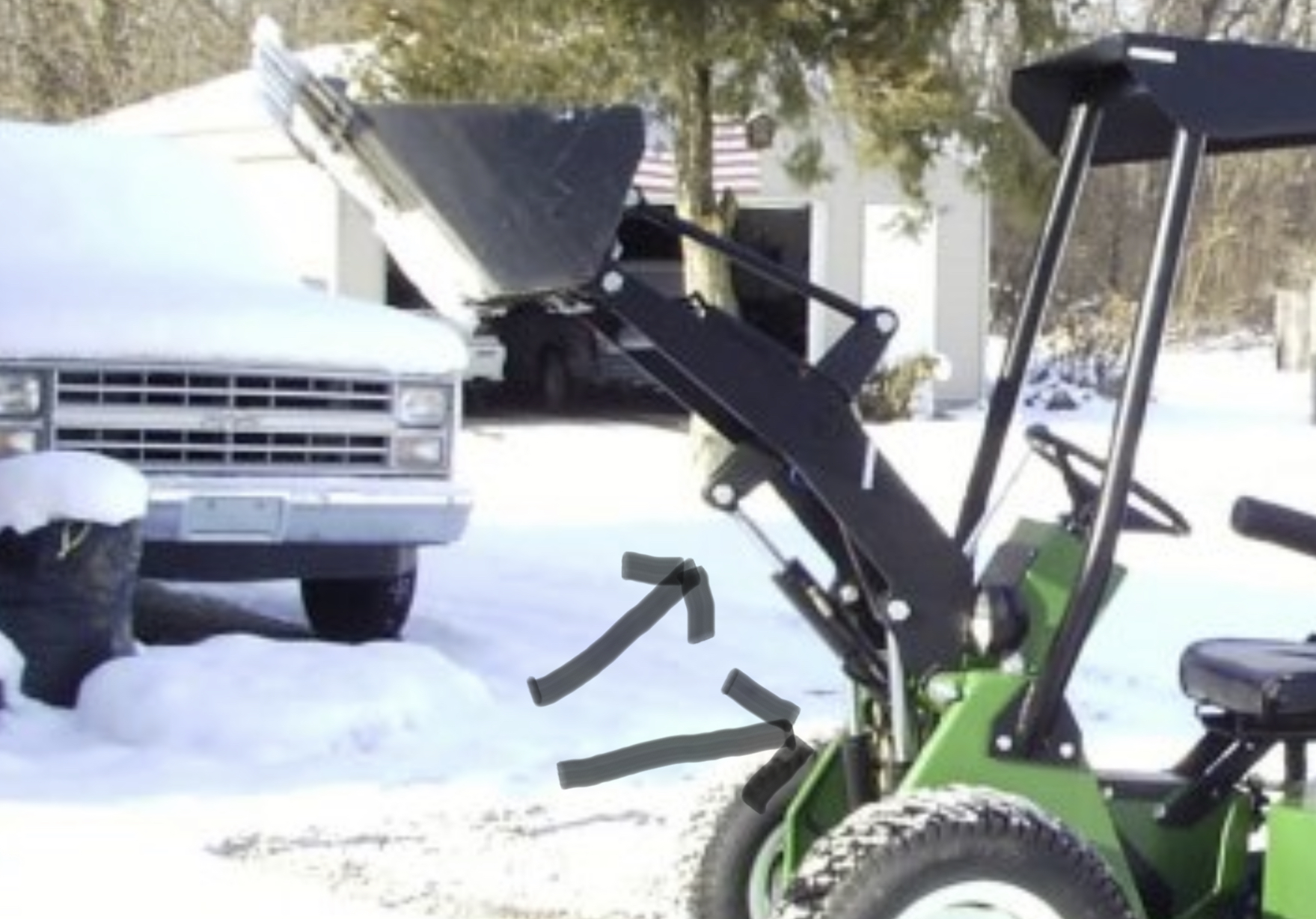

Our little PT425 has a rollover assembly that reverses the path of the curl function. It pushes to curl and pulls to dump.
