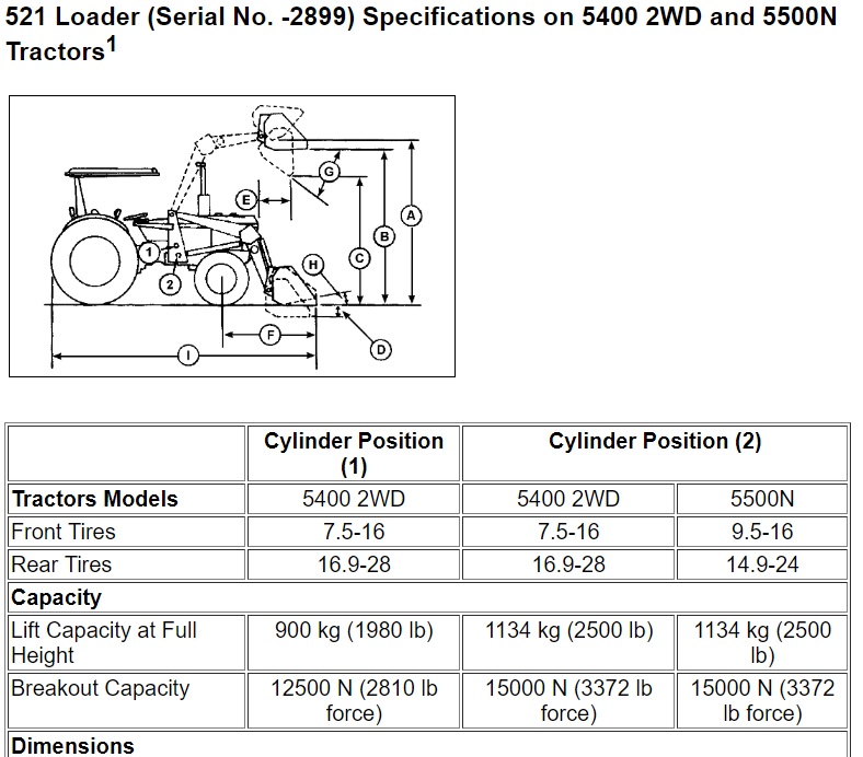

I have a JD 5105 with a JD 521 loader. I'm looking at buying an automotive lift at some point, and most of them require you to unload off of the semi trailer when they deliver. The pallet weight is 1700lbs. I'm wondering how well this rig will do with that heavy of a load. The forks I have are rated for 3000lbs and Tractordata indicates that the breakforce is 3000lbs and lift to full height capacity is 2000lbs. This would be just taking it off of the truck and setting it on the ground. I can break down the pallet from that point to take it to the install point.
The largest load I've lifted with it is a 1300lb shed kit that was on a 4x8 pallet. I lifted it off of a flatbed trailer and sat it on the ground. The back tire did spin a bit when backing up (uphill). At the time, I only had a Behlen box blade on the back for counterweight. I don't have wheel weights or tire ballast. Now I have a 7' brush hog that weighs more and sticks out quite a bit. I think this will make a good counterweight.

The 521 manual has capacities for similar model tractors, that may help you.. looks like you will have no problem lifting the 1700 lbs.
OMW47578: 521 and 541 Loaders, Block File: OUO6038_00001C2_19_05DEC00.htm
Lift it, but don't try to turn with it.. let the truck drive out and be ready to lower the loader.. once had an oversize pallet on my little jd4300 pallet forks.. lifted it fine, but when backing away had to turn a bit.. back wheels started up so lowered the FEL in a hurry.. no damage, but caused the heart rate to change. :) Then I learned that the pallet was way over the weight I was told..

The key is to know the pallet dimensions in addition to the weight. If the center of gravity to too far out, it could really reduce your effective lift which is rated way back at the pins.
It like giving the pallet a cheater bar against your loader.
/ Loader Lift Capacity #5
Ditto further in frt of pallet fork pivot pins that the auto lift is located the more difficult it will be to keep rear tractor tires on the ground.

Those who spoke about the palette dimensions and weight distribution, that makes sense. Part of it is simply weight, but the other part is the torque that it's putting onto the loader with the front wheels being the pivot point. That's also why I think the mower helps because it sticks pretty far out of the back. The mower is a Rhino SE-7. I can't find the exact weight, but similar mowers are about 1300lbs. I would believe it's around the same.
/ Loader Lift Capacity #8
One major point to consider is that load will not be even close to your loader pins.
The reason that it will not lift gate is that the masts are likely one piece and greater then 8 ft long.
It most likely will be loaded the long way into the trailer, and most of those trailers are box trailers,
you can't do a side unload with them.
You will have to do a couple of slings, most likely after pulling the load to the rear of the truck,
then the balance point is likely to be 4 feet or further in the trailer, can you reach that far in over your load?
